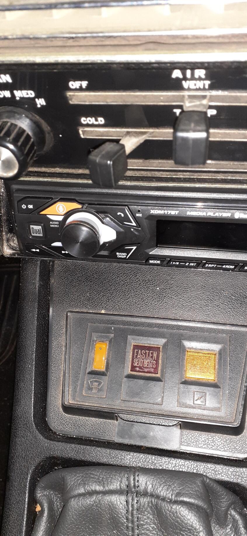

I'm trying to repair my elctrical seatbelt warning, get it working again. Wonder if there are some documentations on that here among the members who would share it with meπŸ™‚

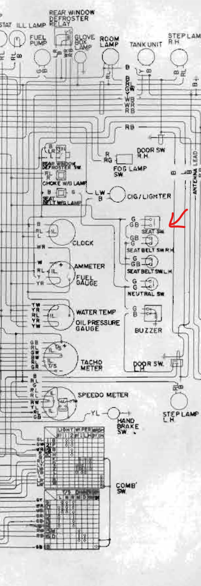

Is it a European model? It might be the same as the US model. Your earlier post asking for the light bulbs for that and the hazard switch led me to believe you had a 74 or later, so I gave you the wrong answer for that post.
If you haven't already done so, you can download an English language version of the factory service manual from the downloads section of this website. There is a link in my signature.
The circuit comes off the fusebox and goes to the dash harness as a green wire. The green wire goes to the body harness. It branches off in two directions. One goes to the weight switch under the passenger side seat. The other branch is a green/black wire going to the driver side seat belt latch. From the weight switch the wire comes out as green/black and goes to the passenger side seat belt latch. From the latch, it comes out as a green wire. From the driver side seat belt latch the wire comes out green and joins with the wire from the passenger side latch. That green wire goes to the transmission neutral switch and comes out green. That wire branches off to the seat belt warning light and the buzzer. I believe the buzzer is only grounded when the driver door is open.

I think you have a 1973 car but a 1974 or later 260z console in it.. A 1969-1973 240z never had a seatbelt warning in it as far i know (Just looked in my 1971 240z serv.man. and it has none in it.. also no choke warninglight.. what i also see on the schematic above in steve's pic.)
Then obviously you don't know correctly. The seat belt warning light and choke warning light are on the fuse box cover for the 72 and 73. Both lights are also shown in the snippet of the wiring diagram I included.
As for the bulbs, I double checked the choke warning and seat belt warning lights. They are indeed BA7 bulbs.Β
