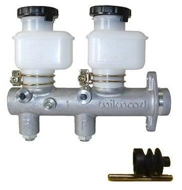

This is the image of the M/C sold on ZcarDepot . I contacted wilwood technical support to see what they have to say about master cylinders and disc/drum brakes.  His response was absolutely, f/r makes a difference.
Page two of the master cylinder data sheet ds439.pdf explains the residual pressure valve and how it's necessary for the rear brakes and not for the front brakes.  I'm sold. I think I'll go with the Wilwood explanation.
ds439.pdfFetching info...

Did you read the wilwood data sheet above? Page 2 is pretty clear. My other z i removed the m/c and turned it around 180 degrees, then I connected the lines and slowly turned it back around and plugged it back into the booster.
Tonight I did the new z a different way. I loosened the m/c and removed both lines and reversed them. I had to spend some time on it getting them bent correctly and it’s a much better fit.

Haha! Yes, of course I did. And I found it completely lacking any explanatory detail whatsoever. In that data sheet there was one statement of fact with absolutely no explanation as to the WHY the situation exists. It said "This master cylinder contains internal residual pressure valves for drum brake use only which should be removed and not used in disc brake applications."
Well that's great, but so what? So Wilwood puts a valve into their aftermarket master cylinder. Got it.
But I want way more than that so I dug around to figure out the theory as to the WHY and I found (what I consider the best, most well explained and credible) info at that link I pasted above.
I'm just trying to provide some clarity as to the WHY they are in there because I believe understanding the issue might be the first step in coming up with alternatives.
So with that in mind... How about swapping the check valves between F and R instead of the hard lines? Wouldn't that fix any potential issues for the people who want a different solution other than bending the hard lines?   :geek:
Thanks for posting the jalopyjournal page, that was a good read.  I didn't actually absorb the whole of the page two of the Wilwood pdf.  It was kind of contradictory, with saying only use it for drums, remove it for discs, then put it back in for discs if the MC is lower than the discs.  ???
The jalopyjournal discussion is a lot like this one, with many different views, not all of which seem based in actual knowledge.  It does seem to show though that there is a reason for an R and an F, and they do differ due to pressure reasons.  So hydraulics do come in to play.  Seems like it would only be for pedal feel though.  Maybe balancing the contact times between shoes and pads, and/or reducing the pedal travel.
So F and R do matter, for reasons not clear, therefore, also, importance is not clear.  But, since it is a hydraulic matter, if releasing the pressure at the cylinder of the sticking wheel doesn't unstick the shoes in the single drum, then F and R is not the cause of the sticking.
