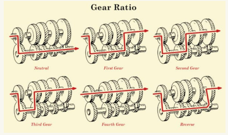

January 28, 20223 yr Author comment_634982 20 minutes ago, Zed Head said: I fumbled around with some ratio calculations and your gear teeth numbers come up more like a very close ratio competition transmission. Not a 3.321 first gear. Fourth is always 1:1 on the Nissan transmissions I believe. Tried to find a calculator to make it easy but had to go back to basic math. One hard part of understanding the calculations is realizing that "4th gear" is not really a gear ratio. It's direct drive through the shaft. And, the gears that are called fourth gear are really just the gears that start the power flow through the gear set. They're not really 4th, more like zero. They are part of the ratio calculation for every "gear" that transmits power through the countershaft. Found some illustrations. https://www.artofmanliness.com/skills/manly-know-how/gearhead-101-understanding-manual-transmission/ You can see in my post above that 4 of the 6 comp transmissions actually have 5th as the 1:1. The rebuilder told me 5th was an overdrive gear so I assumed it was one of the top two. However, if 5th was 1:1 and I do have a 3.54 rear end, that would add up to me seeing 4K at 80mph which is what I see currently. I just couldn't get the other ratios to line up to any of those options. Maybe I need to put the back end up in the air, put in 5th and see if the driveshaft rotates exactly once with the engine being turned over once or if it goes a bit further which would indicate an overdrive. I played with this calculator a bit... http://www.vmar.com/java/gear.html Also, my 1st and 2nd gear are both really short and then 3rd seems tall by comparison...another reason the wide ratio seemed to make sense. The other one with a bit more of a gap from 2nd to 3rd is the last comp trans on the list. Edited January 28, 20223 yr by blodi Link to comment https://www.classiczcars.com/forums/topic/66294-drivetrain-upgrade-clutch-trans-lsd-etc/#findComment-634982 Share on other sites More sharing options...
