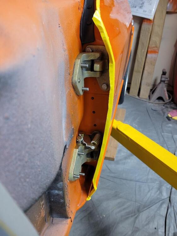

Posted January 31, 20223 yr comment_635151 We have a 1973 240z. Both Doors have these holes. Does anyone know what they are for? Would appreciate any insight you can offer regarding the three holes between the door hinges. Thanks in advance for your help. Link to comment https://www.classiczcars.com/forums/topic/66303-door-holes/ Share on other sites More sharing options...
January 31, 20223 yr Popular Post comment_635159 You’re missing the internal safety bar that is normally inside that door. It is attached with three bolts through those holes on this end. Edited January 31, 20223 yr by zKars Link to comment https://www.classiczcars.com/forums/topic/66303-door-holes/#findComment-635159 Share on other sites More sharing options...

January 31, 20223 yr comment_635171 Here's what it looks like with the bolts in place. I wasn't looking for what it might be connected to, but I'm guessing that @zKars is on the mark. Link to comment https://www.classiczcars.com/forums/topic/66303-door-holes/#findComment-635171 Share on other sites More sharing options...
January 31, 20223 yr comment_635173 45 minutes ago, siteunseen said: I looked at my '72 but saw nothing. I guess it's a '73 thing? The bumper mounts got bigger, the doors got bigger intrusion bars, the hazard switch and HCP’s grew illumination, the gathering storm of safety and emissions requirements was just gathering steam. Link to comment https://www.classiczcars.com/forums/topic/66303-door-holes/#findComment-635173 Share on other sites More sharing options...
February 1, 20223 yr Author comment_635179 Zkars – you have always been helpful in the past – thanks again. SteveJ thanks for the image. I am a little slow so bear with me. If SteveJ’s image is accurate then whatever those three bolts should be holding in place would need to be between the bolt head and the door. I looked at the interior of the door. All I can feel is welded captive nuts. On the other hand, if the bar was internal to the door, then wouldn’t they have put the welded nuts on the exterior of the door and install the bolt from inside the door. I am just guessing so I reserve the right to be wrong. I’ve looked in the manuals that I have and can’t find anything. Is there someplace that you can direct me to for more information? Has anyone seen this part? I know it is a lot of trouble, but can anyone post an image of a safety bar? –Thanks in advance. Is it possible that this was cut-in to production after our car was manufactured? My last thought has to do with a TV show – “Cheers”. The episode had to do with a prank that they pulled on the Doc. (Frasier Crane) – they took him “SNIPE” hunting – a practical joke or fool’s errand. No offense intended, but Jim are you taking me snipe hunting? Appreciate the help. Regards, ron Link to comment https://www.classiczcars.com/forums/topic/66303-door-holes/#findComment-635179 Share on other sites More sharing options...

February 1, 20223 yr comment_635215 I needed a break from work today, so I went down to the garage. (I do enjoy work-from-home.) I don't know if these photos will help much. It was a challenge getting the camera inside the door. Inside leading edge of the door - you can see the lower two bolts. Lower edge of what I assume is the reinforcement panel Near the door latch It only took a couple of minutes to remove the door card, and no door cards were harmed in the process of getting these photos. Link to comment https://www.classiczcars.com/forums/topic/66303-door-holes/#findComment-635215 Share on other sites More sharing options...
