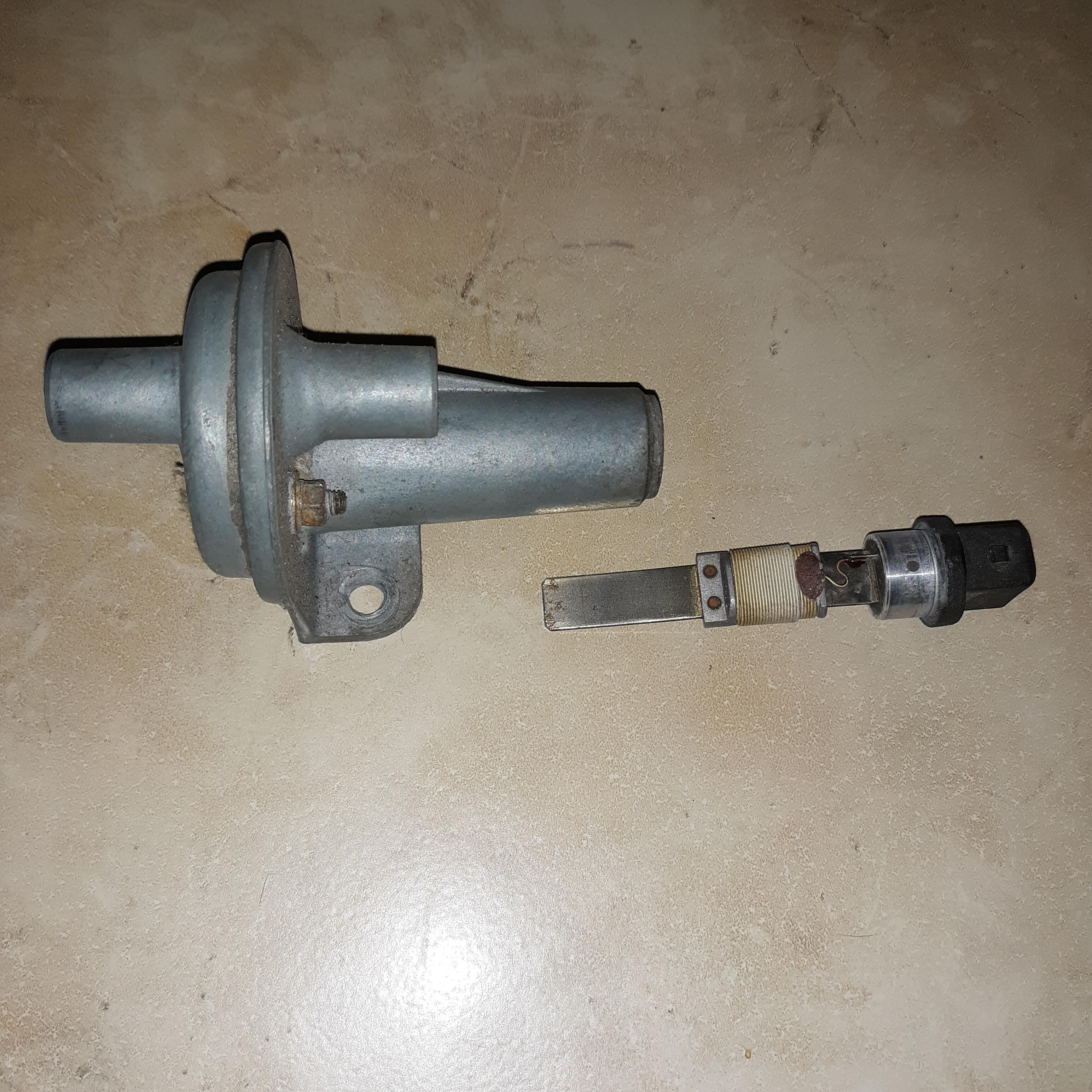

My original AAR had the electrical coil windings break loose. The part that has the electrical connector would slide out if I remember right. I found a good one at an old junkyard locally. I've read where people put them in boiling water to see if they close but I don't think that's good since there are electric windings. Maybe a hot hair dryer or a heat gun would let you test it?
I could have glued the innards back in I guess but found the better one.
I tested a second used AAR i bought of ebay which is also about 1/4-1/3 open etc. The car had same issue. Once it warms up the engine is more smooth on idle as well. Once it warmed up in 10 mins i took the AAR out and inspected and it was fully closed. After 15-30 mins at room temp it does opened up 1/4-1/3.
Initially i thought the car was too rich due to AAR closed and hence the bypass. Now with the AAR as well it has same issues.

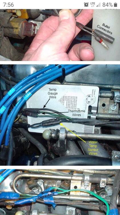

17 minutes ago, siteunseen said:
Have you cleaned all the brass sensors in the thermostat housing? That helped mine.
Where are those brass connectors? do I have to drain the coolant and open the thermostat housing to clean it? what will that effect?
Post #2 shows them. They get corroded over time and loose their sensitivity. You can remove them and sand them down until shiny, steel wool works best.
