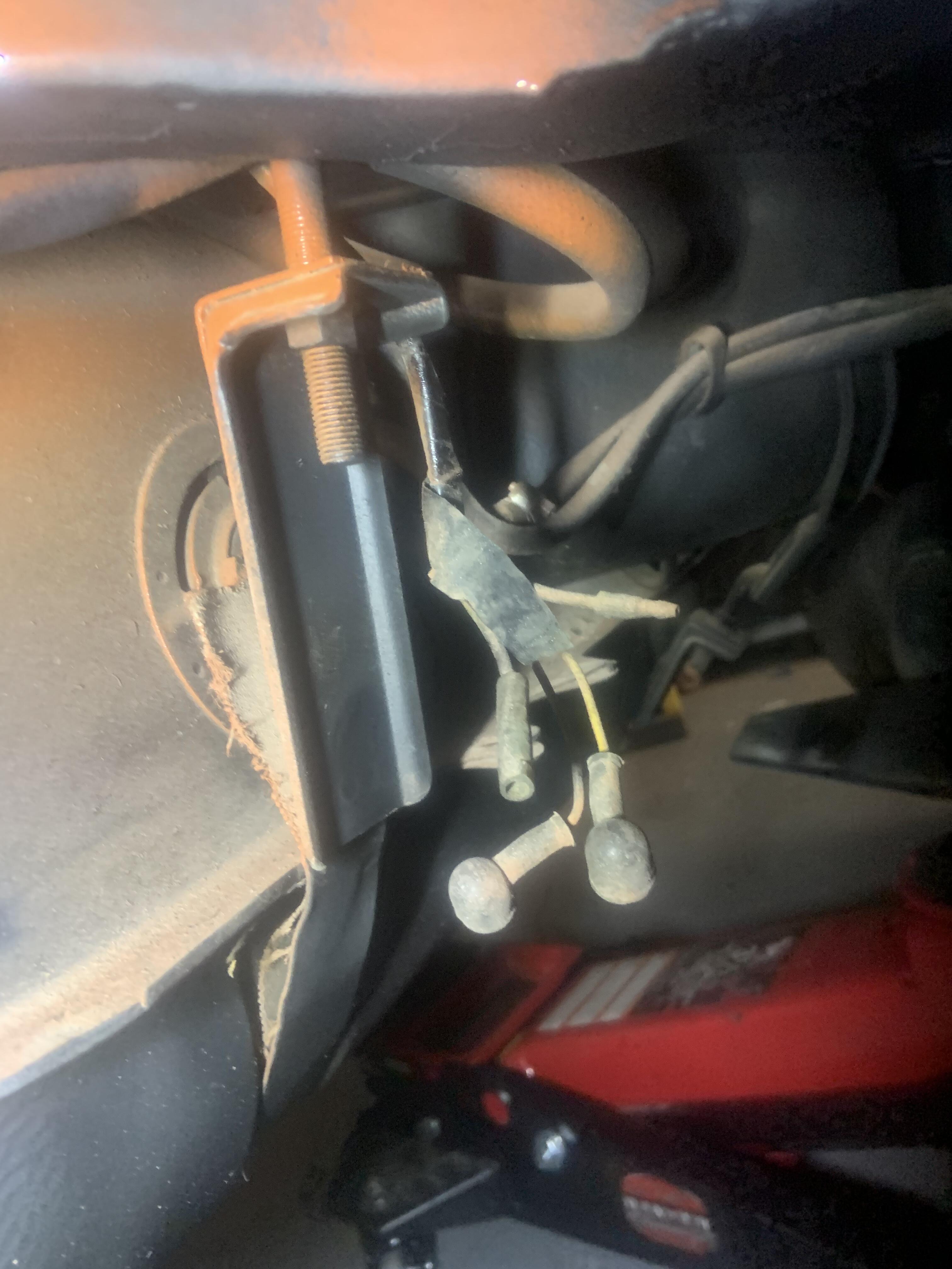

Posted February 8, 20223 yr comment_635583 Can someone tell me what this wire set is for or goes to? That will give me a place to start research how to connect them up. Thanks Link to comment https://www.classiczcars.com/forums/topic/66327-wires-near-front-gas-tabk/ Share on other sites More sharing options...
February 8, 20223 yr comment_635584 Looks like fuel sender connections. Edited February 8, 20223 yr by siteunseen Link to comment https://www.classiczcars.com/forums/topic/66327-wires-near-front-gas-tabk/#findComment-635584 Share on other sites More sharing options...
February 8, 20223 yr comment_635585 Yellow with the cap - Fuel sending unit signal. Black with the cap - Fuel sending unit ground. It's easy to tell which is which. The other two wires are for an electric fuel pump (unused. Link to comment https://www.classiczcars.com/forums/topic/66327-wires-near-front-gas-tabk/#findComment-635585 Share on other sites More sharing options...
February 8, 20223 yr Author comment_635590 thanks. It appears both caps are unusable they wont fit and stay in place. Thus i guess they came off. I can replace those easy enough. I have the tank virtually empty, maybe 1/4 gallon or less in it. Is this an item recommended to replace when you are refreshing a datsun or move of a leave it alone unless its broke? Link to comment https://www.classiczcars.com/forums/topic/66327-wires-near-front-gas-tabk/#findComment-635590 Share on other sites More sharing options...
February 8, 20223 yr comment_635592 The caps only hold on the wires to a limited extent. If the connectors are bent, they won't hold well, either. I think Eastern Beaver had the caps. Maybe someone can recall them being sold by a business in the USA. If the vent hoses are rotting and you try to fill the tank, it will start spewing like a frat boy on his 25th beer. Do your research. Most of the vent hoses are NLA. You'll need to find fuel compatible hoses of the correct size. Do NOT use heater hose for the vent lines. You can get an idea of the routing of the vent lines from the FSM. Link to comment https://www.classiczcars.com/forums/topic/66327-wires-near-front-gas-tabk/#findComment-635592 Share on other sites More sharing options...

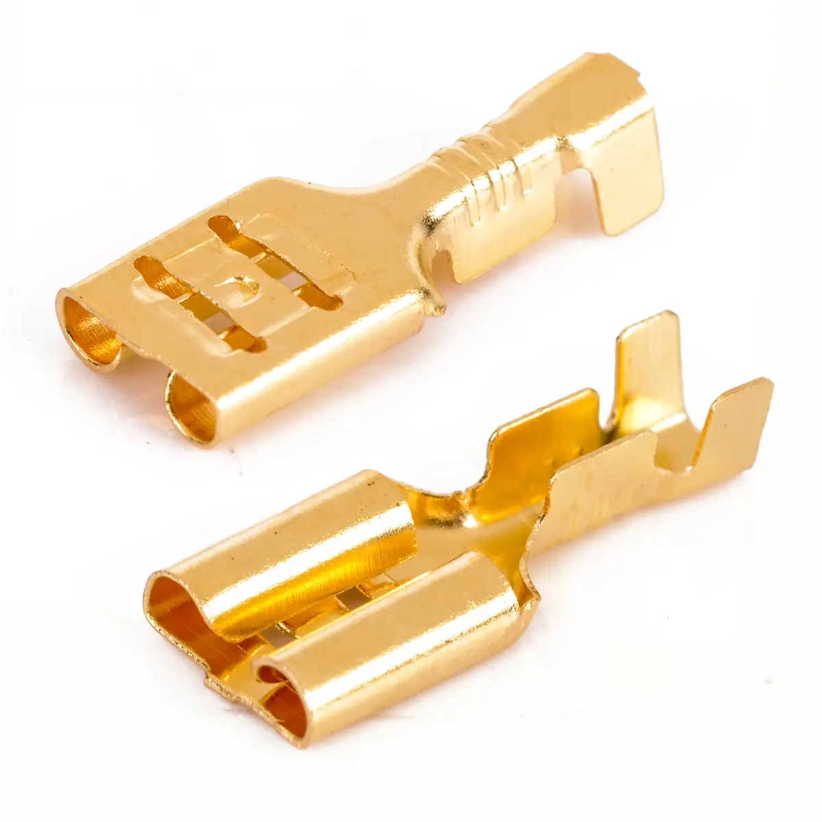

February 8, 20223 yr comment_635596 Not stock, but I think the size is right if you need new boots for the sender:Â https://www.amazon.com/Fastronix-Small-Terminal-Covers-Black/dp/B01LM2BW6A Link to comment https://www.classiczcars.com/forums/topic/66327-wires-near-front-gas-tabk/#findComment-635596 Share on other sites More sharing options...
February 8, 20223 yr comment_635598 I used these on my 240. Then covered with liquid electrical tape. Turned out good, water proof too. Slides on the "nail head" terminals. Edited February 8, 20223 yr by siteunseen Link to comment https://www.classiczcars.com/forums/topic/66327-wires-near-front-gas-tabk/#findComment-635598 Share on other sites More sharing options...
February 8, 20223 yr comment_635599 https://www.240zrubberparts.com/apps/webstore/products/show/5644516 Link to comment https://www.classiczcars.com/forums/topic/66327-wires-near-front-gas-tabk/#findComment-635599 Share on other sites More sharing options...
