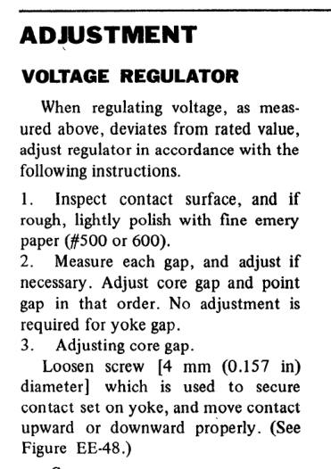

February 9, 20223 yr comment_635644 By the way, if you do happen to have a stock VR, they are adjustable. The cover should be screwed on. A solid state VR probably won't have screws on the cover. You can download a copy of the factory service manual from this website. The VR section starts on EE-18 (195 of the 681 page PDF). If you or a friend know how to use a multimeter, there are some good diagnostics there. It's usually cheaper to diagnose than to fire the parts cannon randomly. Link to comment https://www.classiczcars.com/forums/topic/66336-voltage-meter-spikes-intermittently/#findComment-635644 Share on other sites More sharing options...
February 9, 20223 yr comment_635645 I don't think he can adjust away a spike on the meter. But maybe the mechanical points can be cleaned up. Should be fun, usually they just crap out completely. Worth a shot. Link to comment https://www.classiczcars.com/forums/topic/66336-voltage-meter-spikes-intermittently/#findComment-635645 Share on other sites More sharing options...

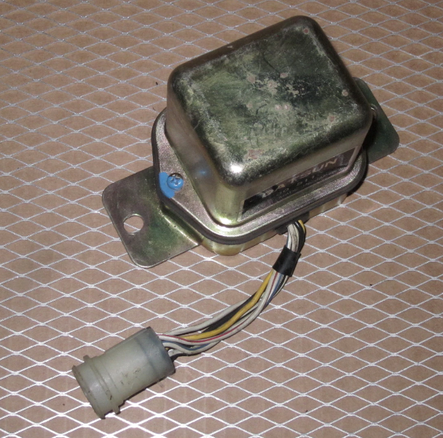

February 10, 20223 yr comment_635649 20 minutes ago, 77Z said: Thanks guys. Its stock and the original VR. How can I confirm internal or external? I've followed the harness from the alternator through the harness apparently to the area under the fusible links and the large black plate where they mount. Is the VR under this plate? I've got the service manual and section EE18 and reading that I see the adjustment. But, usually, it reads spot on 12.8vdc. So, maybe its ready to crap out and spiking to the pin is its failure mode. I have a large audio load wired directly to the battery and fused properly but its been flawless for several years. Looking at parts I see alternators go from 75 to 2/77. Mine's a 3/77. Perhaps I have the first month of an internal VR in which case I just need a new alternator. No you should have the externally regulated 60A alternator, 23100-N3303, in your car. The round plug in your last photo is the VR. Your ground wire at the alternator is looking a little green. You might want to find some Caig Deoxit and spray it down good. Heck it wouldn't hurt to do that on the connector for the VR and the T connector at the alternator, too. Link to comment https://www.classiczcars.com/forums/topic/66336-voltage-meter-spikes-intermittently/#findComment-635649 Share on other sites More sharing options...
February 10, 20223 yr comment_635650 27 minutes ago, 77Z said: Is the VR under this plate? Yes, There are two round plugs but I think SteveJ means the big one. You can see the fastening screw on the bracket in your picture. Can't remember but I think that the big plate is removable, exposing all of the goodies underneath. Link to comment https://www.classiczcars.com/forums/topic/66336-voltage-meter-spikes-intermittently/#findComment-635650 Share on other sites More sharing options...
February 10, 20223 yr Author comment_635668 Viola! Its a VR hiding under the plate. Never had cause to be there except for re-terminating the vacuum hoses when the heater doesn't work (pro tip). But, its a 23500-B8000, not a 23100-N3303. I see a couple of sources for a new VR out there. Anything I should look (watch out) for? Thanks! Link to comment https://www.classiczcars.com/forums/topic/66336-voltage-meter-spikes-intermittently/#findComment-635668 Share on other sites More sharing options...

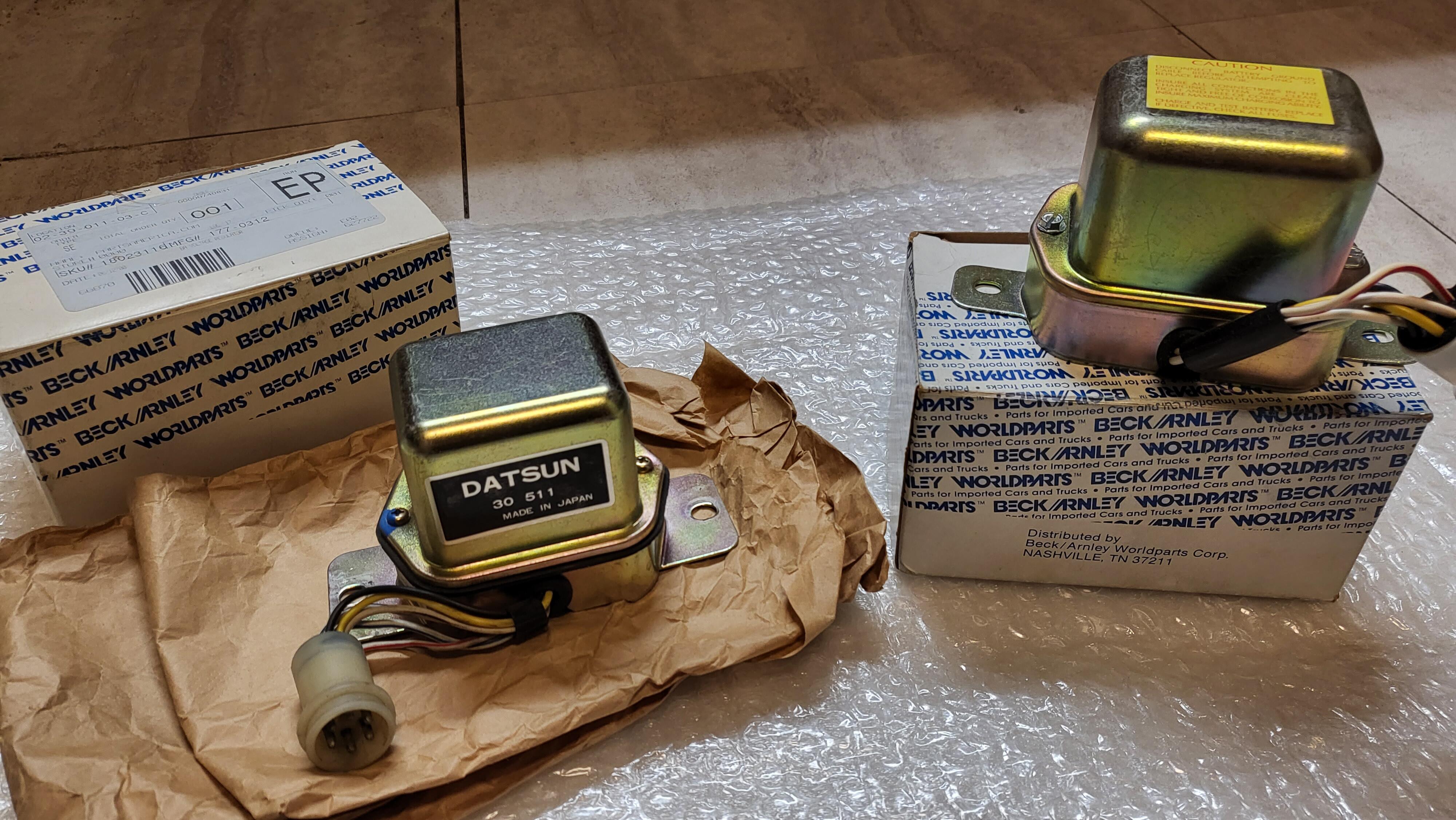

February 11, 20223 yr comment_635669 I have 2 new, never used ones available. The one on the right if I remember, came from ZcarDepot : $45 plus shipping The one on the left nos : $60 plus shipping (only because it says Datsun on it ... lol) Link to comment https://www.classiczcars.com/forums/topic/66336-voltage-meter-spikes-intermittently/#findComment-635669 Share on other sites More sharing options...
