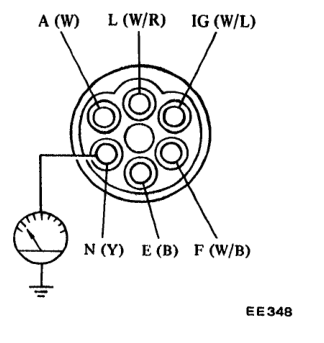

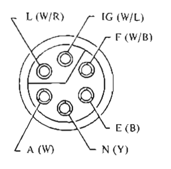

1974
1977
You can tell its the correct regulator for the 77 280 by the round plug with the recessed male pins.   The 240 is a rectangular connector and the 260 is a different round connector with external pins.
Possibly a change was made to the harness wiring pins when the solid state regulator was installed.
