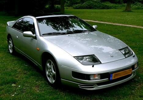

I've got a 240z and a 300zxtt, the 240z is my wintercar.. looks like a pile of $^!#..haha but it's a ever lasting reliable car! And the 300zxtt is my summercar for 15 years and  was never on the road in winter!  It's almost like new, all winter "schorsingen" are with the car at the RDW!!
Picture from the PO..
