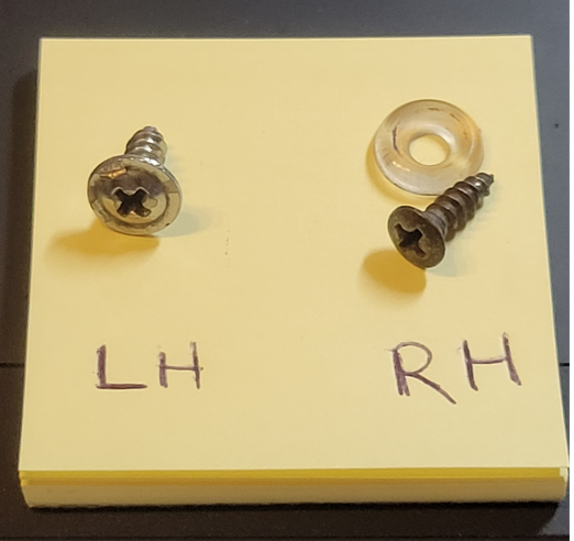

Posted February 12, 20223 yr comment_635791 can anyone confirm the type of screw used in the middle of the piller trim? I think i see a screw and washer (machine screw) but mine is missing so now sure. its the only place that has a small hole on the trim piece the rest uses the rivnuts (plastic). Link to comment https://www.classiczcars.com/forums/topic/66347-quarter-glass-trim-panel-screw/ Share on other sites More sharing options...

February 13, 20223 yr comment_635804 Dave, I have a 1971 series 1 car, so not sure if what I have would be the same for your 280z. the original trim screw for my car is a black oxide, self tapping, oval head Philips screw. The finish washer is a clear plastic rounded, or dished washer. The screw measures approx 9mm of thread length with a total length of approx 13mm. See photos below. Hope this is what you are looking for. Link to comment https://www.classiczcars.com/forums/topic/66347-quarter-glass-trim-panel-screw/#findComment-635804 Share on other sites More sharing options...
February 13, 20223 yr Author comment_635812 thanks! I presume the . is the same. I looked at car parts manual online and I could not see it. will try a 240z there as well Link to comment https://www.classiczcars.com/forums/topic/66347-quarter-glass-trim-panel-screw/#findComment-635812 Share on other sites More sharing options...
February 13, 20223 yr comment_635815 10 hours ago, AZ-240z said: Dave, I have a 1971 series 1 car, so not sure if what I have would be the same for your 280z. the original trim screw for my car is a black oxide, self tapping, oval head Philips screw. The finish washer is a clear plastic rounded, or dished washer. The screw measures approx 9mm of thread length with a total length of approx 13mm. See photos below. Hope this is what you are looking for. Thanks for posting this, my 1970 has the exact same screw and washer on the right side, but it has a self tapping screw on the left side that has an integral washer. Now I know which is correct. Strange that this screw and washer is not documented in the parts book. Link to comment https://www.classiczcars.com/forums/topic/66347-quarter-glass-trim-panel-screw/#findComment-635815 Share on other sites More sharing options...
