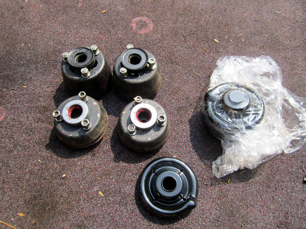

February 20, 20223 yr comment_636147 One more idea. Kinda far fetched, but since we're throwing stuff out there... There is supposed to be a spacer between the upper spring perch and the rubber insulator mount. On the front they use a bearing there so the front strut can spin when you turn the steering wheel. On the rear (since the rear doesn't have to spin) they use a hard plastic spacer instead. I only bring this up because I don't see the spacer in your pics. Maybe it's stuck inside the rubber mount, or maybe someone lost it along the way? Here's a pic of the upper insulator mounts and their respective bearings/spacers. Rear pair on top and front pair on bottom: Good luck with the continued hunt for the noise. Link to comment https://www.classiczcars.com/forums/topic/66360-260z-rear-suspension-banging/?&page=2#findComment-636147 Share on other sites More sharing options...
February 20, 20223 yr comment_636148 Nevermind... I think I see your plastic spacer stuck inside the rubber insulator mount: Link to comment https://www.classiczcars.com/forums/topic/66360-260z-rear-suspension-banging/?&page=2#findComment-636148 Share on other sites More sharing options...
