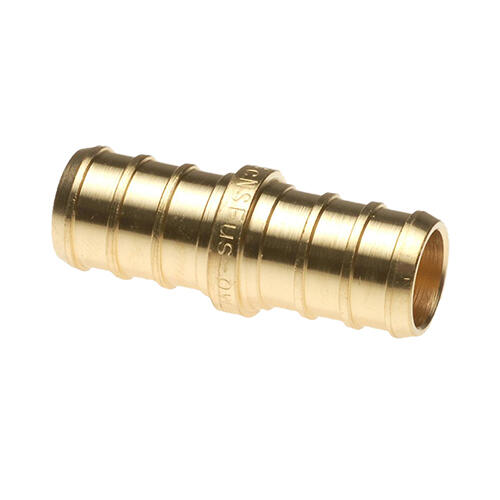

You can buy a 3/4" PEX coupling for a splice. Only a dollar at any hardware store. Use worm gear clamps or zip-ties to hold it tight.
