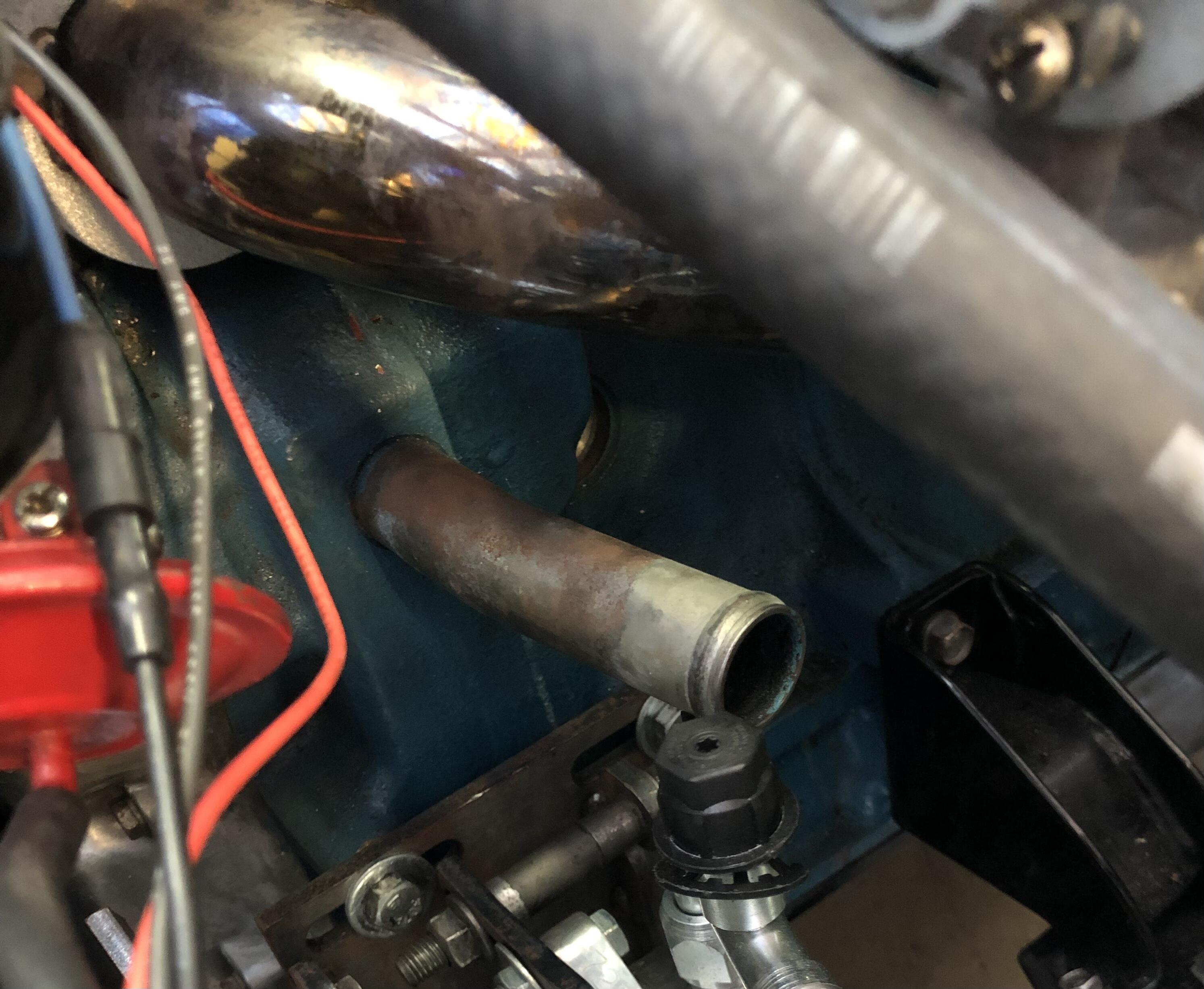

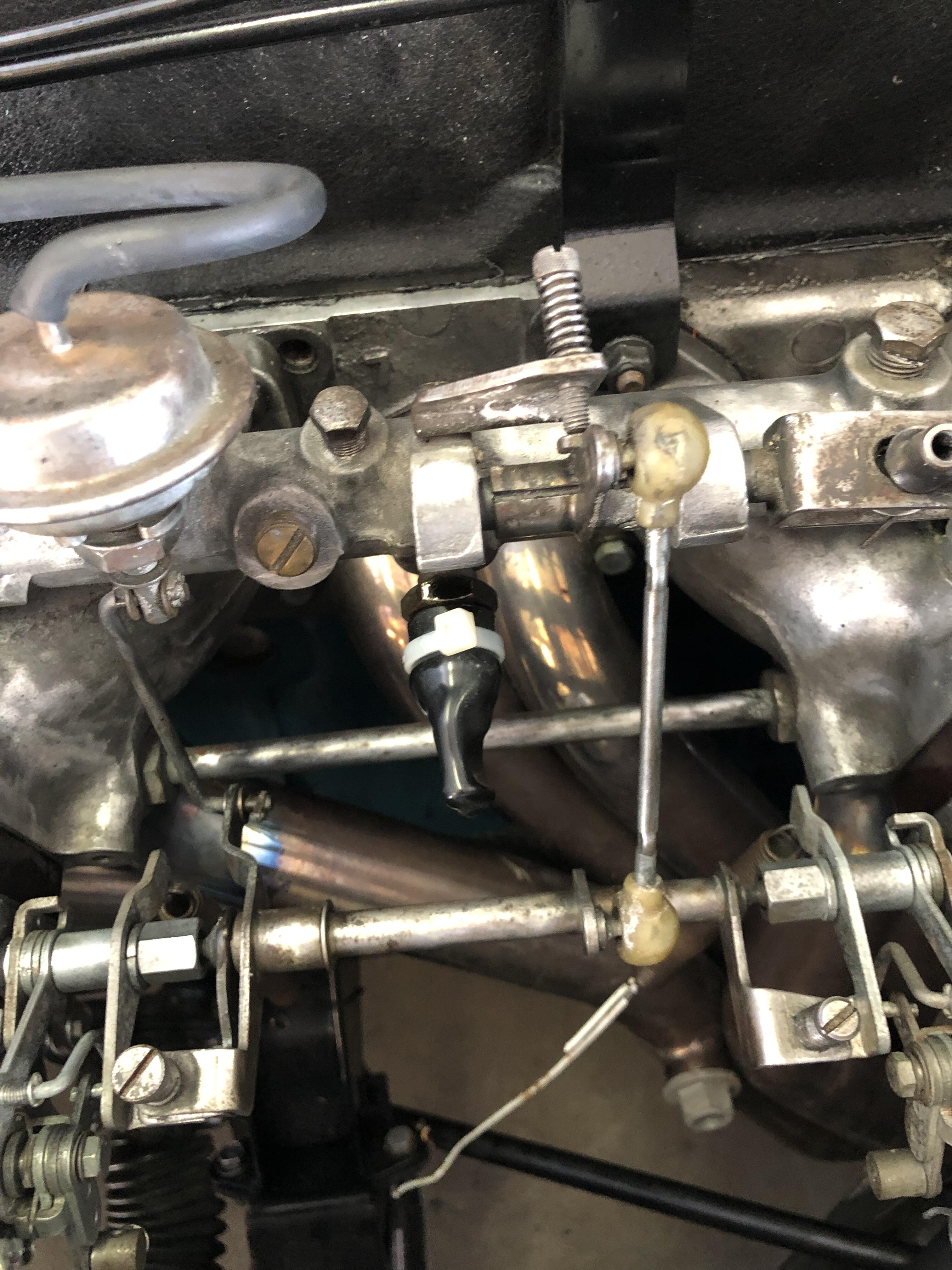

It is for positive crankcase ventilation. There should be a hose going from that to the PCV valve at the balance tube.
They are parts 3 & 5 on this page: https://www.carpartsmanual.com/datsun/Z-1969-1978/engine-240z-260z/emission-control-device.
Hose: https://www.thezstore.com/page/TZS/PROD/15-6211
Valve: https://www.rockauto.com/en/catalog/nissan,1972,240z,2.4l+l6,1209169,exhaust+&+emission,positive+crankcase+ventilation+(pcv)+valve,5052
If you plug the PCV, you risk pressurizing your block and finding out how weak your oil seals are.
