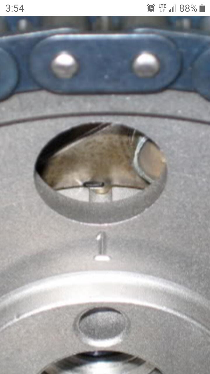

It says in the fsm that there are 42 "links" between marks. I have 20 "links" = 40 pins plus one on either link to the sprocket marks = 42. Is that the right was to look at it? mine were also in hole #1. I am replacing with new parts.
The shiny links will be on the same dot or number corresponding with the cam spocket and crank. Don't forget your oil slinger when you go to putting it back together.
