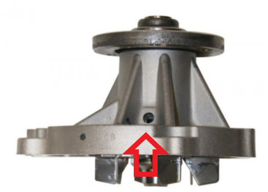

March 14, 20222 yr comment_637206 Check the weep hole. Link to comment https://www.classiczcars.com/forums/topic/66449-water-pump/#findComment-637206 Share on other sites More sharing options...

March 14, 20222 yr comment_637210 Coolant. If the seal goes bad, it weeps out the weep hole. Link to comment https://www.classiczcars.com/forums/topic/66449-water-pump/#findComment-637210 Share on other sites More sharing options...
March 14, 20222 yr comment_637212 Grab your fan blade and wiggle it front to back. If there is any movement at all, the water pump is bad and needs to be replaced. Link to comment https://www.classiczcars.com/forums/topic/66449-water-pump/#findComment-637212 Share on other sites More sharing options...
