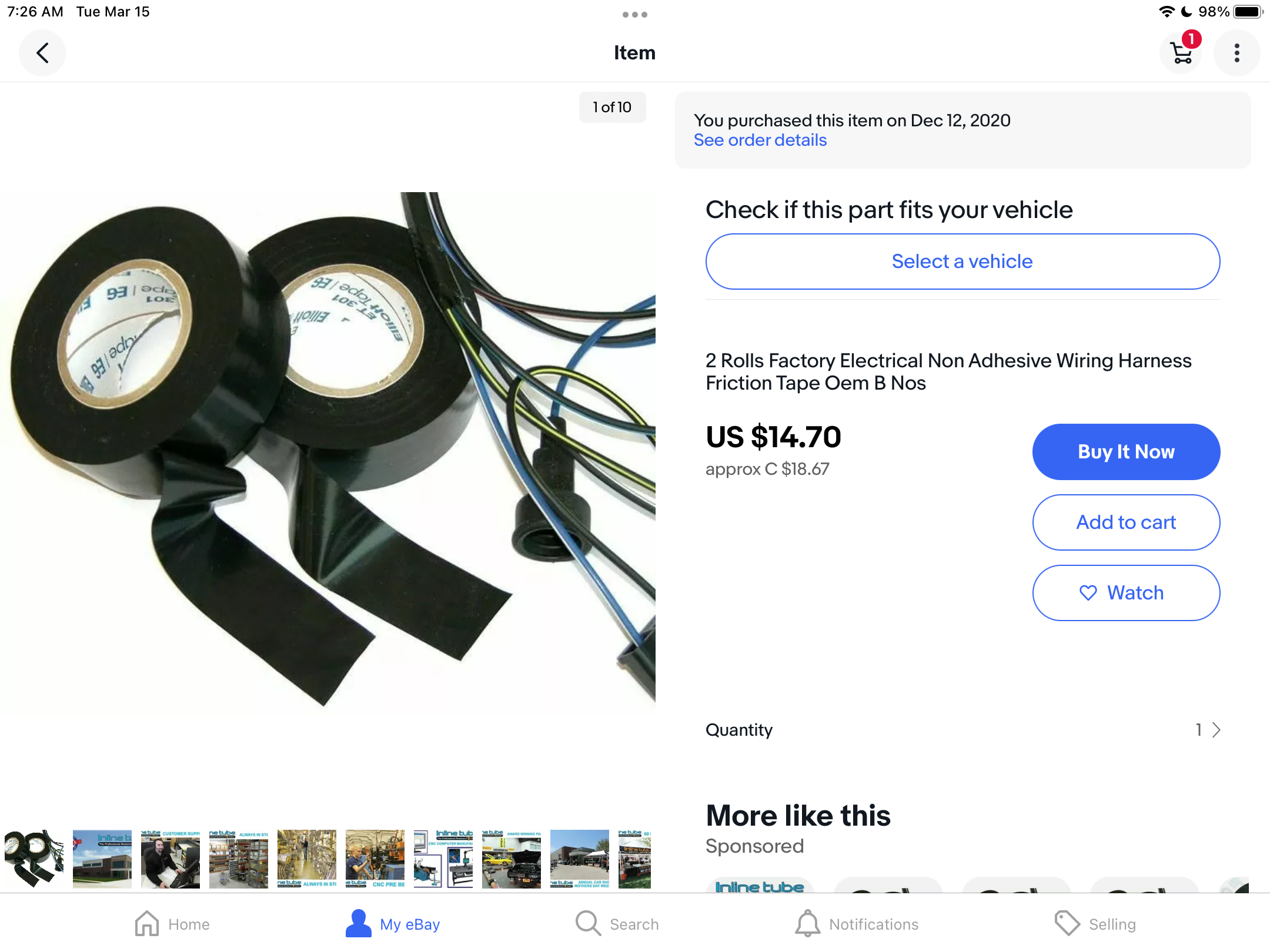

My favorite stuff is this.
https://www.ebay.ca/itm/190823047174
It looks and feels like the stock harness tape. No sticky adhesive on the back.
Edited by zKars

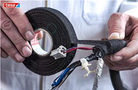

I don't know if this is considered cloth tape, it's more fuzzy than that, anyway I've been using it a lot to wrap harnesses.
Screenshot 2022-03-15 at 16-36-00 Boxiti Tesa 51608 Black Fuzzy Fleece Interior Wire Loom Harness Tape 19 mm X 15 Meters. (5 pcs) Amazon.ca Tools & Home Improvement.png
