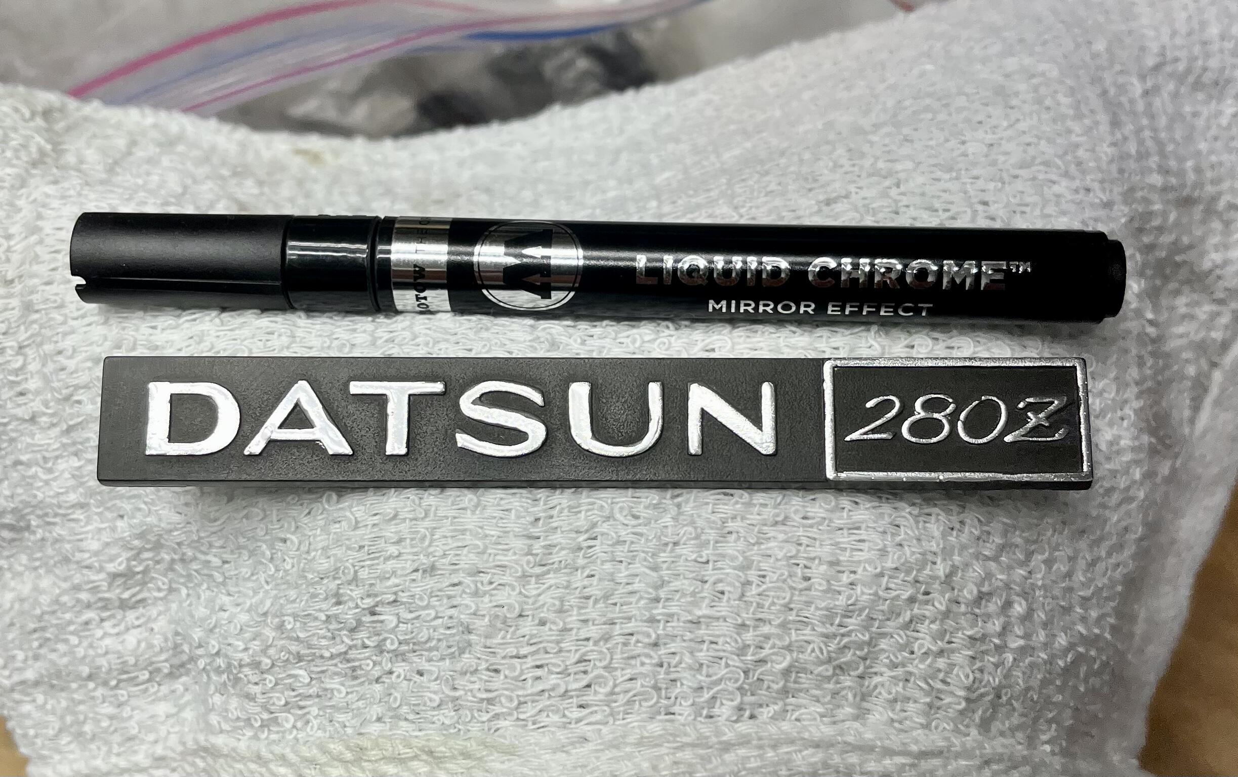

May 14, 20222 yr Author comment_640384 I forgot to post this dashboard emblem restoration I did with a “liquid chrome” pen I bought on Amazon. This dash emblem was totally black before I did this. Took all of 5 mins to complete. I should have taken a before pic. Here what it looks like now. Link to comment https://www.classiczcars.com/forums/topic/66453-77-280z-restoration/?&page=11#findComment-640384 Share on other sites More sharing options...
May 14, 20222 yr comment_640388 That looks as good as everything else you've done Ferg! My Man @psdenno turned me on to these when I was doing my OE radio and the console in the 240. They work great too. Sharpie silver oil based from Hobby Lobby. Link to comment https://www.classiczcars.com/forums/topic/66453-77-280z-restoration/?&page=11#findComment-640388 Share on other sites More sharing options...

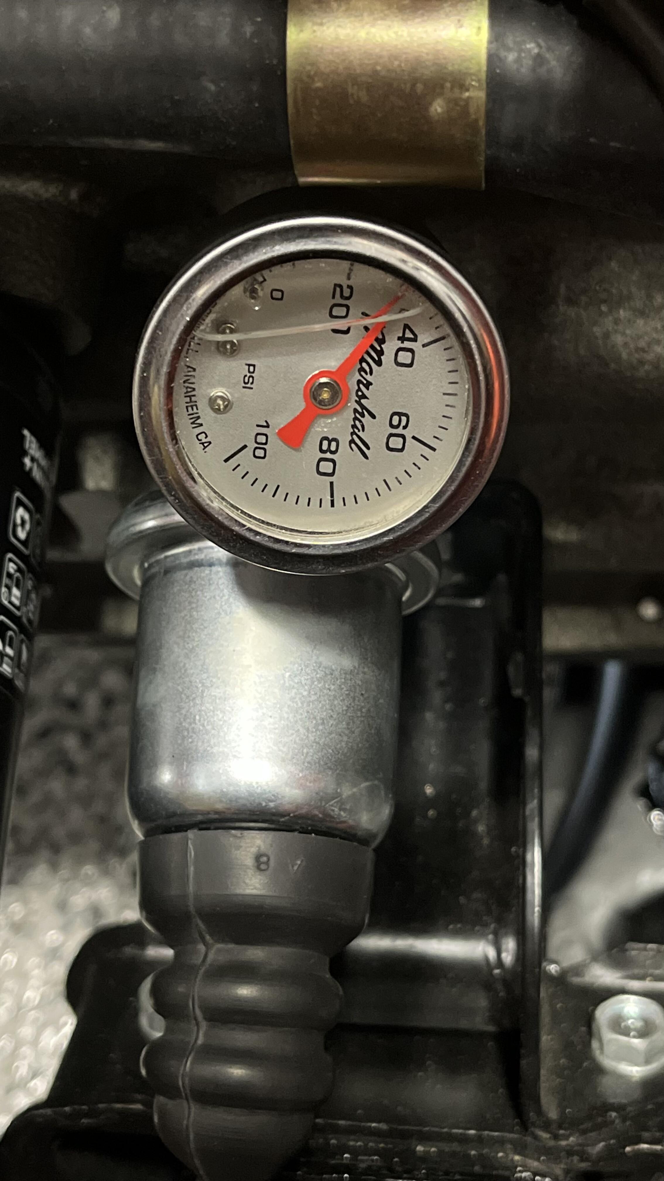

June 11, 20222 yr Author comment_641439 In a previous post I mentioned I was concerned with low oil pressure. Even after buying a new sender it was still reading low. I took advice from a few of you and installed a gauge off the block to check my readings. First, the gauge and the adaptor recommended worked perfect. On start up the block gauge show 50 psi (cold engine, cold oil). At operating temp it was stable at 30 psi. Revving it goes up linearly with RPM. Saw as high at 65-70 psi. I’ve been working like a dog recently, operation baby formula has eating up plane cargo capacity so they’re not letting people drop trips. Once crisis after another. I haven’t been able to work on the car for a couple weeks now. Soon it’s going to hot and humid as hell out and without my AC up and running it’s going to make engine break in driving a little sweaty and not fun. Texas AC (windows down) doesn’t work enough and make the interior more prone to exhaust fumes too.. IMG_8909.MOV Link to comment https://www.classiczcars.com/forums/topic/66453-77-280z-restoration/?&page=11#findComment-641439 Share on other sites More sharing options...

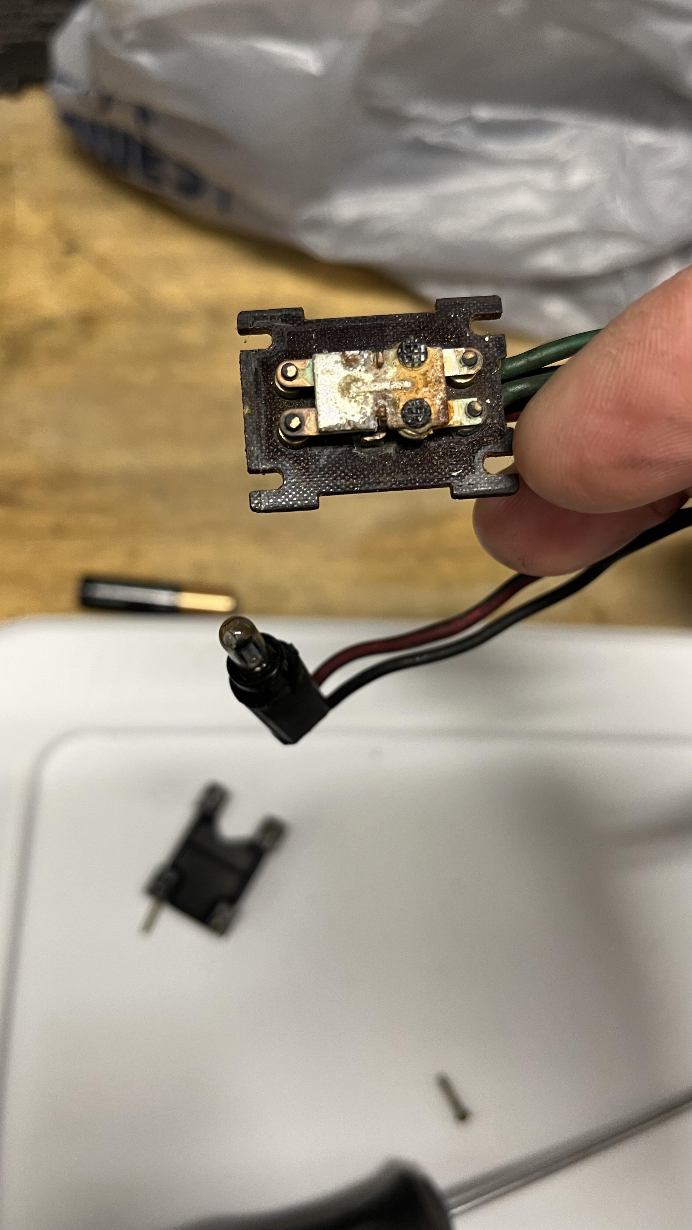

July 19, 20222 yr Author comment_642656 Okay, I’ve been out of pocket for a few weeks. With a combination of work and getting COVID I’ve been MIA on the forum. Covid was a 10 day ordeal, had it last year as well. Was worse this time but was just a really bad cold. The worst part was my wife putting me in double quarantine in my own house. So, I’ve been working a bit on the Z but it’s been minimal. I had been working on a turn signal problem that I’ve mostly resolved. I had 3 problems I found when troubleshooting . 1. Corded contacts inside the combo switch. 2. Bad Flasher. 3. Two front turn bulbs that had burned out filament. So now the turn signals work normally but there are still some problems. One is I cannot hear an clicking when I select a turn in either direction and neither bulbs in the tach work. The bulbs are good, contacts are clean on the receptacles. I had been told that the hazard switch and it’s circuit effects the turn signals. So the Hazards didn’t work either. I discovered I had a bad switch and replaced it with another one I had in my parts bin. Now the Hazard lights only work on the passenger side of the car . I can also hear them clicking but the arrows in the tach gauge do not illuminate So I still don’t know what’ the problem could be. Bulbs are all replaced, including tach bulbs My next plan is to get a new hazard flasher and see if this helps. Does anyone have any idea how I should proceed? Thanks Link to comment https://www.classiczcars.com/forums/topic/66453-77-280z-restoration/?&page=11#findComment-642656 Share on other sites More sharing options...
July 19, 20222 yr comment_642657 LED or incandescent bulbs? Electronic or mechanical flasher relays? I hope someone else can help you with the circuits. I'm busy this week, so I don't have as much time to devote to reading the wiring diagrams. Link to comment https://www.classiczcars.com/forums/topic/66453-77-280z-restoration/?&page=11#findComment-642657 Share on other sites More sharing options...
July 19, 20222 yr Author comment_642665 I have a mixed bag of bulbs. Front turn signals are incandescent, backs are LED. The hazard flasher is OEM. Turn single was on zcardepot for $6.99. Bulbs in tach for turn signal lights are incandescent. Was considering buying an EF-32RL flasher for hazards and for turn signals. No sure is I need you can use the same one in both locations? BTW, here is a pic of the inside of my hazard switch that didn’t work a bit crusty. Link to comment https://www.classiczcars.com/forums/topic/66453-77-280z-restoration/?&page=11#findComment-642665 Share on other sites More sharing options...
