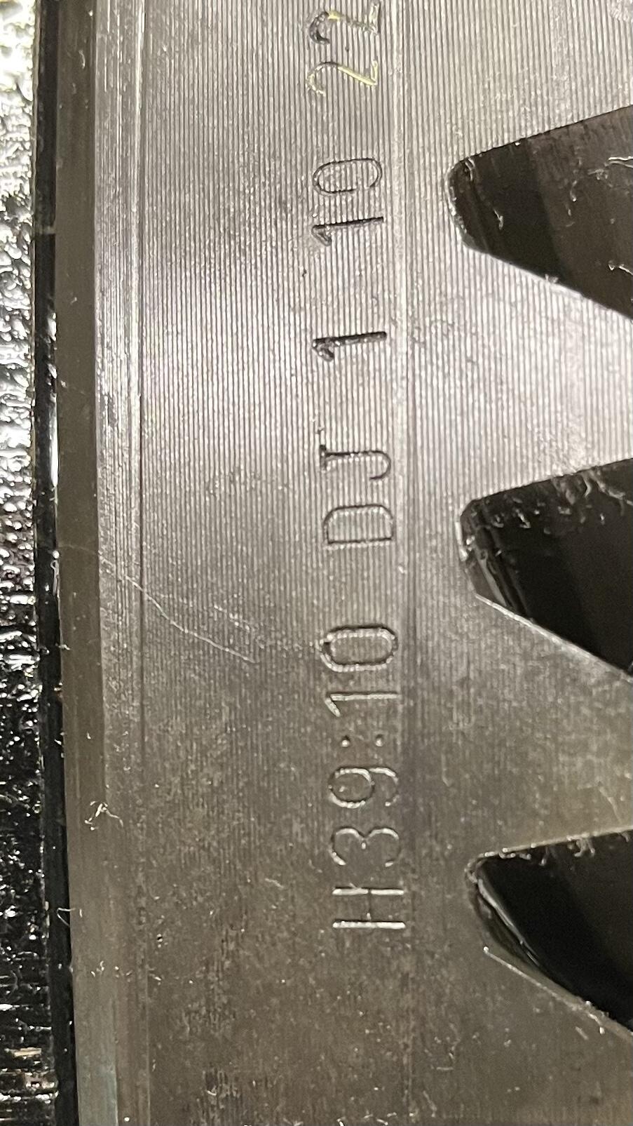

I got a side bar question since the rear end clunking was happening.  I have a extra differential that I bought a couple years ago to get the ZX gearing for the close ratio transmission.   I decided to crack open this diff and look and make sure it’s the proper 3.9 ratio. He’s is a pic of that gear.  Says 39:10

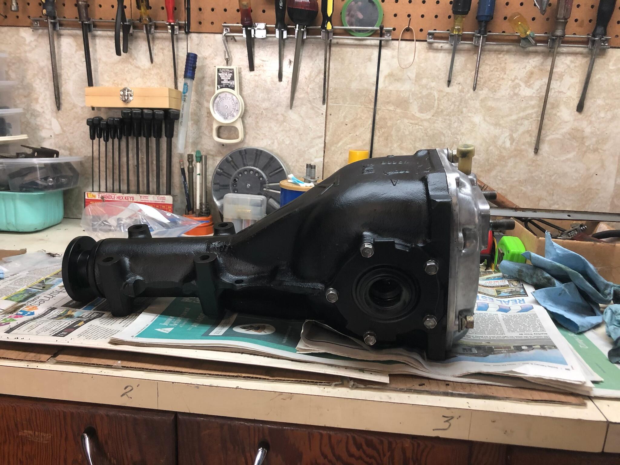

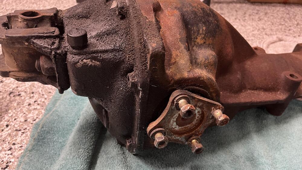

Here’s my question…how do I know this is an R200?   It is possible this is a R180?  I know those were in the automatic ZX’s.  This supposedly came  from  manual.  Other pics I’ve seen of R200 look different.  I seems like some have 5 bolts near where the half shafts mount.   Here are pics of mine and then a pic of Yarbs ZX R200.
This nice clean diiff in the pics is the one Yarb sent me.  Other pics are from mine.  You’ll see his has five 10mm bolts around here half shaft connects.  Mins has none.

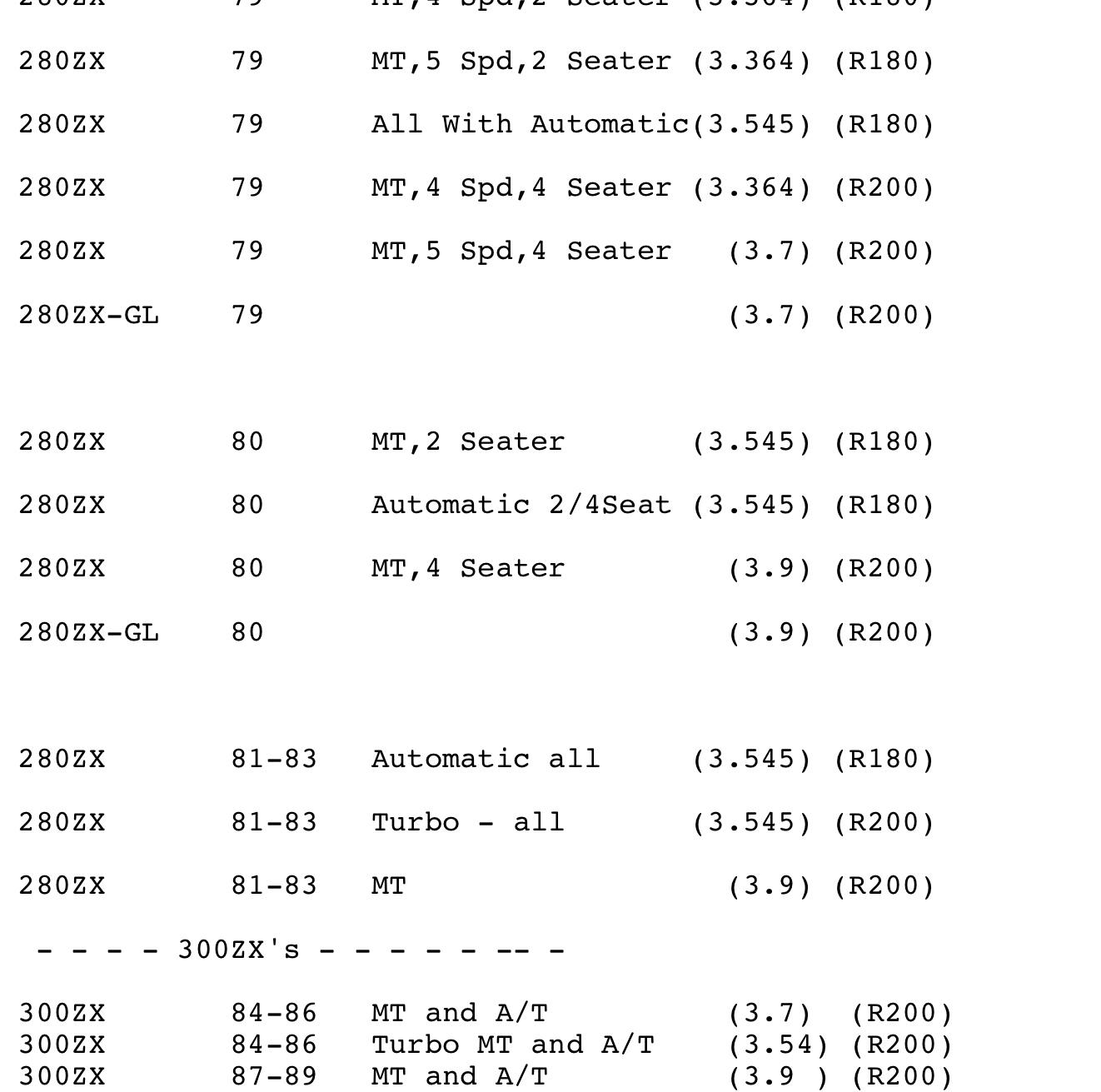

ZHome page shows that they didn’t make a 3.9 in the R180.   So looking a pics online Ii found 3.9 R200’s that looks like mine and others that have the bolts around the where the hang shafts attach.  So did they change the designs in the later years of the ZX?
