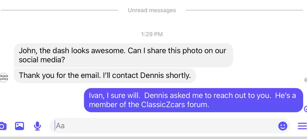

March 21, 20223 yr Author comment_637515 22 hours ago, 280Zrewind said: Av8ferg, Any luck contacting Vintage? If you want feel free to answer me at c310dennis@gmail.com. Dennis Dennis, Ivan from Vintage Dashed responded to my message. He said he’s going to email you. Let me know if he doesn’t for some reason. Want to make sure I gave the correct email address. He said you can call him directly at: 510-779-8153 Edited March 21, 20223 yr by Av8ferg Link to comment https://www.classiczcars.com/forums/topic/66453-77-280z-restoration/?&page=3#findComment-637515 Share on other sites More sharing options...
