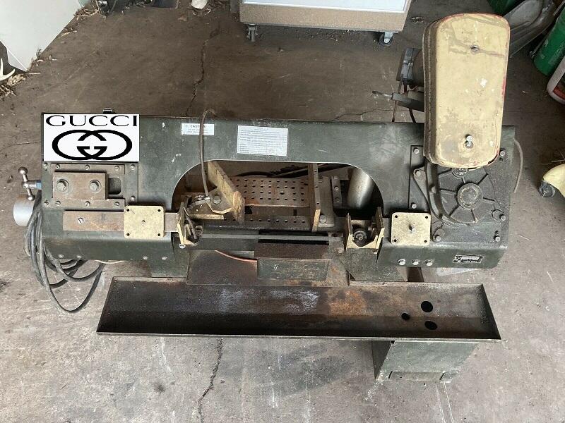

March 22, 20223 yr comment_637530 1 hour ago, Av8ferg said: don’t have Gucci tools like Captain Obvious. Link to comment https://www.classiczcars.com/forums/topic/66453-77-280z-restoration/?&page=4#findComment-637530 Share on other sites More sharing options...
March 22, 20223 yr Author comment_637536 10 hours ago, Captain Obvious said: You have got to be kidding me!! That’s hilarious Link to comment https://www.classiczcars.com/forums/topic/66453-77-280z-restoration/?&page=4#findComment-637536 Share on other sites More sharing options...
March 22, 20223 yr comment_637539 Hahaha!!! Link to comment https://www.classiczcars.com/forums/topic/66453-77-280z-restoration/?&page=4#findComment-637539 Share on other sites More sharing options...
