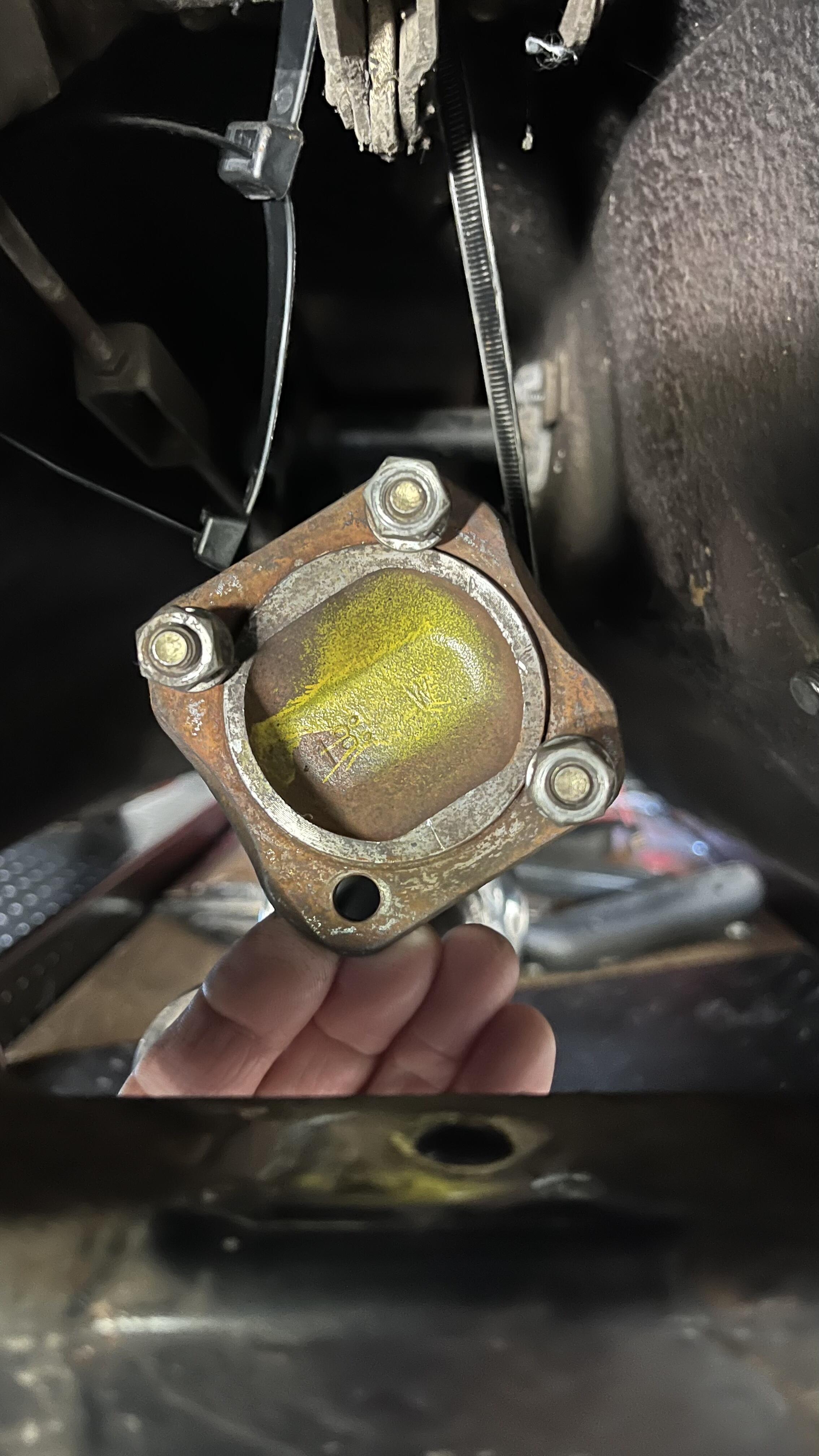

On 3/22/2022 at 8:47 PM, Av8ferg said:
The hypothesis we had when messing around with it was that it might be to keep dirt/grime out of the bushing/bushing holder that is behind it. Mine came with on on RHS too.

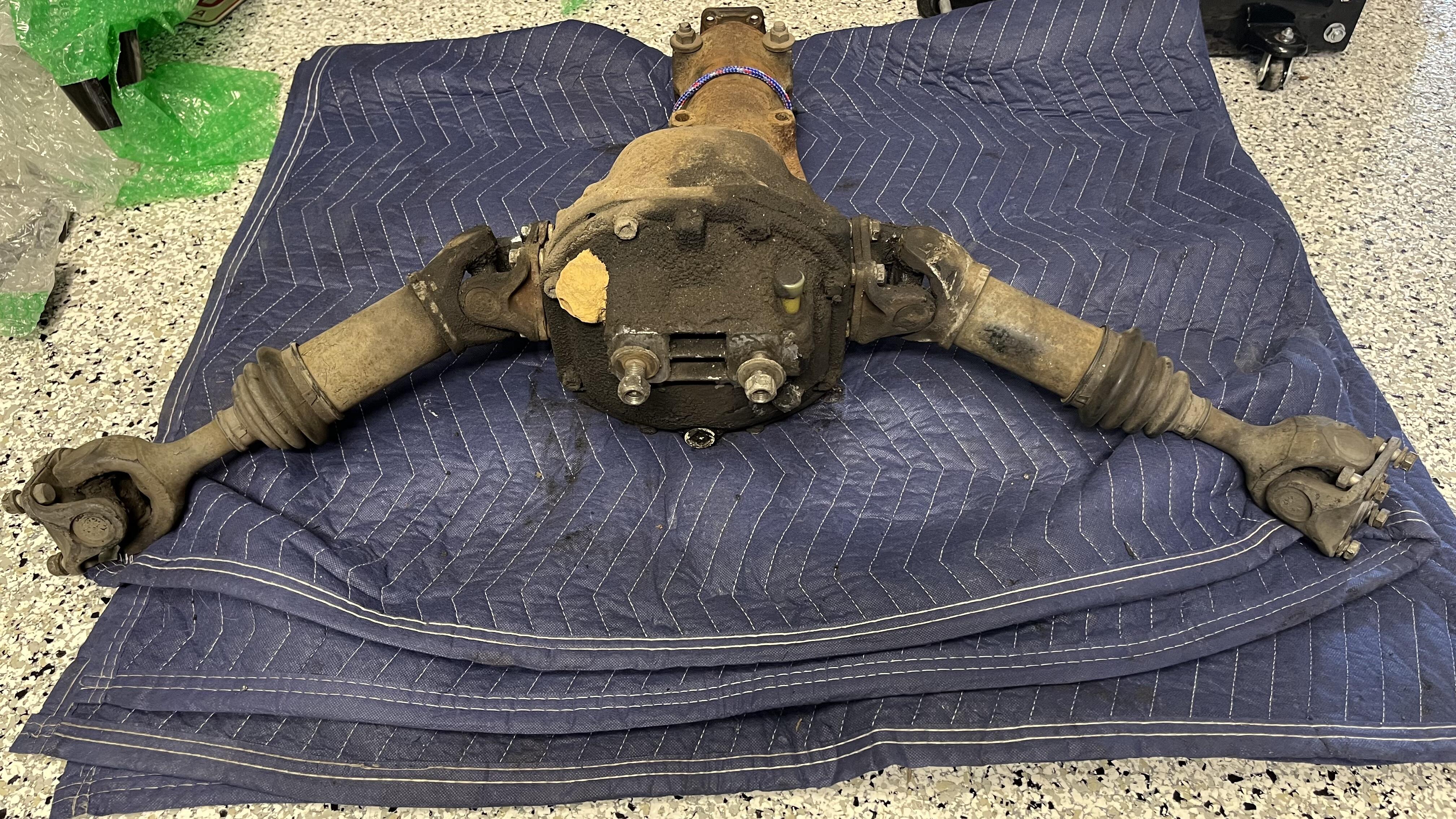

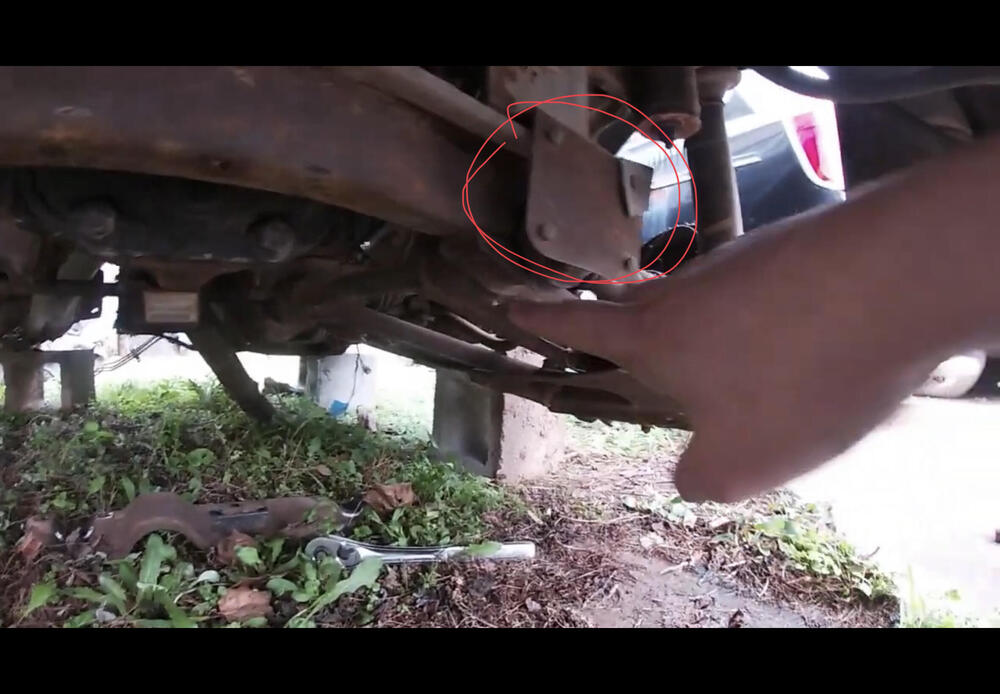

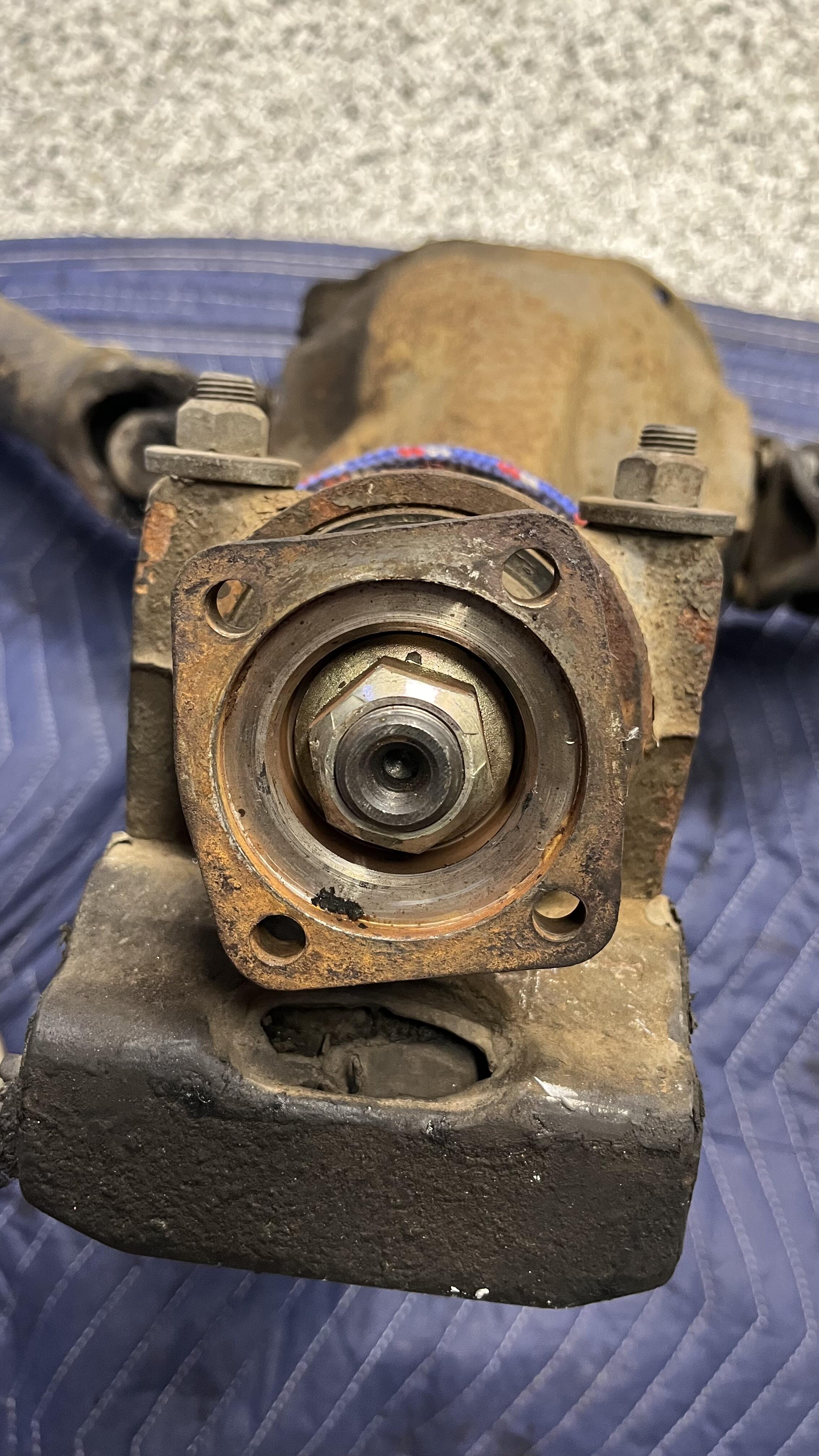

I decided to start investigating my rear differential and the noise back there.   While loosening the diff drain plug it became obvious the the bolts holding the diff to the mustache bar were loose. Loosen enough to allow movement of the differential.  I decided I’d make a run at getting the differential out, so I could install the new mount and TechnoVersion stop.   It wasn’t an easy task, potentially hazardous as the differential is very heave and awkward.  I had to remove mine with the half shafts installed because of one stripped bolt on half shaft.  Took me all morning to  get all this out.

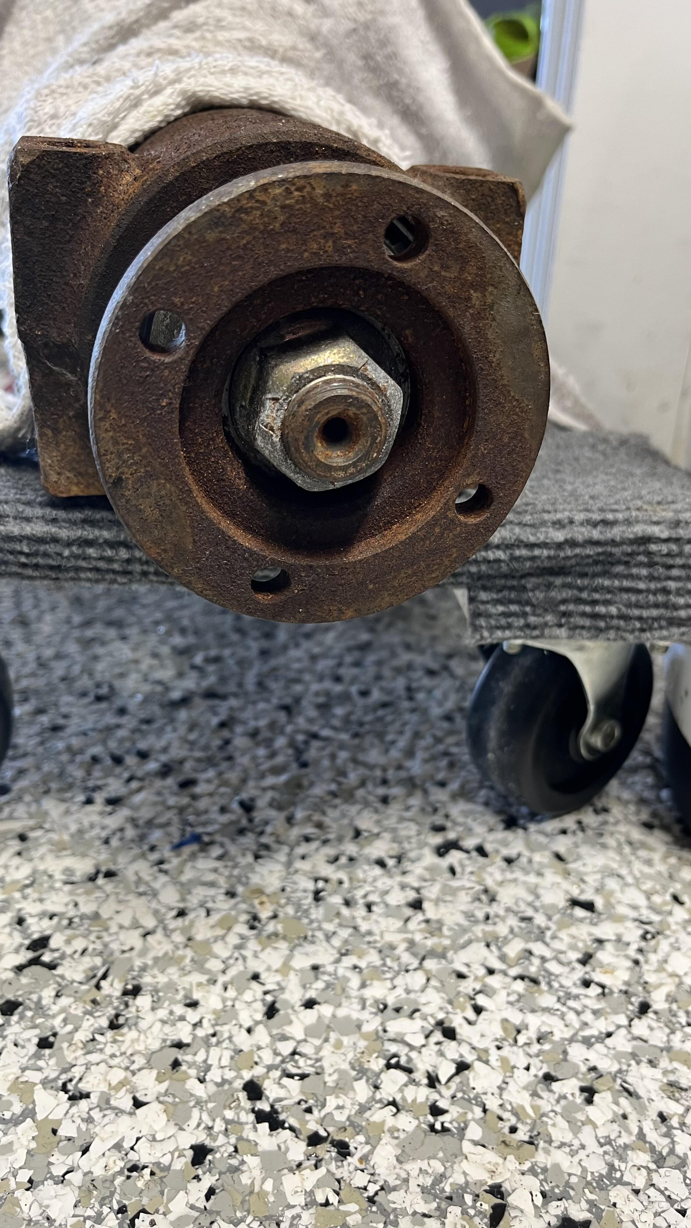

Heres are some pics.  Of note the part of the differential that connects to the propeller shaft has a different mounting plate on my differential and the ZX one.   Should fit fine because I measured the inner flange diameter and they’re the same.  Bolts are 8mm diameter on both.  Mustache Bar bushings ate shot….got new ones on order.  Can’t wait to remove the old ones🥲
made a video showing how loose the differential.   See link
Dan, you don’t want to do it like it did.  It’s hazardous for sure.  I’ll post some lessons learned later.

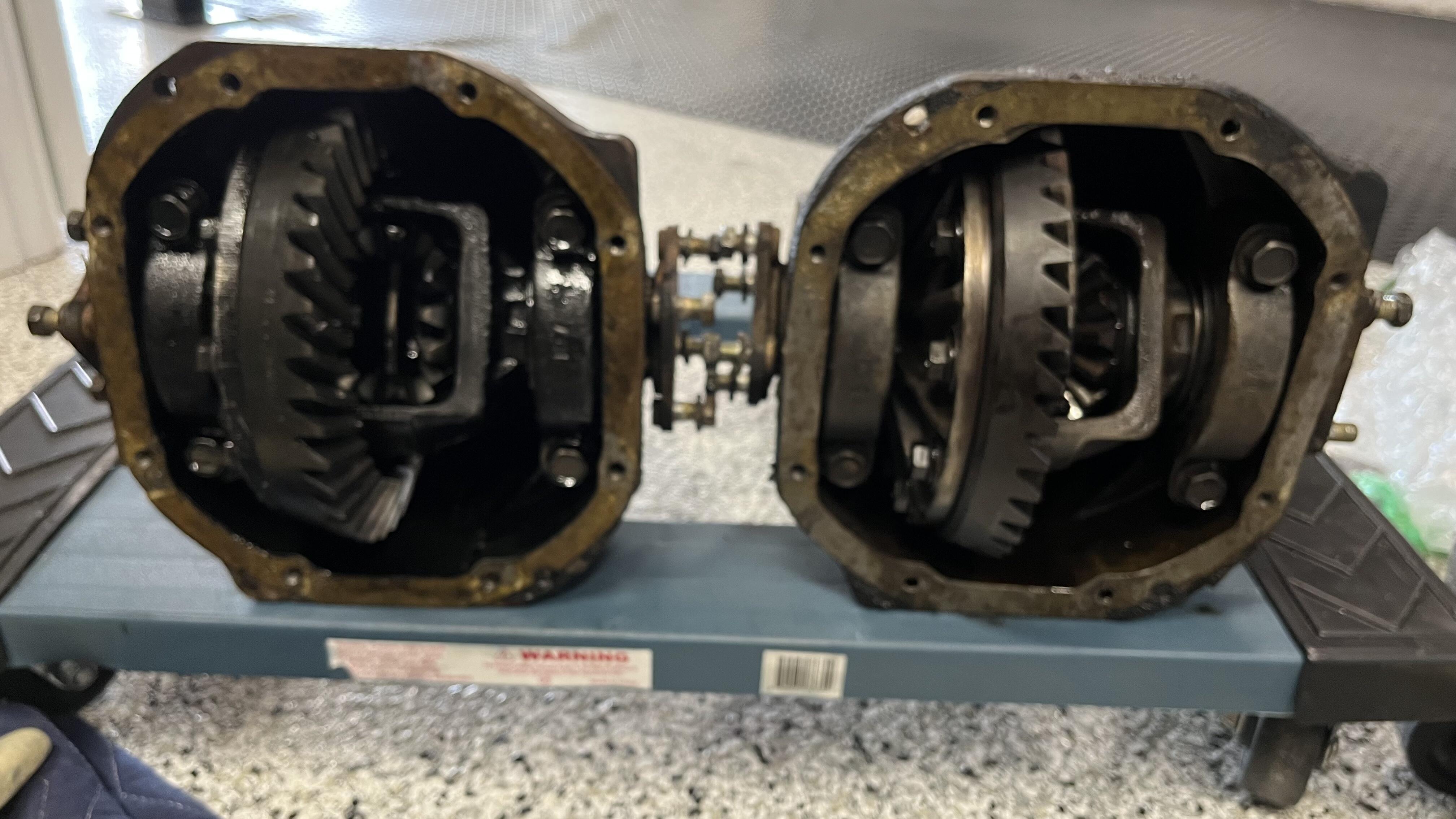

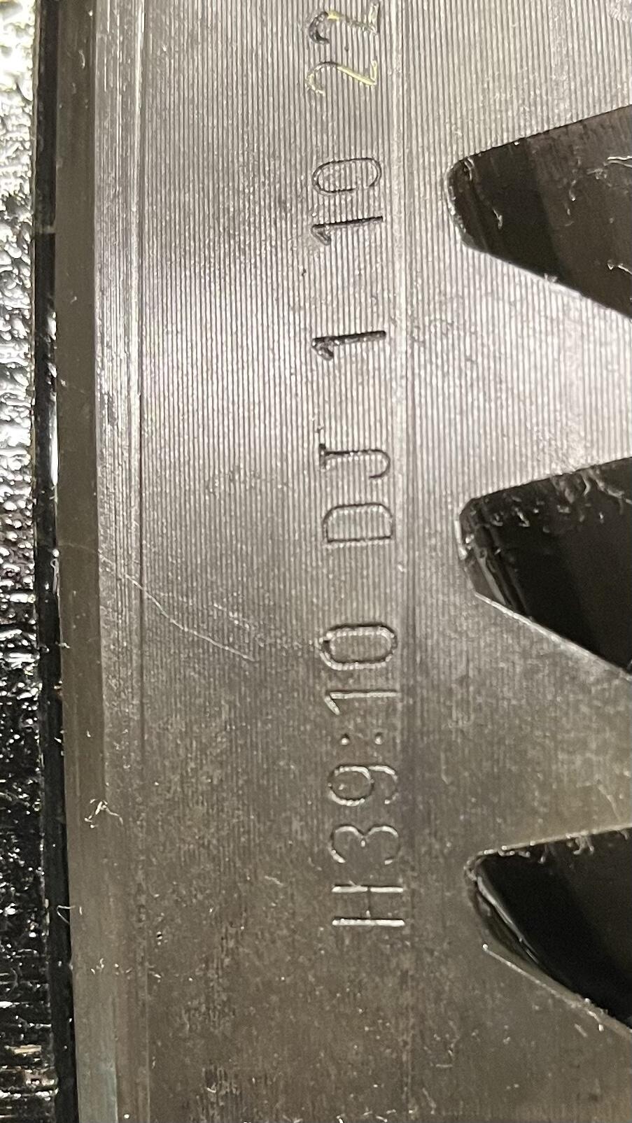

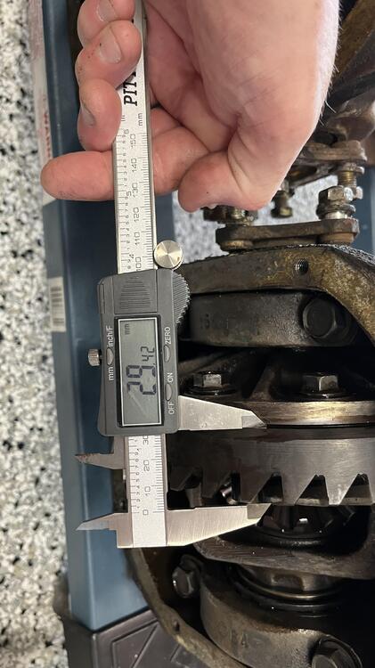

So after cracking open my old differential i discovered it is also a 3.9.   It seems to be in good condition like the ZX one I have.

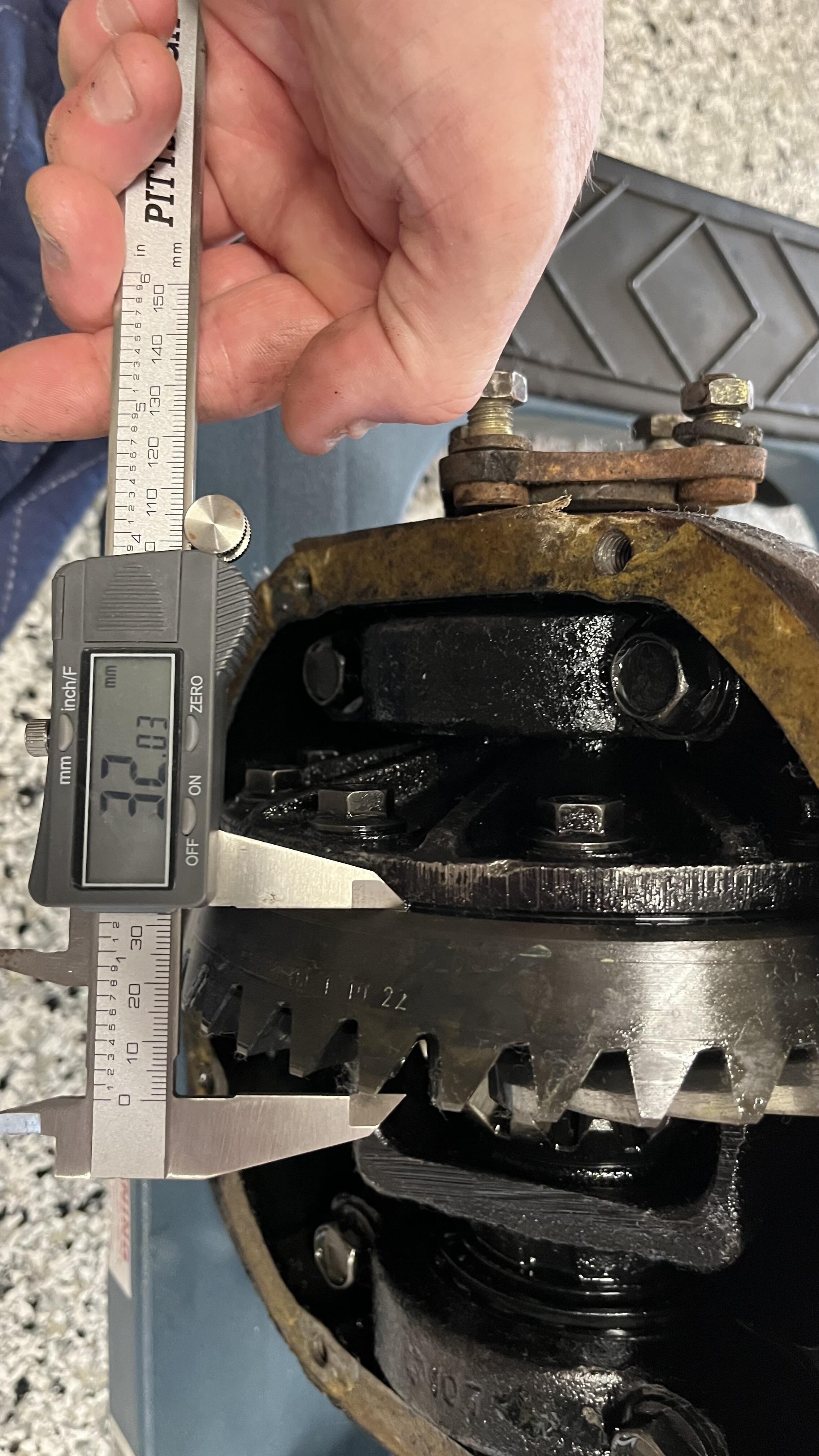

These differentials are not 100% identical.   The one I removed from the car is has 39.11 stamped in the Ring Gear.  The replacement differential I got from a 1982 ZX has 39.10 stamped on the ring gear .  The ring gear of the old Differential is thinner that the one from the 82” ZX.  29 vs 32 mils.
I haven’t decided which one I’ll use.  Seems like the one from the 82 ZX has more lash where the half shafts mount the my old one.  . Here is some pics of the differences.  The 82 ZX Differential is in the left in the pic.

Thanks ZedHead, that make the decision pretty easy. Good information there. Seems like the ZX one is a bit more robust just liking at the ring gear size.
