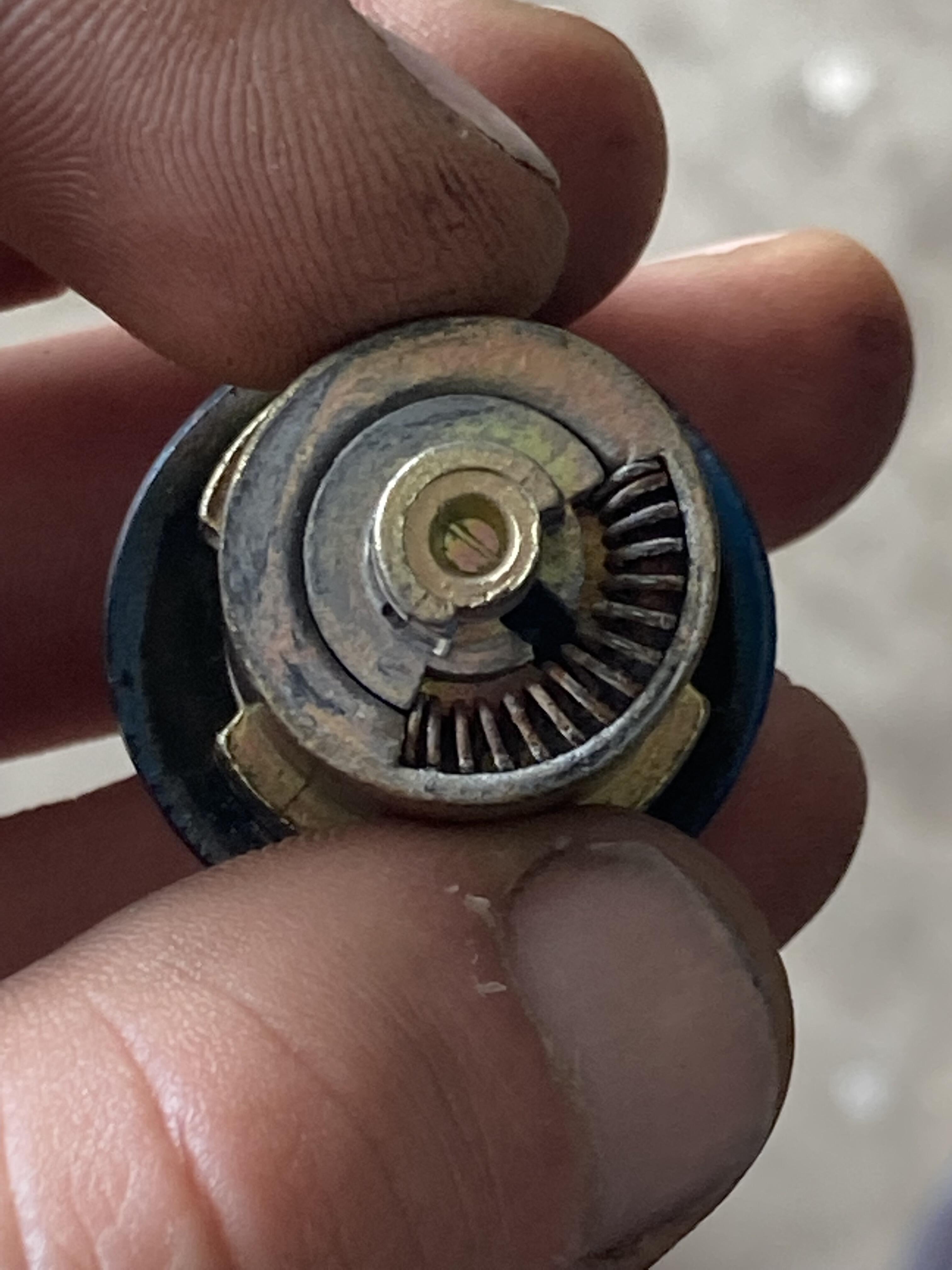

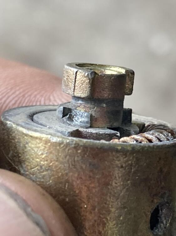

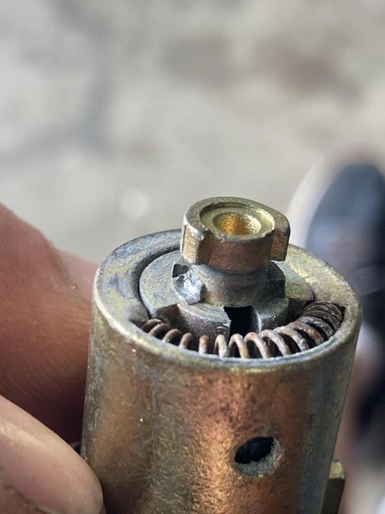

Before I did that though, I noticed with the clip out, that the actual seat for the clip had been partially chipped off.
Here is what I mean
Do you guys have any experience with this happening and a method to fix it? Or am I out of luck and need a new lock. If needing a new lock is the case is there a lock I can get that can be keyed to fit my original car key. Having multiple keys for a car would annoy me immensely.
Thank you!!
You might be able to tack on a little weld then file it down. Not sure how JB weld files down.
Multiples keys for the car is super annoying.
rekeying these cylinders can be done but that is also a huge pain in the arse due to how the cylinder cover is wrapped over the body.
