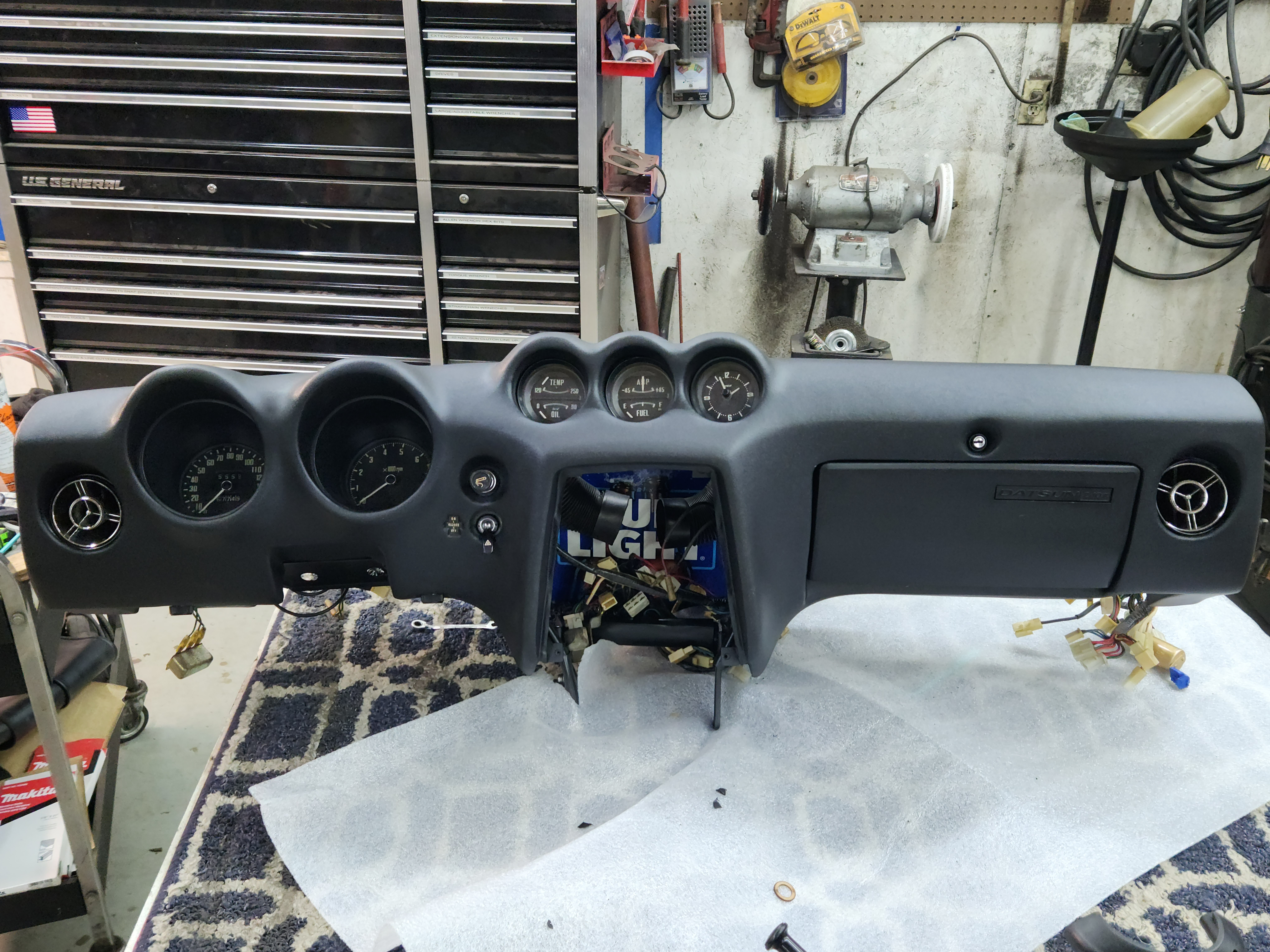

I got my dash back from just dashes. Pretty pleased with the job they did. I put it all together today.  I replaced all the lights with LED's. Only three of the original bulbs were working.   Cant say enough about the importance of taking a ton of pictures during disassembly. That really helps.
Edited by emccallum
