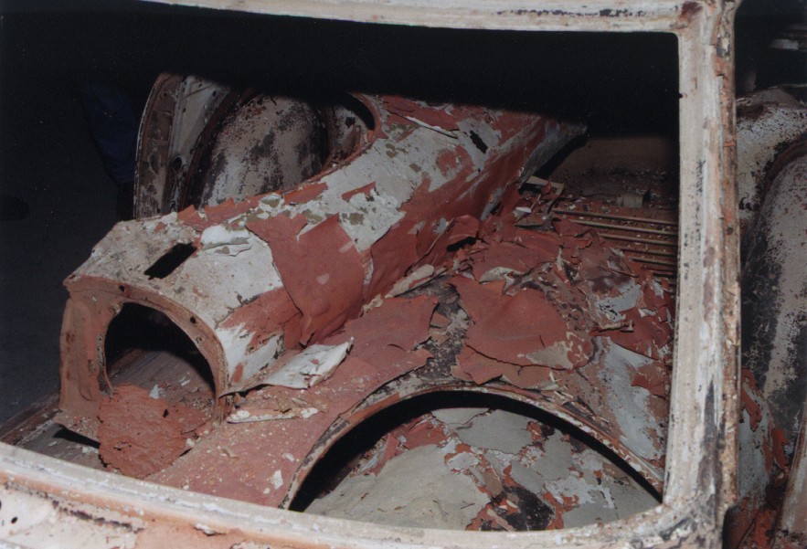

That's what Z-point did. I wonder if such heating is safe - worried about a structural changes in metal. Hope it is.
Thanks blueZee for the advertising. :love: Backing you better say burning!!
I would not recommend it to anyone. It is a very determent way of getting rid of your paint. And an easy one also, this for your lazy workers among us. ROFL It is often used for to make race cars lighter. Normally there is on cars lots of paint, ant vibration material; underneath body protection etc. race cars don’t need them. They crash into the first corner..LOL
But if you like to preserve you car for a longer time with this manner you overshoot the target.
It will burn all the protection between all the metal even at the places where you not able to get by. Especially between the fold seam and the frame.
I covered it well with Dinitrol but even now already there are some places of which I think “you did it not good Guus!”:disappoin

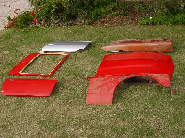

Well I have to say that dipping it is. I just got my panels back, and aside from the usual rust, they are great. I had the guards, doors, bonnet and hatch done, and they guy did a great job. I get the results of sandblasting but lose no metal as its non abrasive, the rust is chemically removed so no good metal is lost, then he coats all parts inside and out with 2pak etch primer, ready for further body work. I could not recommend the process enough, it was a bit costly, but the results were in my opinon enough to justify the cost.
(not a plug but its Minus Paint in Wingfield for all the SA guys)
Why blast, scrape sand grind of burn when it works this well?
Cheers Chris
