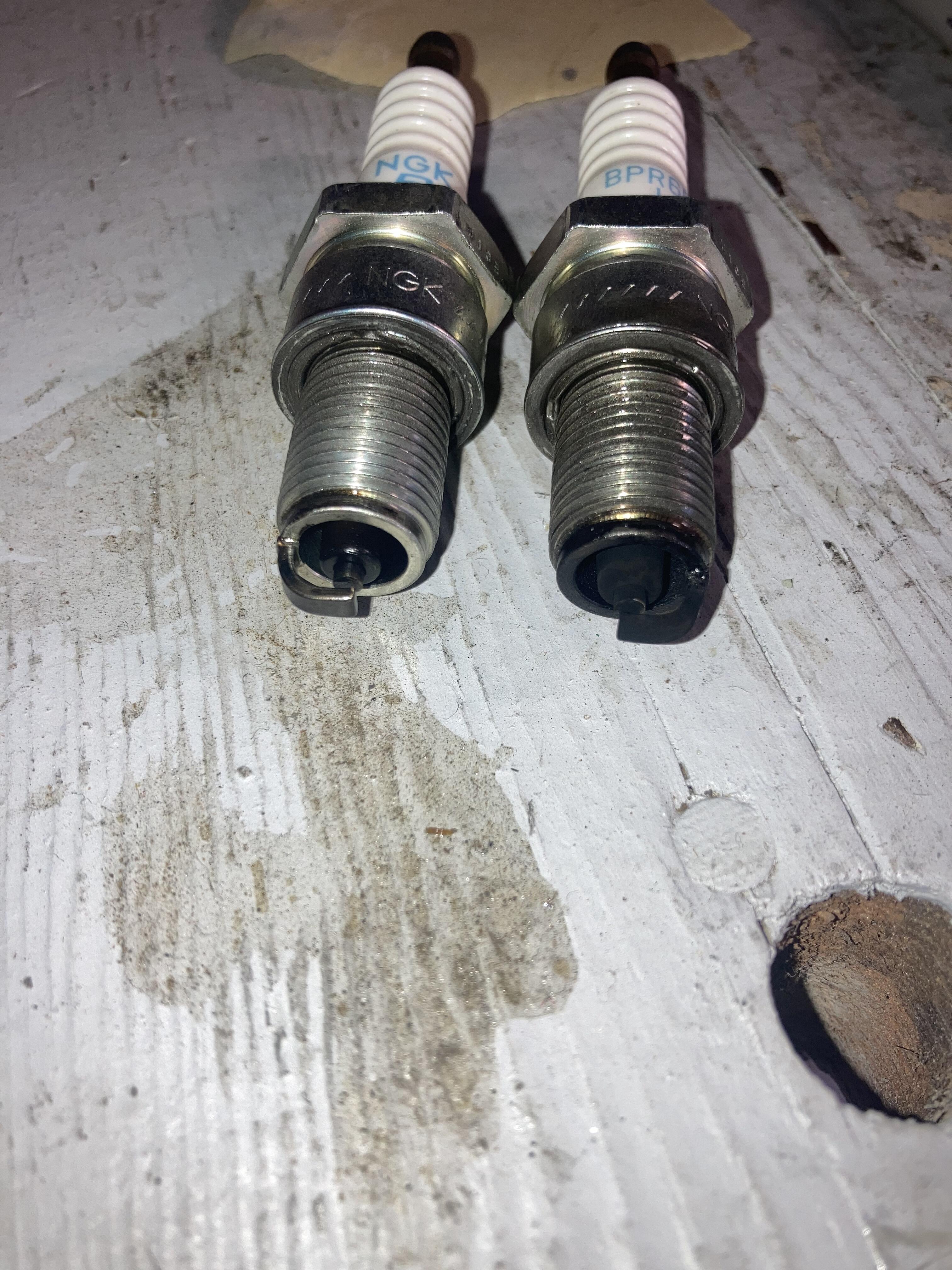

7 hours ago, Zed Head said:
The dead cylinder might be only happening at idle.  That might explain why the plug porcelain is dark, indicating combustion at some time.  A dead cylinder with a new plug should be "like-new" white.
Now, I was super intrigued by your post as it would make sense. However, I remember playing with the idle enrichment screw on the AFM to see what was happening if the motor was lean or not. Lets just say I fouled some plugs whoops. But here was cylinder 1 compared to #2, Which I think pretty accurately confirms no boom🔥 is happening in #1:(

Something about that #2 plug looks like it's getting a rich mixture.  Not sure if it's a clue or not but it sure looks too rich to me.  I'm wondering if all of the plugs removed would reveal wildly uneven mixtures throughout all  6 cylinders.  Perhaps that would tell us something?  I haven't quite worked out what all that would mean if anything at all.

@Reptoid Overlords
You are 100% correct that the plug was carbon fouled to a rich mixture. When I originally noticed the motor was running rough, it was behaving exactly like the motor did when it was running super lean across all cylinders.
So I probably did exactly what you shouldn't do, but I richened the idle mixture screw on the AFM to see if it made a positive difference. It didn't, just choked out the motor. I since corrected the AFM back to normal and the plugs all look good again besides #1.
However, right after running the motor super rich is where I decided to get smart and see if every cylinder was firing. That was when I made the discovery that #1 wasn't. Super easy to tell with the carbon fouled plug, and then other from #1.
