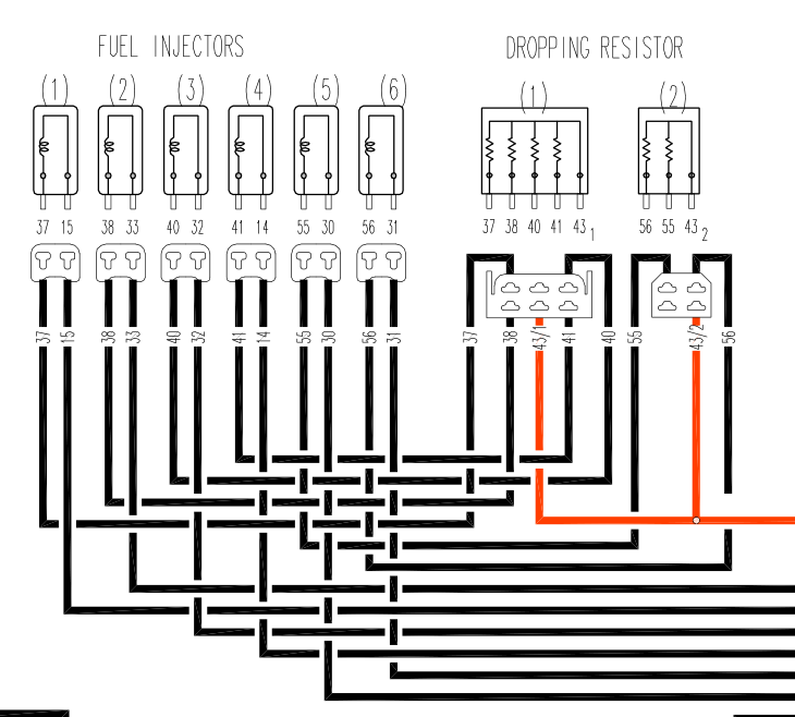

April 3, 20222 yr comment_638937 I would unplug the dropping resistors (you might be able to do it without removing the resistor, can't remember), then check continuity to the injector #1 plug from the resistor plug. I don't know if the wires at the dropping resistor are color coded or not. Link to comment https://www.classiczcars.com/forums/topic/67366-1977-cylinder-1-mystery/?&page=3#findComment-638937 Share on other sites More sharing options...
April 3, 20222 yr comment_638938 Looks like they are not color coded. So, your best bet is to unplug them all and confirm continuity for each power wire to each injector. Then check the wires in the dropping resistor itself if you find that all injectors have continuity. You'll have to remove the resistors for that. The problem would be either in the dropping resistor assembly itself or in the harness on the way to the injector plug. Edit - just noticed that #1 should come from the resistor with five wires. Just keep narrowing things down... If the drawing is correct you can even tell which pin is #1 by its position. Edited April 3, 20222 yr by Zed Head Link to comment https://www.classiczcars.com/forums/topic/67366-1977-cylinder-1-mystery/?&page=3#findComment-638938 Share on other sites More sharing options...

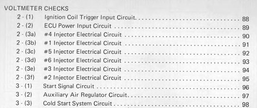

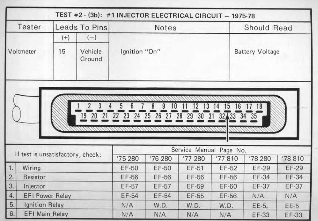

April 4, 20222 yr Author comment_638941 Update: So I checked voltage at the pin on the injector connector. It gets the proper voltage. I also checked it at the pin on the dropping resistor. Gets good voltage. So it's my understanding that the fuel injector plug gets 12v constantly correct? And that the injector fires by the ECM alternating the ground to the injector plug, thus firing the solenoid in the injector. So, in theory, if my connector is getting 12v than the reason for it not working is that the ECM is either malfunctioning and not pulsing the ground, or the ground in the harness is bad. But then that begs the question, if my injector connector is getting 12v, why would it not be reading 12v at the ECM? 1975 280z #1 Injector Circuit.pdf Link to comment https://www.classiczcars.com/forums/topic/67366-1977-cylinder-1-mystery/?&page=3#findComment-638941 Share on other sites More sharing options...
April 4, 20222 yr comment_638942 Did you disconnect all of the injectors before you measured voltage at the injector plug? And did you measure both pins of the injector plug? You are correct about power and the ECU grounds. But the ECU grounds several injectors at the same time, in two separate groups. If you left the other injectors plugged in and saw voltage on one pin it would be because the injectors are wired in parallel as CO explained long ago. You need to unplug all six injectors before checking for voltage. Actually, that should have been the first suggestion, before digging in to the dropping resistors. Unplug all six to break up the parallel circuit, turn on the key, and measure voltage at each pin of each injector plug. That will tell if #1 is getting power. You should see battery voltage on one pin of each plug. Link to comment https://www.classiczcars.com/forums/topic/67366-1977-cylinder-1-mystery/?&page=3#findComment-638942 Share on other sites More sharing options...
April 4, 20222 yr comment_638943 But you do bring up a good point about the grounding part of the circuit. You could have power but no ground. You can measure voltage at the ECU connector also. That will test the whole circuit. If you have voltage there then your theory about the ECU fits. Then you can get out your magnifying glass and check the trace back to the transistor. Link to comment https://www.classiczcars.com/forums/topic/67366-1977-cylinder-1-mystery/?&page=3#findComment-638943 Share on other sites More sharing options...
