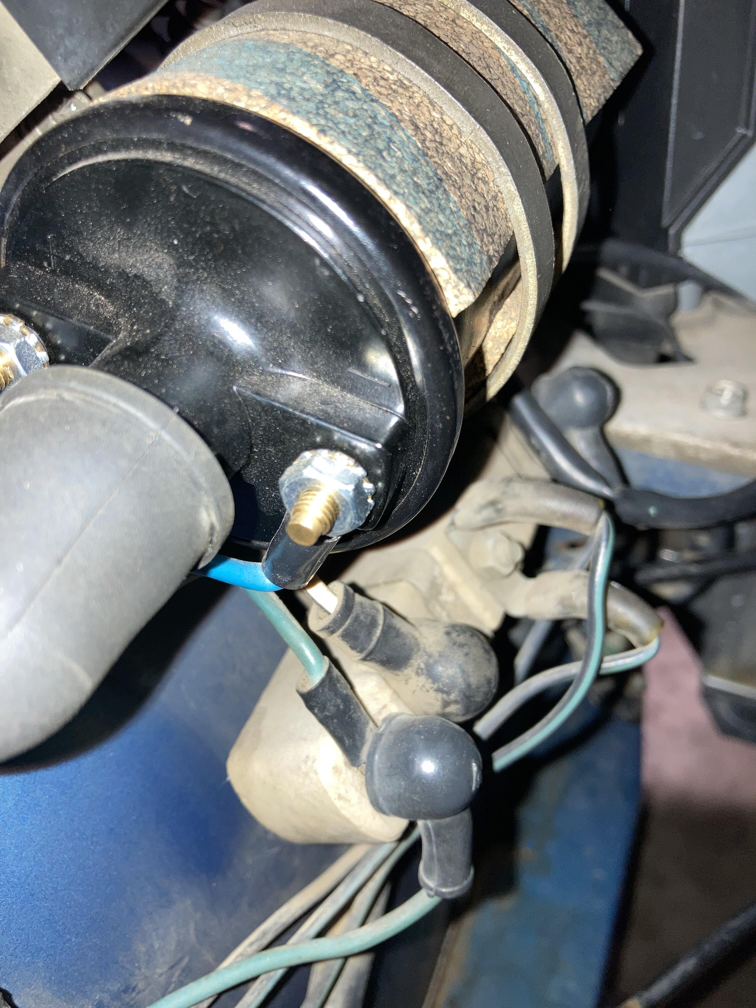

April 7, 20222 yr comment_639085 I just looked at the 77 tune up chapter and can't tell if you have the old style or the new style. I thought 77 used the ballast resistor but they don't show it there. Do you have a ballast resistor by the coil? Link to comment https://www.classiczcars.com/forums/topic/67366-1977-cylinder-1-mystery/?&page=6#findComment-639085 Share on other sites More sharing options...
April 7, 20222 yr Author comment_639087 Yes, I have a ballast resistor. I tested it last year, and it looks like it is still in good condition. Link to comment https://www.classiczcars.com/forums/topic/67366-1977-cylinder-1-mystery/?&page=6#findComment-639087 Share on other sites More sharing options...
April 7, 20222 yr comment_639088 Looks like 77 already has the high energy ignition. I always get the change mixed up with the fuel pump control. 77 was kind of a mid-change year, it still has the old AFM pump relay switch, I think. Posting before I see ckurtz's reply... Weird! The FSM says you shouldn't. Probably a mid-year change. So, if you're using the FSM tuneup spark plug gap, you'd be using a wide gap on a weak ignition. What plug gap are you running? Migth be a small part of your problem. Either way, the GM module will give more energy and allow the larger gap. Edited April 7, 20222 yr by Zed Head Link to comment https://www.classiczcars.com/forums/topic/67366-1977-cylinder-1-mystery/?&page=6#findComment-639088 Share on other sites More sharing options...
April 7, 20222 yr Author comment_639089 Interesting, I feel like Datsun jipped me on the ignition system then haha. The vin plate says 01/1977 so it is an early 77. Also has the weird sloped rear deck. Here is the ballast resistor. Well I got the BPR6ES so it's pre-gapped to .035. I can almost guarantee that I left that gap on the old plugs which were also the same type. What gap would you recommend then if I am running the weaker type system? Just do like 0.04? Link to comment https://www.classiczcars.com/forums/topic/67366-1977-cylinder-1-mystery/?&page=6#findComment-639089 Share on other sites More sharing options...

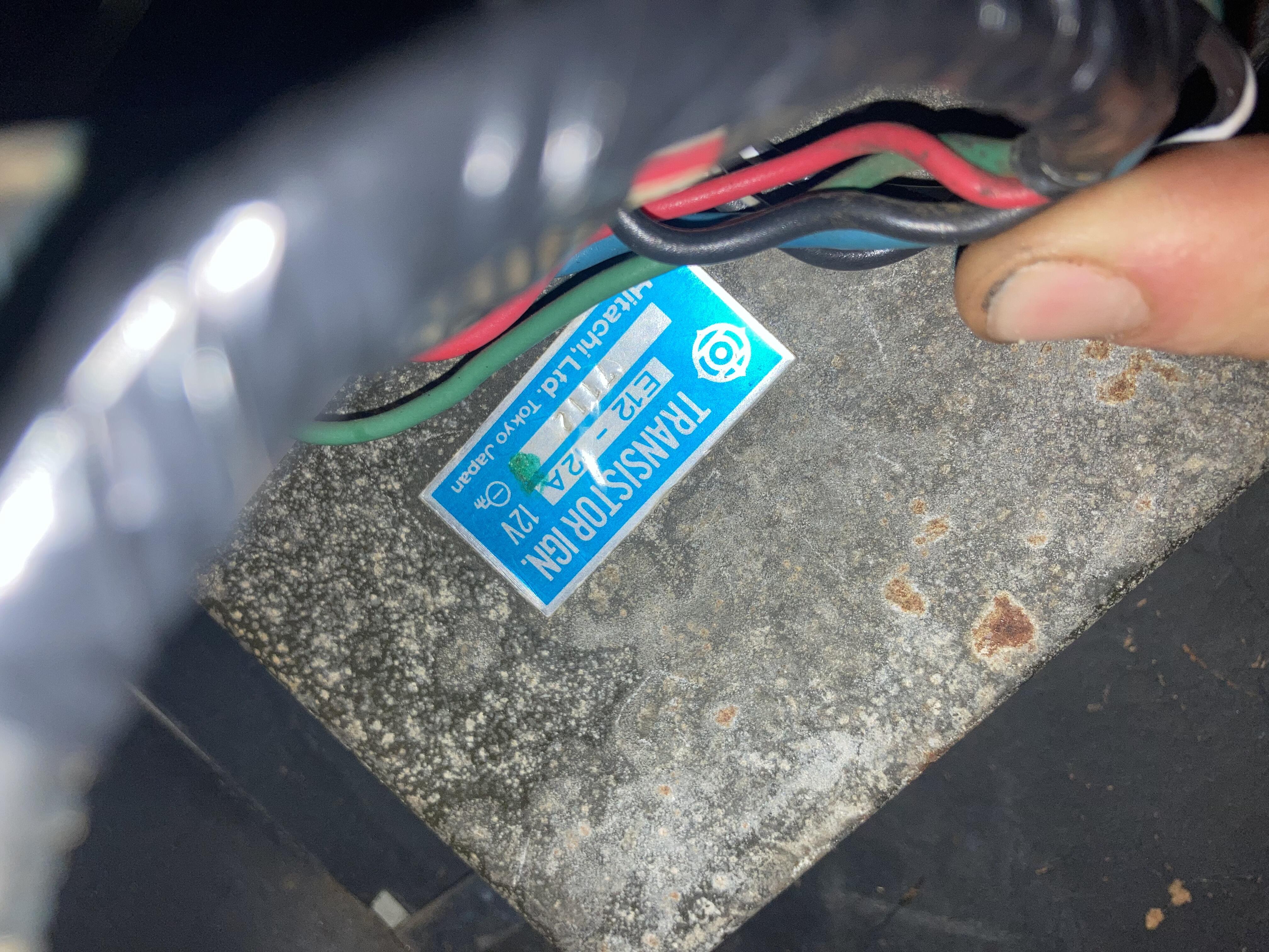

April 8, 20222 yr Author comment_639099 Lets settle this. The Number is E12-12A. 7112 Edited April 8, 20222 yr by ckurtz2 Link to comment https://www.classiczcars.com/forums/topic/67366-1977-cylinder-1-mystery/?&page=6#findComment-639099 Share on other sites More sharing options...
April 8, 20222 yr comment_639100 Yes, I have a 77, and yes, that's a 77 ignition module. It is my understanding that the 78's don't need a ballast resistor because the ignition module does a better job current limiting and/or dwell control. Link to comment https://www.classiczcars.com/forums/topic/67366-1977-cylinder-1-mystery/?&page=6#findComment-639100 Share on other sites More sharing options...
April 8, 20222 yr comment_639101 What about the FSM showing no ballast resistor and larger plug gap? The 77 FSM seems to show 78 material. The higher energy comes from electronic current limiting. The ballast should be unnecessary. Does the module number match the 1978 module? Does it have the plug or the terminal board for connecting it? I looked around the internet and can't find any E12 numbers, only LX. My basic point is that Nissan did not get everything done in time in 1977. It looks like they held on to the old style for a while. Edited April 8, 20222 yr by Zed Head Link to comment https://www.classiczcars.com/forums/topic/67366-1977-cylinder-1-mystery/?&page=6#findComment-639101 Share on other sites More sharing options...
