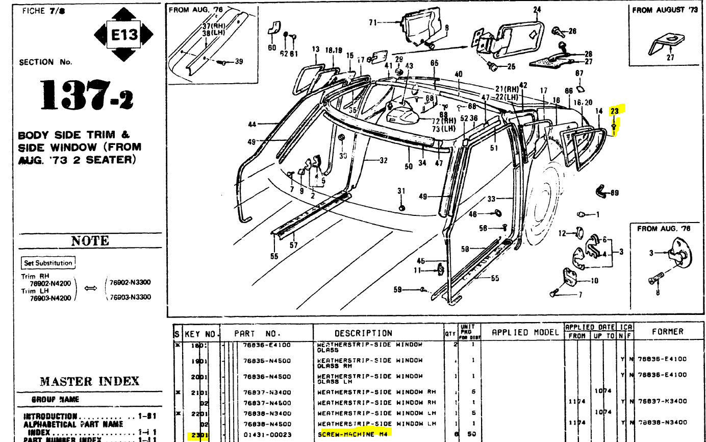

I am removing my quarter windows to replace the rubber.  I managed to get the retainer screws out without breaking them, but damaged the heads.  I would like to know the diameter and pitch of these tiny screws so I can replace them.
Thanks!
M4, .7, thanks!  I do have the JIS screwdriver, without it I would never have been able to budge them.  But, as I was removing them they were very tight, and the heads seemed rather soft and began to deform.  I cleaned and oiled the threads as much as possible.  Just glad I got them out, but would like to put new ones in if I can find them.  The search is on.
