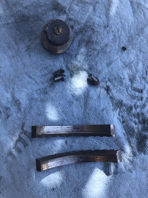

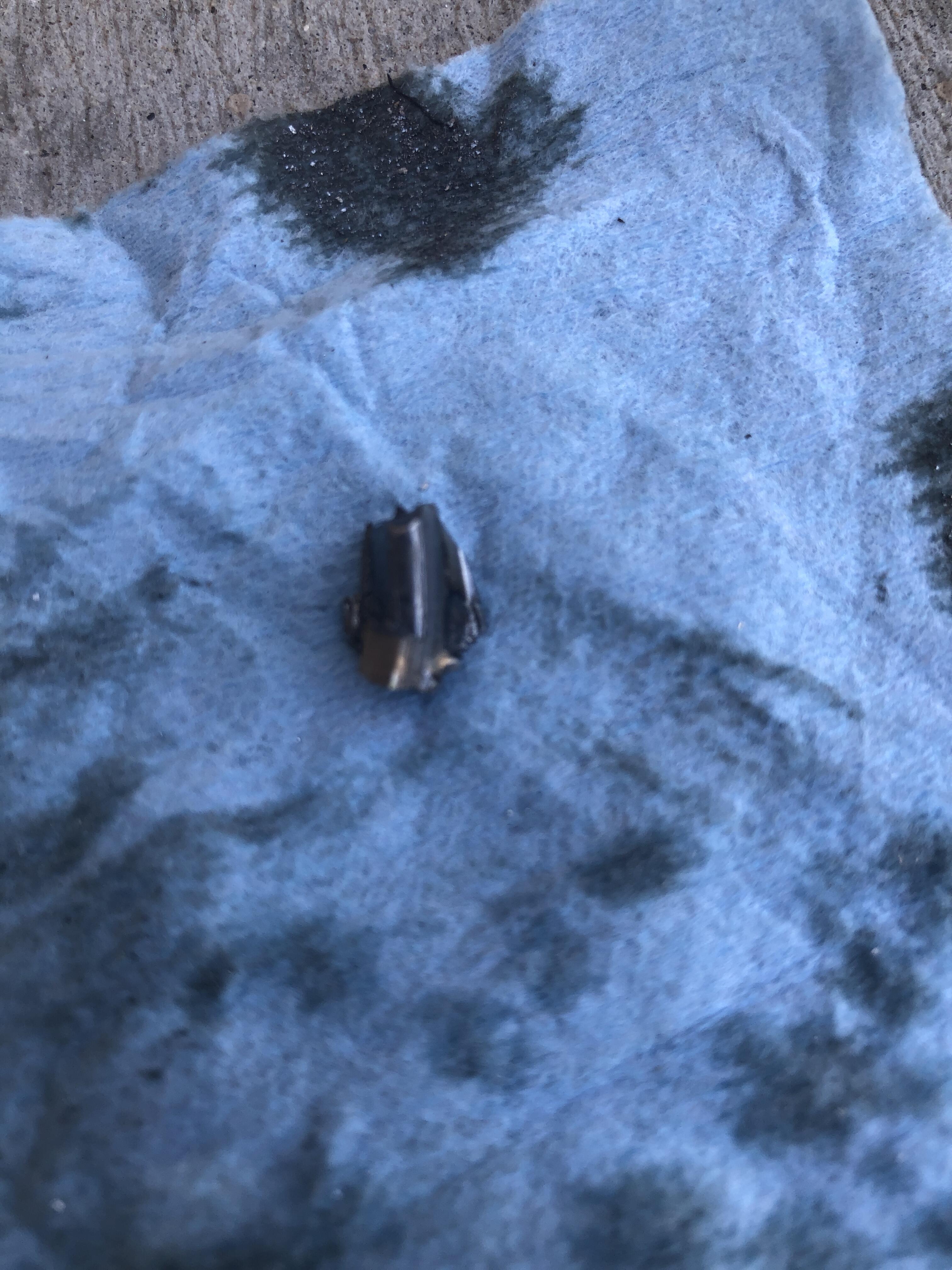

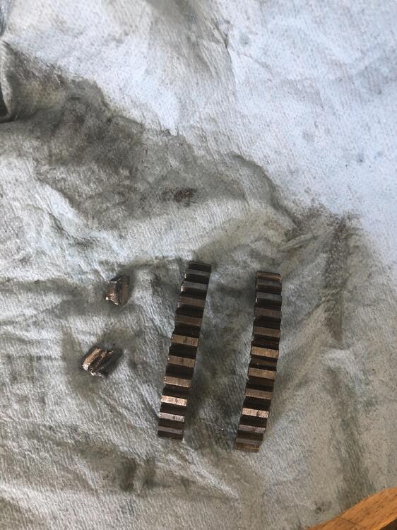

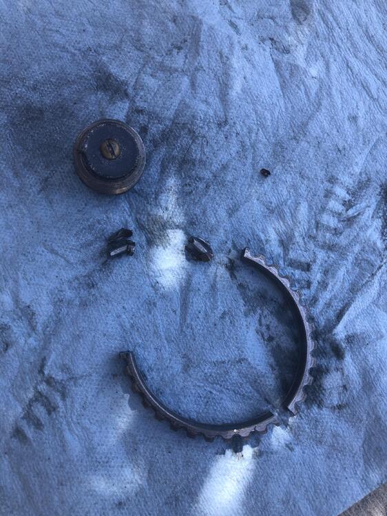

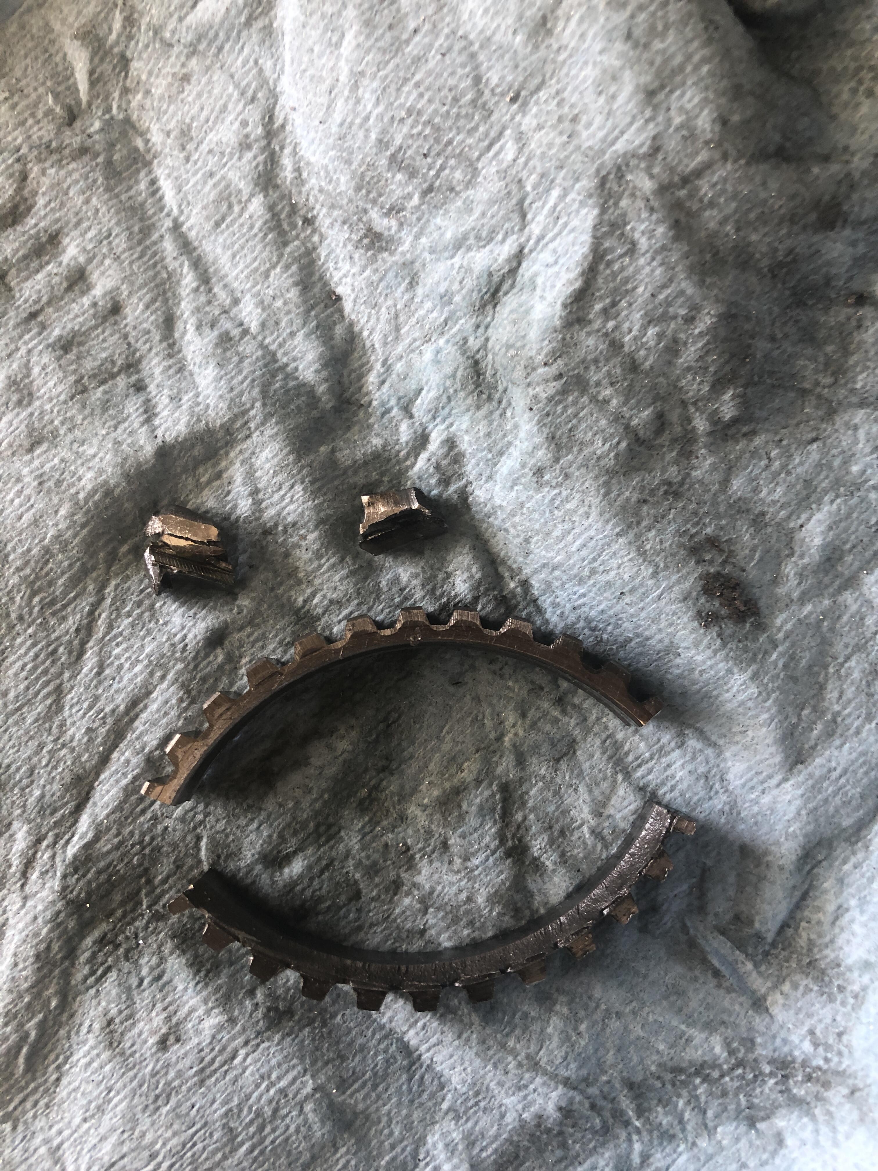

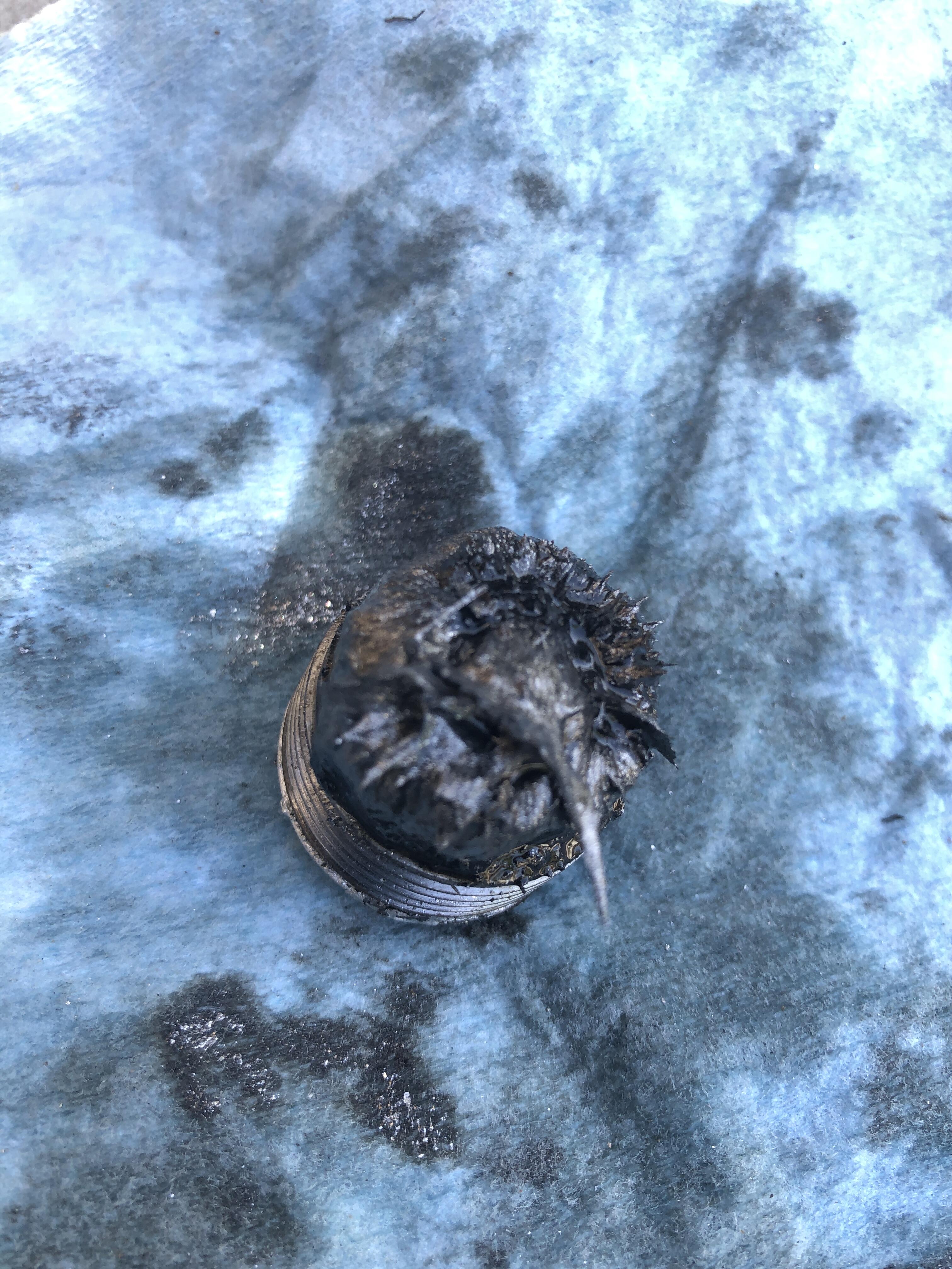

April 7, 20223 yr Author comment_639056 Gents and ladies Bad news. Drained the oil and 2 small metal derbies stuck to the drain bolt magnet. The other 2 pieces of gears were near the drain hole. I was able to pull them out using my pinky. The 2 pieces gears look like a 3-pieces as their ends look cleanly cut. Take a look at the photos. what am I up to? The trans is totally toasted or still salvageable? It’ll take me at least another week to pull it off the car. regards Link to comment https://www.classiczcars.com/forums/topic/67383-1977-280z-with-fs5w71b-transmission/#findComment-639056 Share on other sites More sharing options...
April 7, 20223 yr comment_639057 @EuroDat will have a better idea but it looks like the remains of a synchronizer/baulk ring, but kind of different. Can you take a picture of the teeth on the parts? They look wide. The other magnetic parts might be bearing parts, which might have caused the synchro ring failure. http://www.carpartsmanual.com/datsun/Z-1969-1978/power-train/transmission-gears/5-speed https://www.nissanpartsdeal.com/parts/nissan-ring-baulk~32604-p0100.html https://www.ebay.com/p/1529633534 https://www.nissanparts.cc/oem-parts/nissan-ring-baulk-s12-z31-720-c31-c32-d21-r31-32604p0100 Link to comment https://www.classiczcars.com/forums/topic/67383-1977-280z-with-fs5w71b-transmission/#findComment-639057 Share on other sites More sharing options...

April 7, 20223 yr comment_639067 Wow, that is not a synchro ring, looks more like part of a coupling hub. I've only pondered the insides of a trashed 5 speed after I took it apart, so don't really have the memories of somebody who has rebuilt one. Looks significant though. You might start browsing the ads for another 5 speed, just in case. Always good to have spares. Even a 4 speed will get you by. Link to comment https://www.classiczcars.com/forums/topic/67383-1977-280z-with-fs5w71b-transmission/#findComment-639067 Share on other sites More sharing options...
April 7, 20223 yr Author comment_639068 I've never seen the internal transmission before ... you probably right. Look like the hub-synchronizer for 2nd-3rd gear. I felt the "jolt" from stop light shifting from 1st gear to 2nd gear. It should be 3 pieces don't you think? maybe there is another one still inside the transmission? or perhaps already destroyed. https://www.carpartsmanual.com/datsun/810-1977-1980/power-train/manual-(5-speed)/transmission-gear/5-speed/45 what's the 5 speed transmission goes for these day? Link to comment https://www.classiczcars.com/forums/topic/67383-1977-280z-with-fs5w71b-transmission/#findComment-639068 Share on other sites More sharing options...
April 7, 20223 yr Author comment_639071 Curious, the 2 pieces broke off, how come I can still able to shift smoothly from gear to gear? Link to comment https://www.classiczcars.com/forums/topic/67383-1977-280z-with-fs5w71b-transmission/#findComment-639071 Share on other sites More sharing options...
