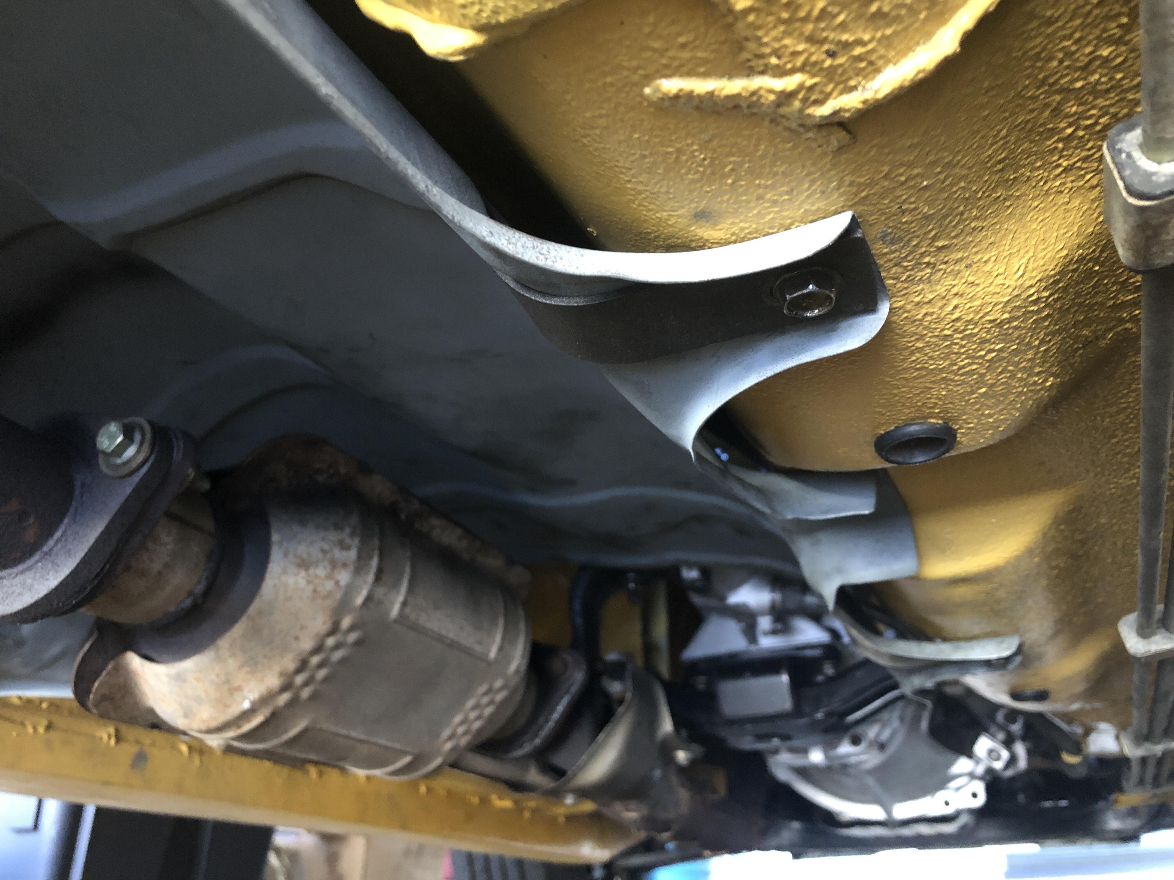

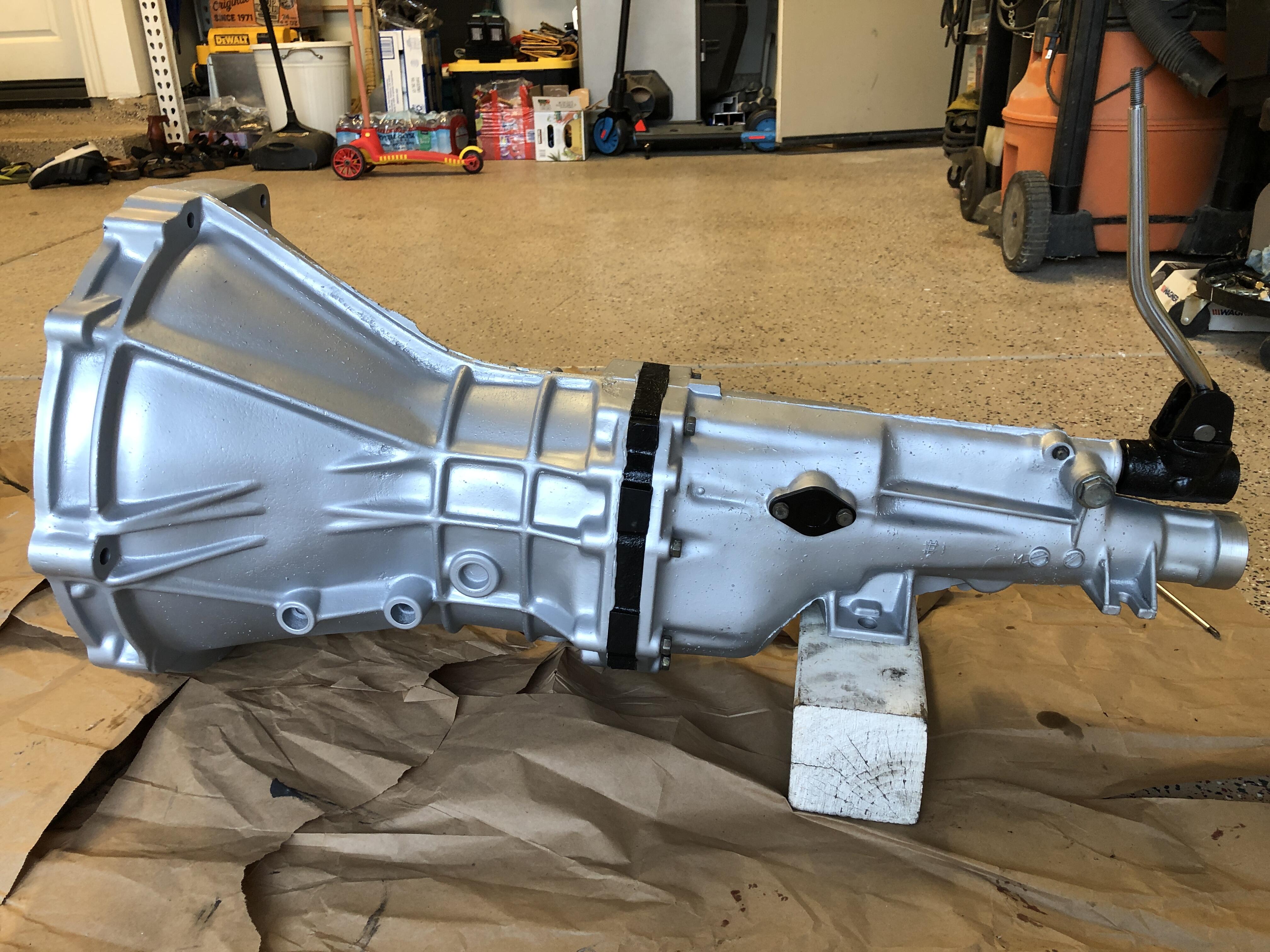

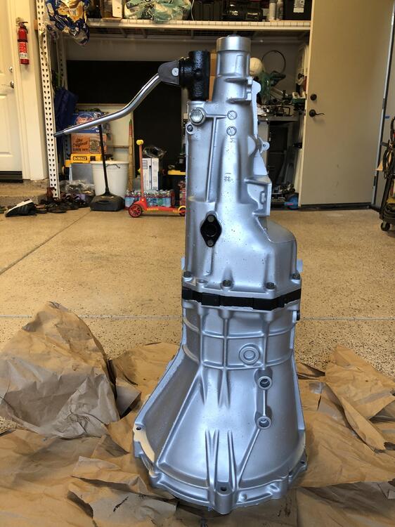

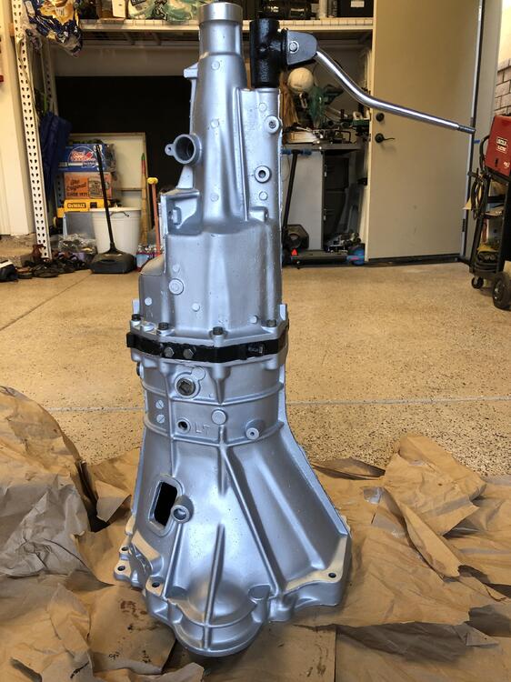

Alright folks, everything is in. I’ll let the seal gasket dry overnight and will try to put mount to the car.  The darn thing is heavy as a whole unit.  Shifting is smooth and tight.  The plastic shifter bushing is ordered and on its way.
believe me, when you're motivated, you'll get thing done rather quickly.  Beside, experts in this forum help me a lot.  Cut down the time searching the net.  The time it took the most actually waiting for parts, especially the left threaded main shaft nut.
This is my first rebuild transmission.  I used the tools I have at hand.  Mostly Mineral Spirit, brake cleaner, wire brush and lots of old dirty T-Shirt.  Putting back is surprising easy and fast with the mini torch to warm up the bearing.  I did not do ultra sonic cleaning of the gears/synchros as I do not have the tools.  Mineral Spirit works wonders on soften/breakdown the layers of old oil.
Everything is at least 3 times heavier when you're under the car.  I do not have the lift.  And thanks God, first try I got it latch on.  Thanks part to the transmission tunnel.  It help keep the transmission from topple down side way.
I recall when I install the differential.  Though the back has more room and clearance.  It took me at least 5 times to get it on.
Will get the rest of the exhaust hardware install later.
stay tune folks
Folks, exhaust is in.

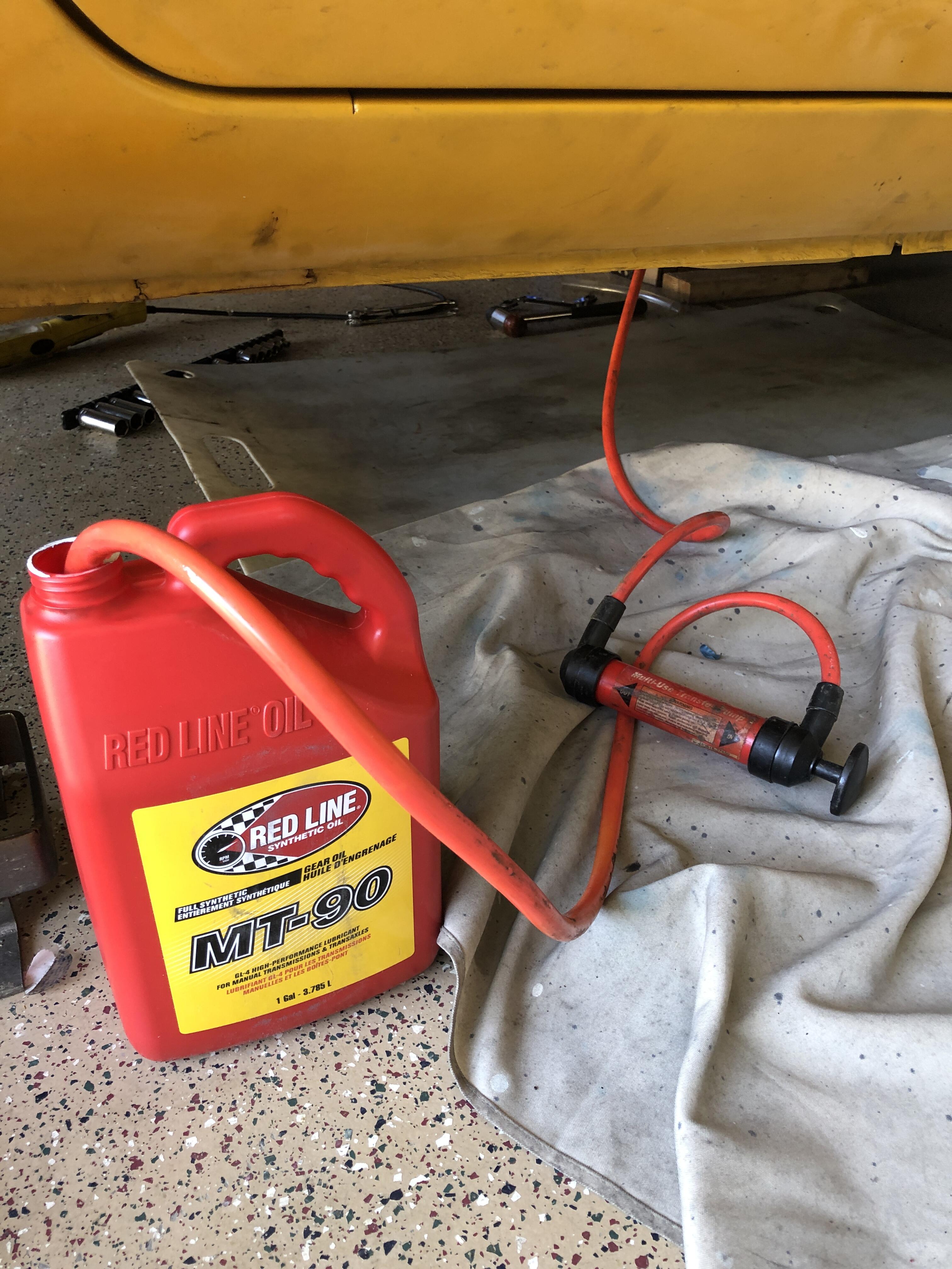

I seal threaded the drain and filler bolts and fill the oil via the speedometer hole.  I use the cheappo hand pump from harbor freight till the oil start creeping out the speedometer.  Then I raise the engine up a bit to drain more oil out.  The speedometer and filler holes are pretty close horizontal wise.
fire up the car start immediately.  Gosh I miss the clunker, old, noise sound.  The transmission is so quiet.  No more rattle noise
took for a spin and it does feel smooth.  Shifting gears are so nice.  This is what driving car suppose to be.
will do more drive test.  Did I tell you I miss this old, manual, noisy car sound.  The goddess, pleasant 3k+ internal combustion explosions per minute  !!!

Wow, that was fast. I have my backup transmission that needs a rebuild. Once the rest of my car is done I’ll try this rebuild. A technique I used to keep the transmission tail up when putting in the mount was to put a rope on the end of the transmission then trough the shifter opening in the body and tied it to a 2x2 that ran inside the car. When I wanted to raise our lower the tranny I would rotate the 2x2 tighten it loosening the rope . Worked great.
The gear needle bearing race bushing between the wide and close ratio are different.  The wide ratio is very easy to slide in/out.  Perhaps 1/100th ID bigger.  You'll need some authority and firm persuasion to get it out on the close ratio.  I had to warm it up/down couple of times to get it out.  If you have impact gun, it help tremendously.  Beside that, everything else is relatively easy.
I highly suggest you to rebuild yours.  Had I rebuild mine when I did the engine, I think I would not have this main shaft needle blown up that toasted the main output shaft.  When I changed the transmission oil last time, the oil was clean as there isn't any noticeable metal on the magnetic drain nut.  But only couple of thousand miles, the blown needle bearing shaved off lot of metal on the main output shaft.
