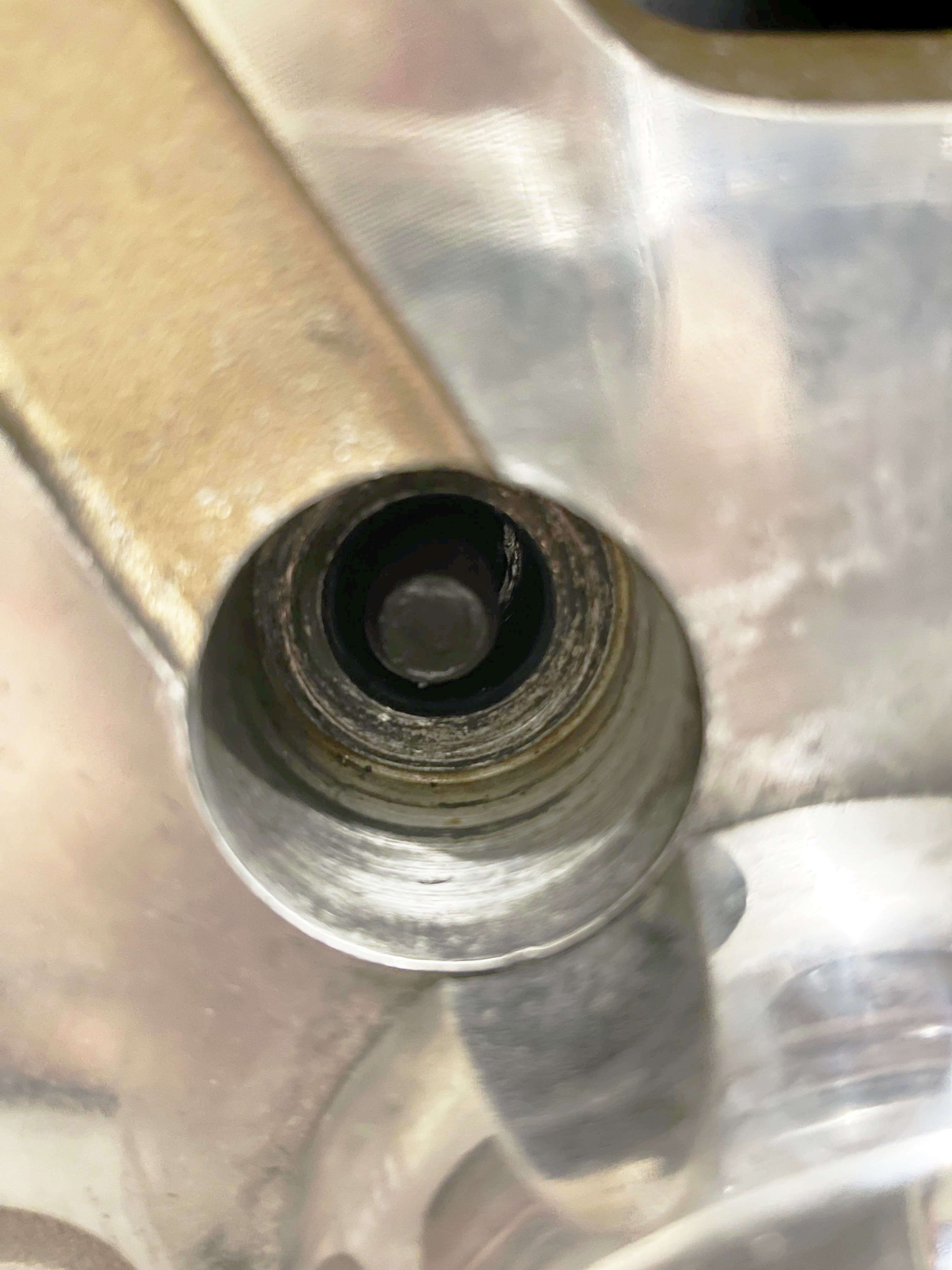

UPDATE: I may be onto something here.
I pulled one lug with the car on the ground (flat with washer style) and noticed even though the zx wheels are not acorn style, they were NOT keeping the hub stud centered in the wheel so even though the wheels/tires are balanced, they are not centered on the hub overall probably causing the shake.
Thinking back, I tried my friends new wheels and tires with his acorn nuts years ago with no shake but tried my other friend's wheels a few weeks ago with my lugs and got a shake.
I will get acorn style nuts within the next few weeks and see what happens, but I think we may be onto something here.
UPDATE: for all those having issues, give this test a shot: jack up a wheel and spin it - you may also have my issue which is the lugs not in the right way/wrong lugs/bad lug holes/out of round tires/etc because you can see in the below the video the tire not spinning uniformly.  I did this for all 4 tires and swapped the best up front which helped my wobble by 80%.
Going to try new lugs in a few weeks after travel though too
