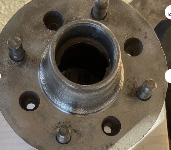

What centers the wheel on a Datsun? The hub bore or the lug nuts? I had always thought the lug nuts centered the wheel. If thats the case the hub or wheel could be relieved so it sits flush. If thats not the case then it gets tougher and the machining needs to be more precise
I know Z cars are lug centric and not hub centric. If the wheel is less than 73mm then in that case means the wheels wont sit completely flush against the hub? Or am I missing something.
Seems unlikely that 0.4 mm would be a factor but it should be easy to find out.  There should be damage on the inside edge of the wheel where it was crushed against the hub weld.  If you see damage, you should be able to file away 0.2 mm around the inner edge of the wheel hole to create a clearance chamfer easily.  A few swipes with a round file.
The pattern on the back of the wheel is also a good indicator of seating.  The spot behind the lug nuts is where the force is.

One thing I will say is on the driver side I can here a slight click or tap noise when moving the tire in the same manner if you were to check for wheel bearings. However I cannot get that noise with the wheel off the car. This might be leading me to believe that the wheel studs might be ever so slightly too long and the lug nuts aren't 100% pressed against the wheel to the hub. The car has extended studs and were cut slightly but maybe they weren't cut enough for the wheels I have. I have a 5mm spacer coming so I can check when that gets here.

Your wheel bearngs are loose.  Even though there is a somewhat complex process for setting tapered wheel bearing preload, you can get really close just by tightening them by hand.  Pop that cap off and turn the nut until it's hand tight.
Your aftermarket lugs are so long it wouldn't be a surprise if they were bottoming out in the nut. That rust and corrosion on the hub should not be there, where the nut is supposed to be clamping the wheel down.  That's a sign that the wheel is not seating on the hub.
