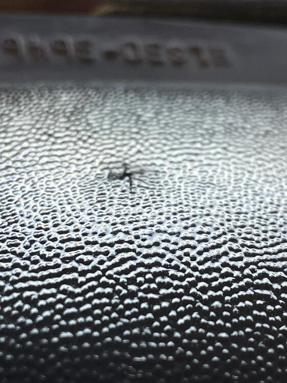

Posted April 19, 20223 yr comment_639458 I just noticed a small “bugsplat” crack forming on my original dash. what can I do to prevent further damage to this dash? The rest of the dash is pristine. Link to comment https://www.classiczcars.com/forums/topic/67423-original-dash-beginning-to-crack-advice/ Share on other sites More sharing options...
April 19, 20223 yr comment_639462 1 hour ago, MM569457 said: I just noticed a small “bugsplat” crack forming on my original dash. what can I do to prevent further damage to this dash? The rest of the dash is pristine. Decades ago when my dash started to crack, I drilled a small hole at the end of the crack. I was an aircraft maintenance officer in the Air Force at the time and knew that procedure worked well on C-130s when sheet metal cracked. So, I gave it a try. The dash is still in my Z. The crack eventually got bigger over the years. But, the "stop drill" procedure worked for years. Good luck with whatever you decide to do to save the dash. They all have a "Best By" date. Link to comment https://www.classiczcars.com/forums/topic/67423-original-dash-beginning-to-crack-advice/#findComment-639462 Share on other sites More sharing options...

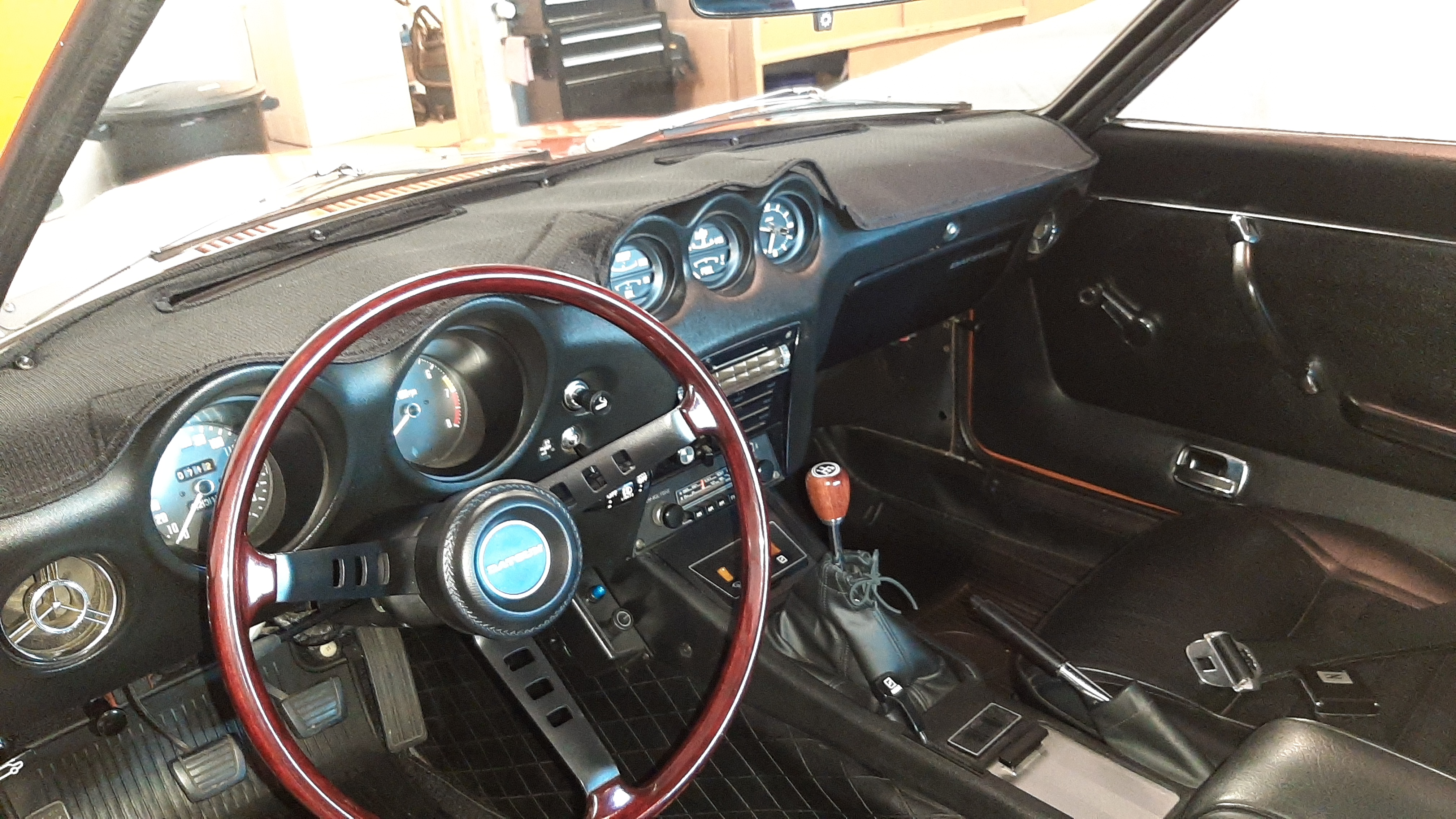

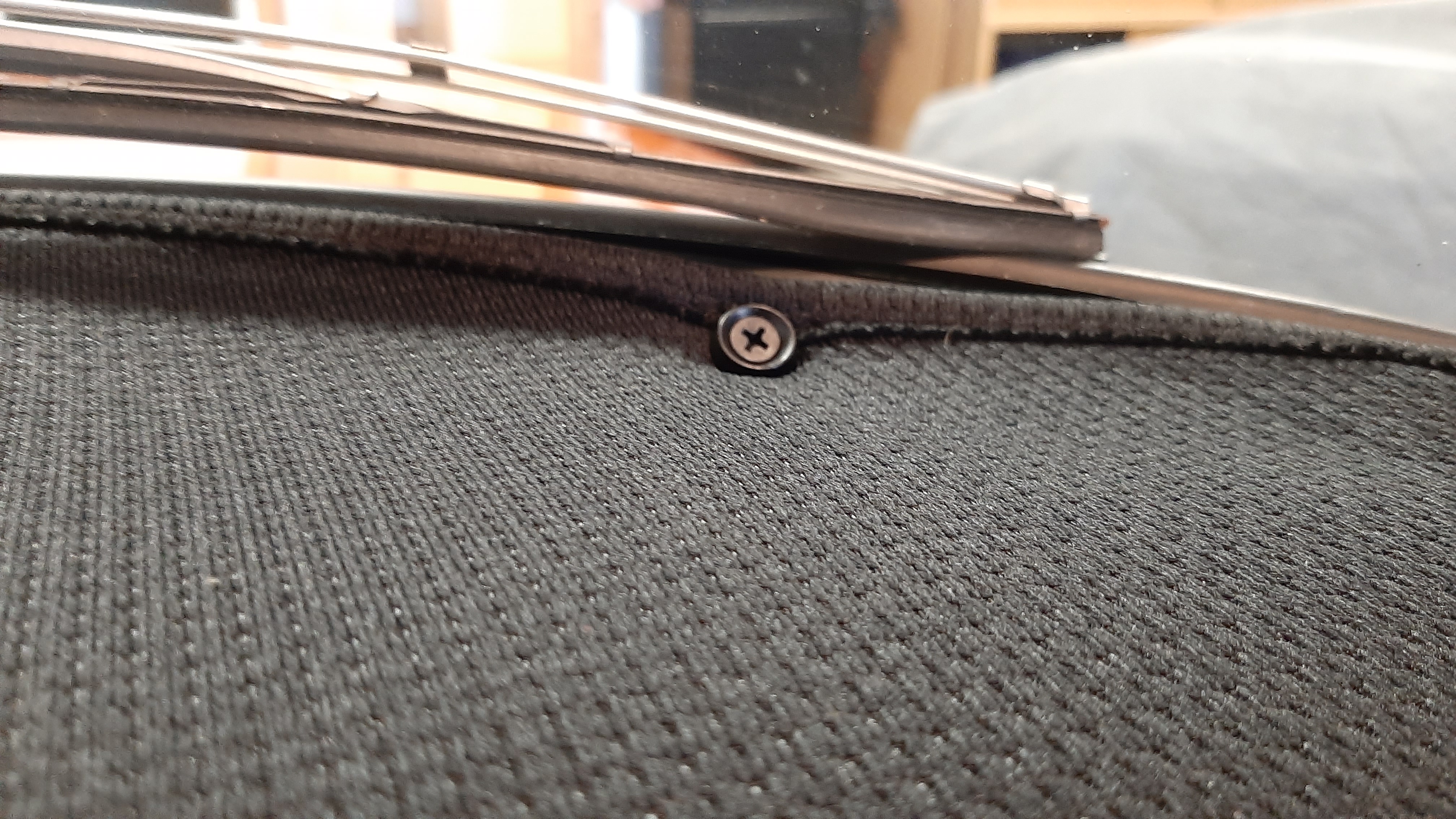

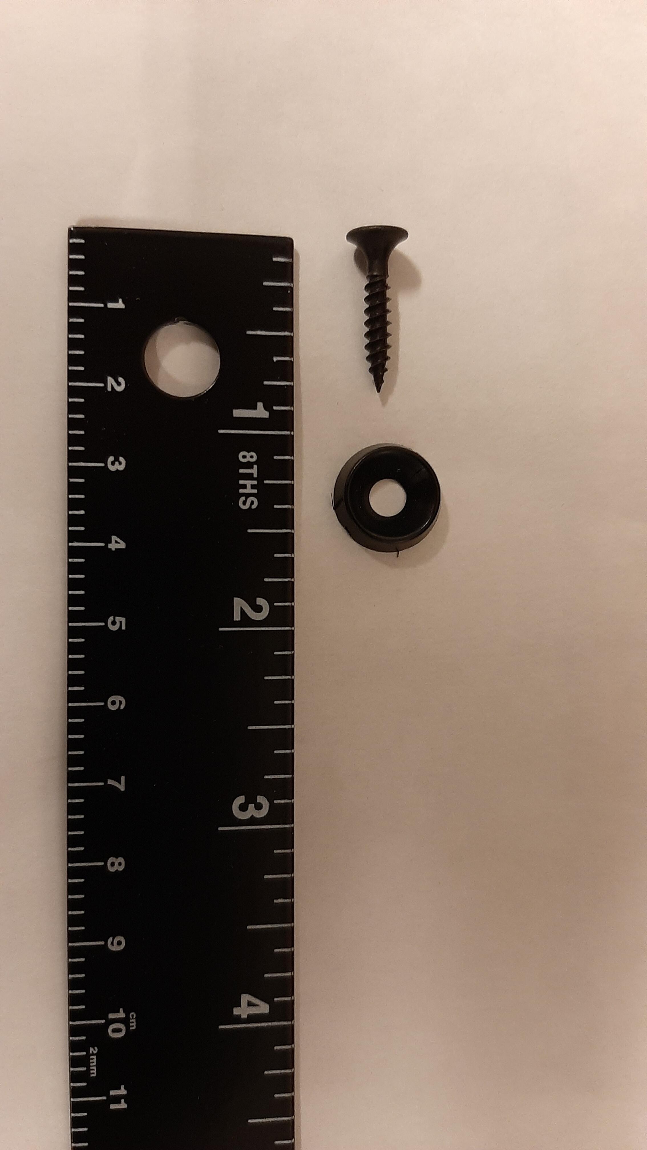

November 27, 20222 yr comment_647598 I am fortunate to have an uncracked dash and even a working clock on my '72. My dilemma is wanting to keep my dash protected, but not resort to a cap or fabric mat that would require any adhesive or Velcro applied directly to the dash. The solution I went with was to purchase some black plastic grommets and long black sheet metal screws. I burned a few holes in a carpeted dashmat with a soldering iron and then used the grommets and longer screws in place of the fasteners used to keep the windshield defrost vent cover in place. It turned out well. The mat remains securely in place while driving and nothing is stuck directly to the dash itself. Link to comment https://www.classiczcars.com/forums/topic/67423-original-dash-beginning-to-crack-advice/#findComment-647598 Share on other sites More sharing options...
