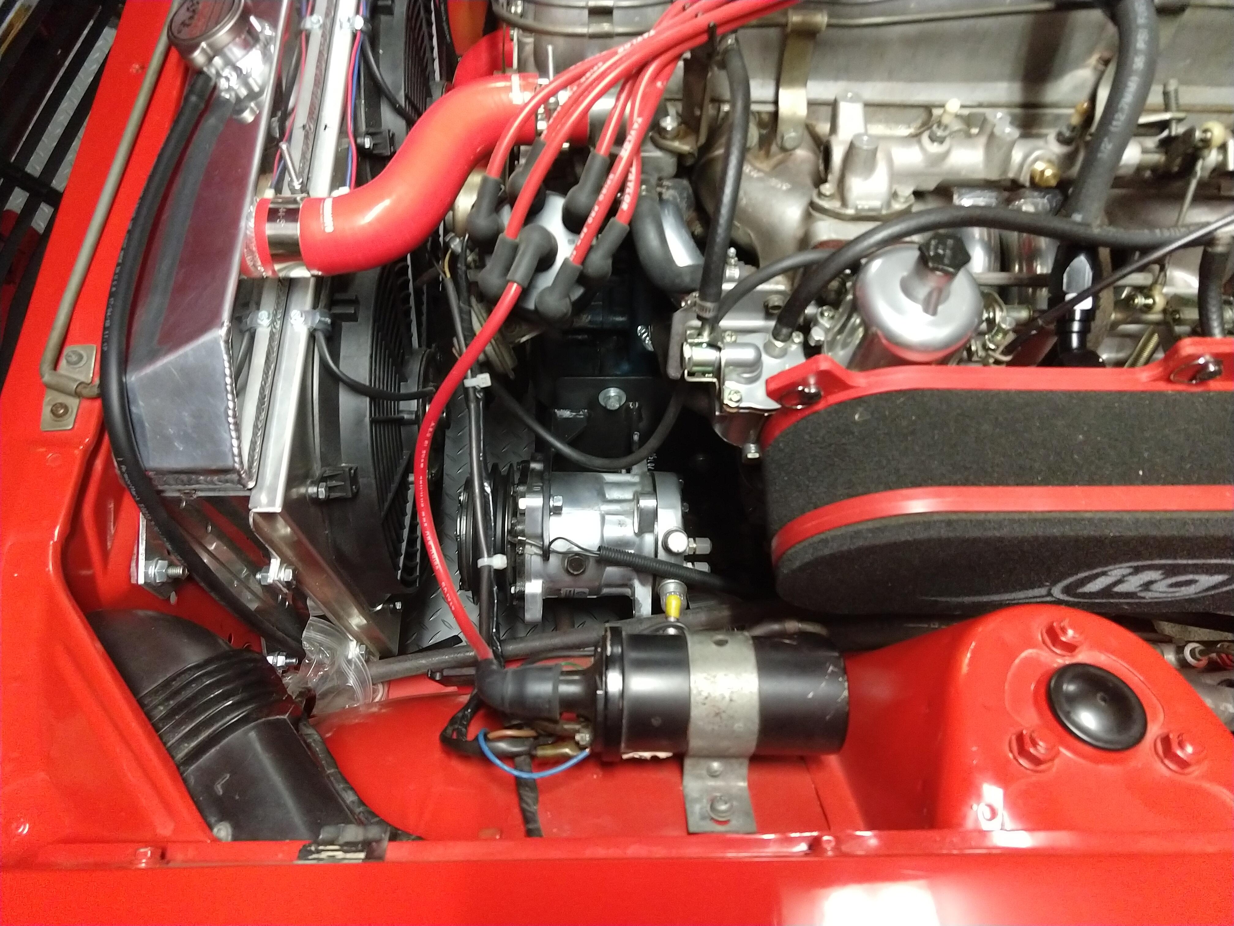

I did the 3 row aluminum from MSA. No tab bending, just bolted right in with no adjustment on my 71 240Z.
Motorsport! Aluminum Radiator, 3-Row, 70-8/74 240Z-260Z - The Z Store! Nissan-Datsun 240Z 260Z 280Z 280ZX 300ZX ( Z31 Z32 ) 350Z 370Z Parts
I've had no trouble with it since I put it in.
