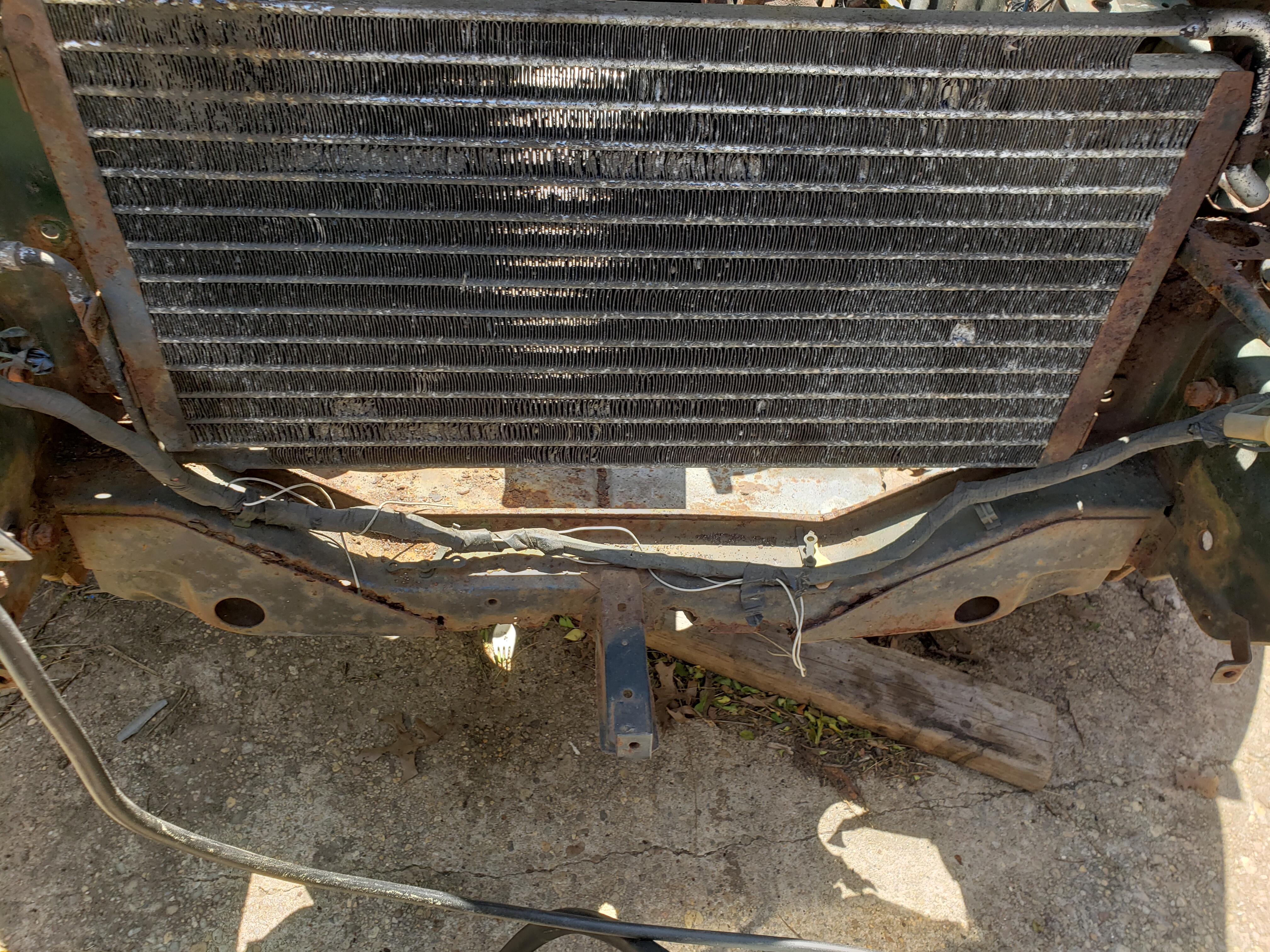

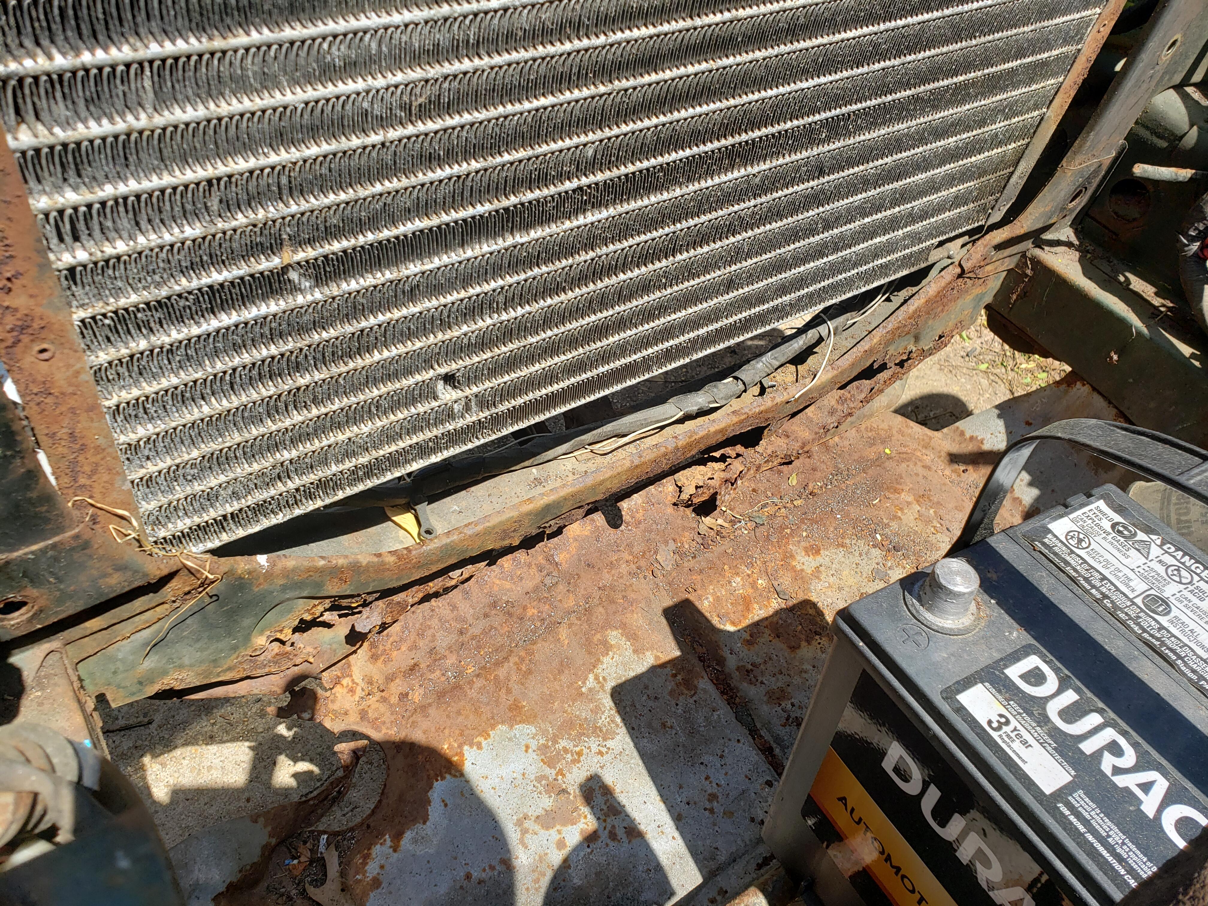

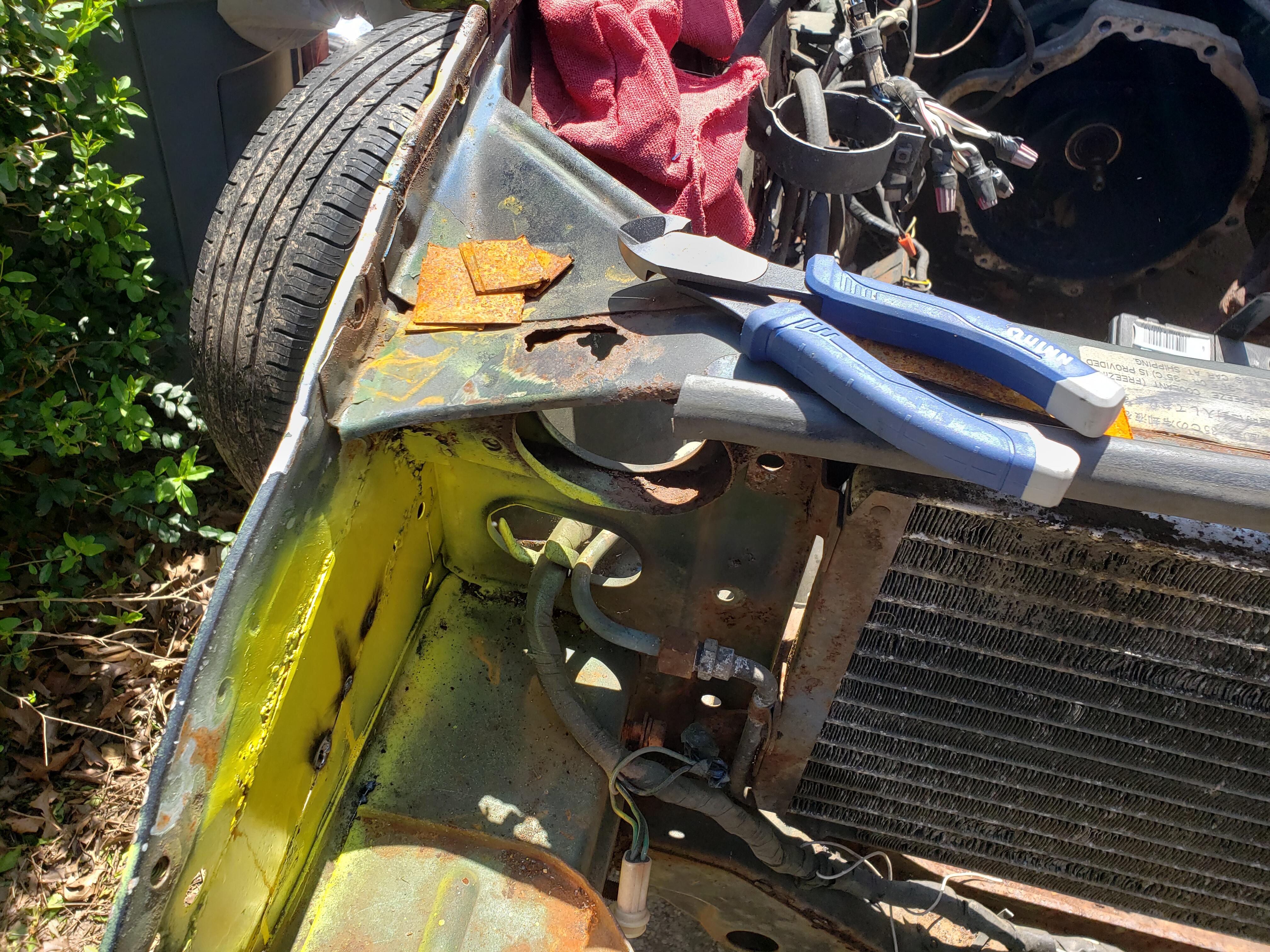

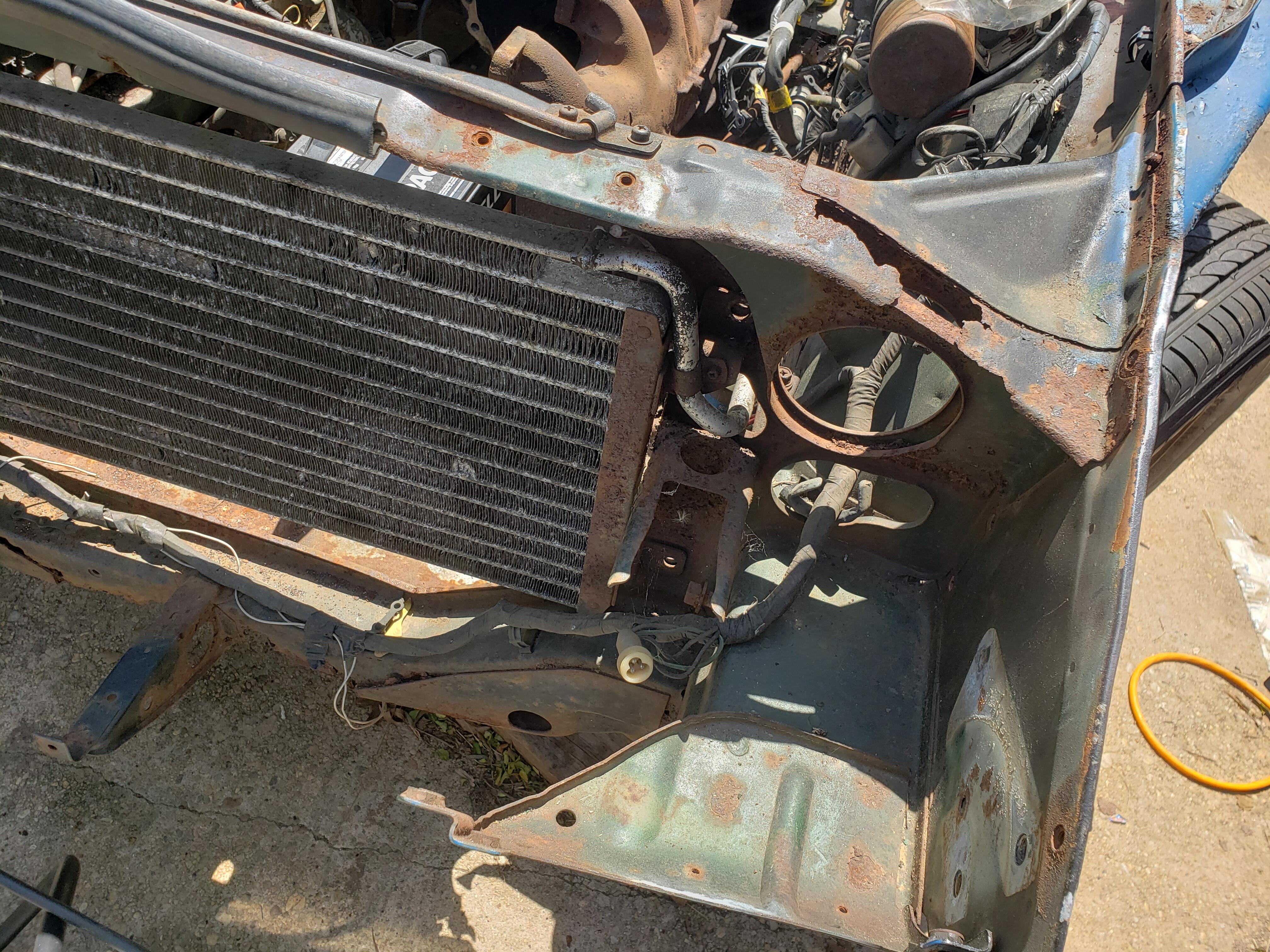

Oh, in that case...
I think I would buy the 240Z parts you were looking at - and use a 240Z Koyo radiator. That's what I'm using in my turbo-swapped early 260 (which has a 240Z style core support - they changed that design with the late 260Z->280Z). Great radiator even with A/C running in Phoenix and I daily drive Goldie.
That's if you can't find a 280Z front end to remove from another shell. From the pics, you could use a bit more than just the core support.
