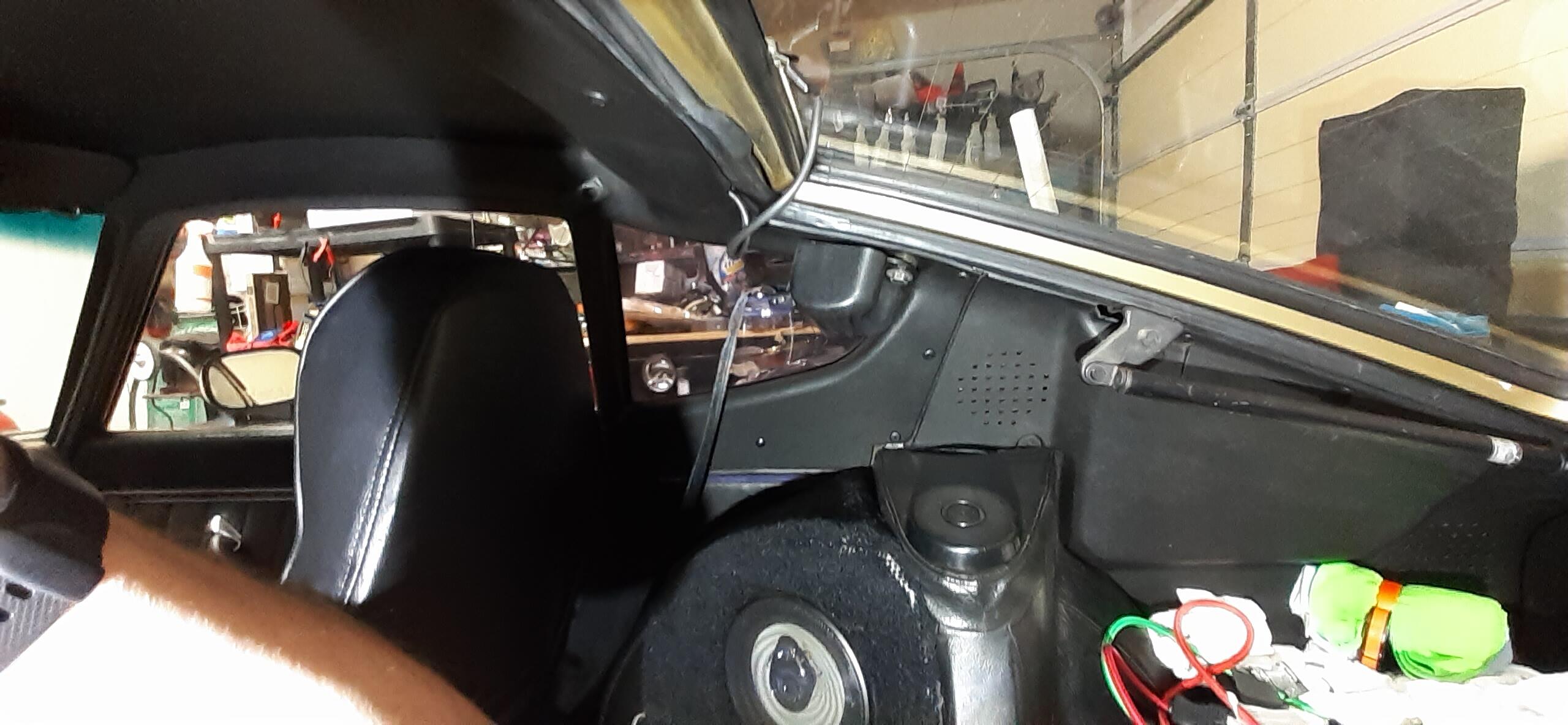

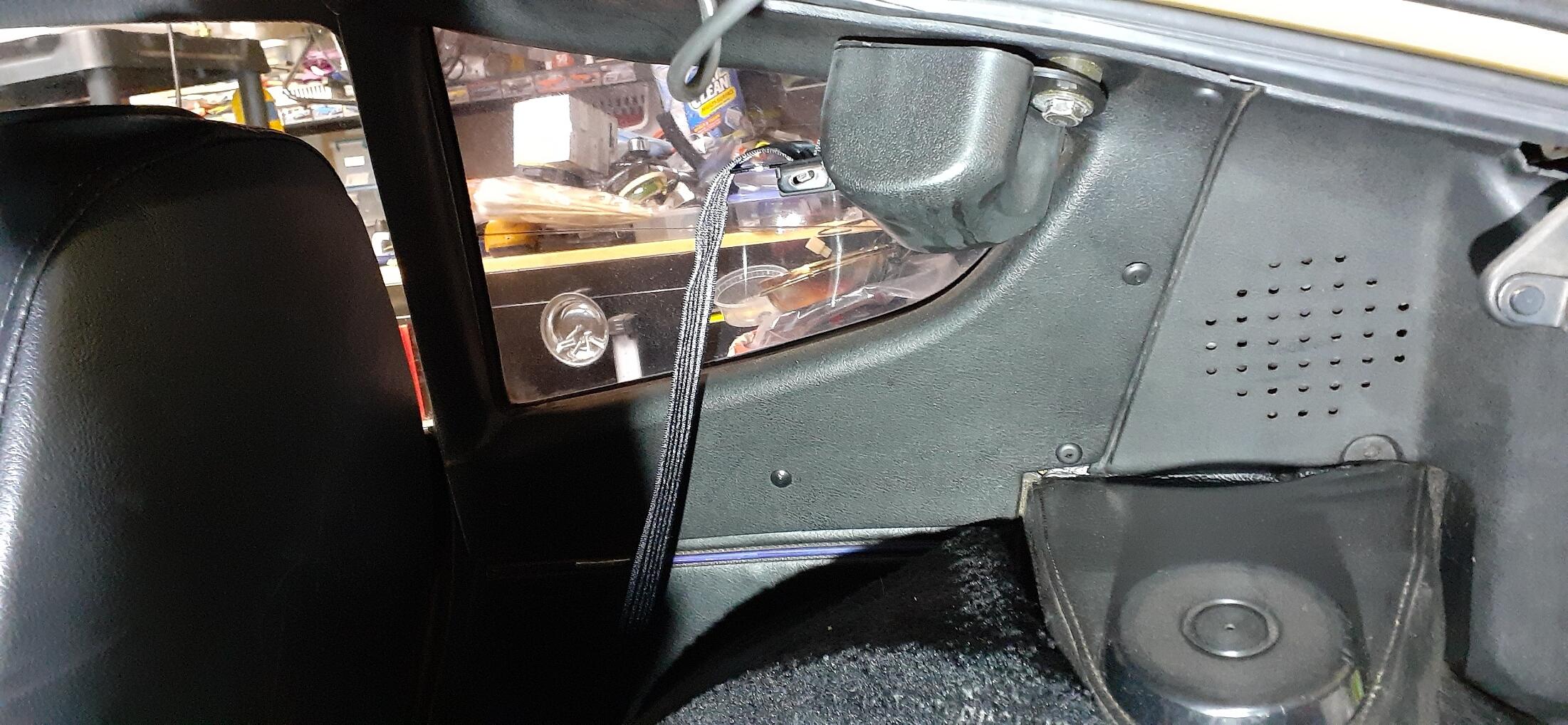

@SteveJ do you have pictures of how your retractor is attached? The retractor on those roadster belts (from the pictures at least) look very similar to what I've got and I can't mount that on the roof mount unless it's rotated a lot which seems bad
Thank you! Mine look very similar so I might just need a spacer to make it work.
I have some other good news on the seat rail too I think because the retractor was blocking it a ton of gunk had built up so it seemed like the rail couldn't go back all the way. After using some persuasion and greasing it up I can get the rails to travel the full length now. With the retractor removed and the seat reinstalled I get much more reasonable leg room. I might try and adjust the pedals to be a little further back but it's much better than it was.
I just need to figure out a solution for the seatbelt and i should be good to go
Rotating the seat belt harness around and adjusting the bracket a bit it fits with the seat all the way back. I'm not in love with it but I at least have something that works.
The seat belt rubs against the rear storage lip a bit more than I'd like, so I'm still thinking about some alternate solutions, but I've at least got something working for now
