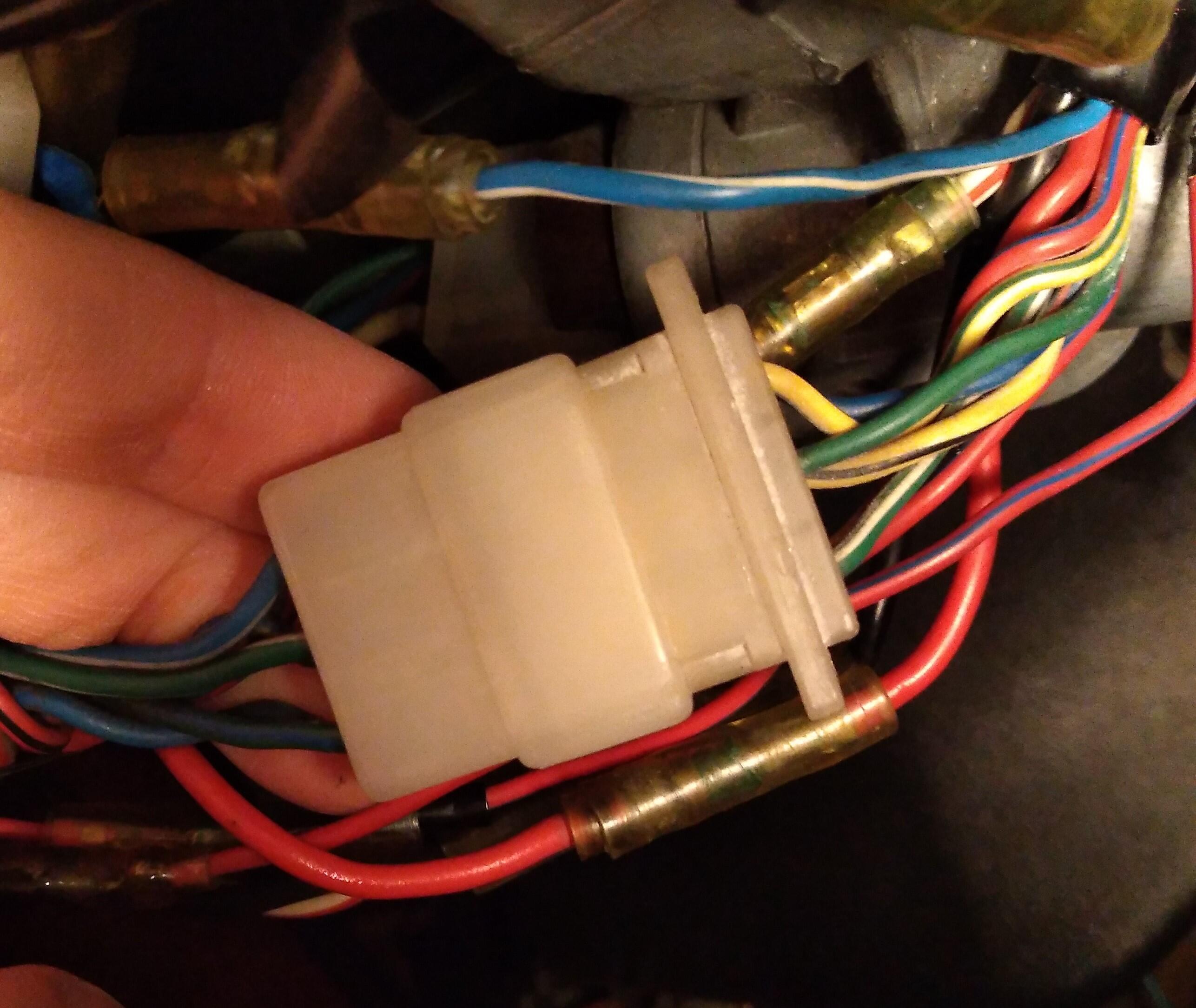

What makes it even MORE confusing is the fact that the wires change color as they pass through the 6-pin connector under the steering column:
Right side is up to the combo switch, left side is into the dash.  Notice how the green/blue on the right changes to green/white on the dash harness, and the green/white from the combo switch goes the other way.  That's probably why the last round of measurements seemed backward.
