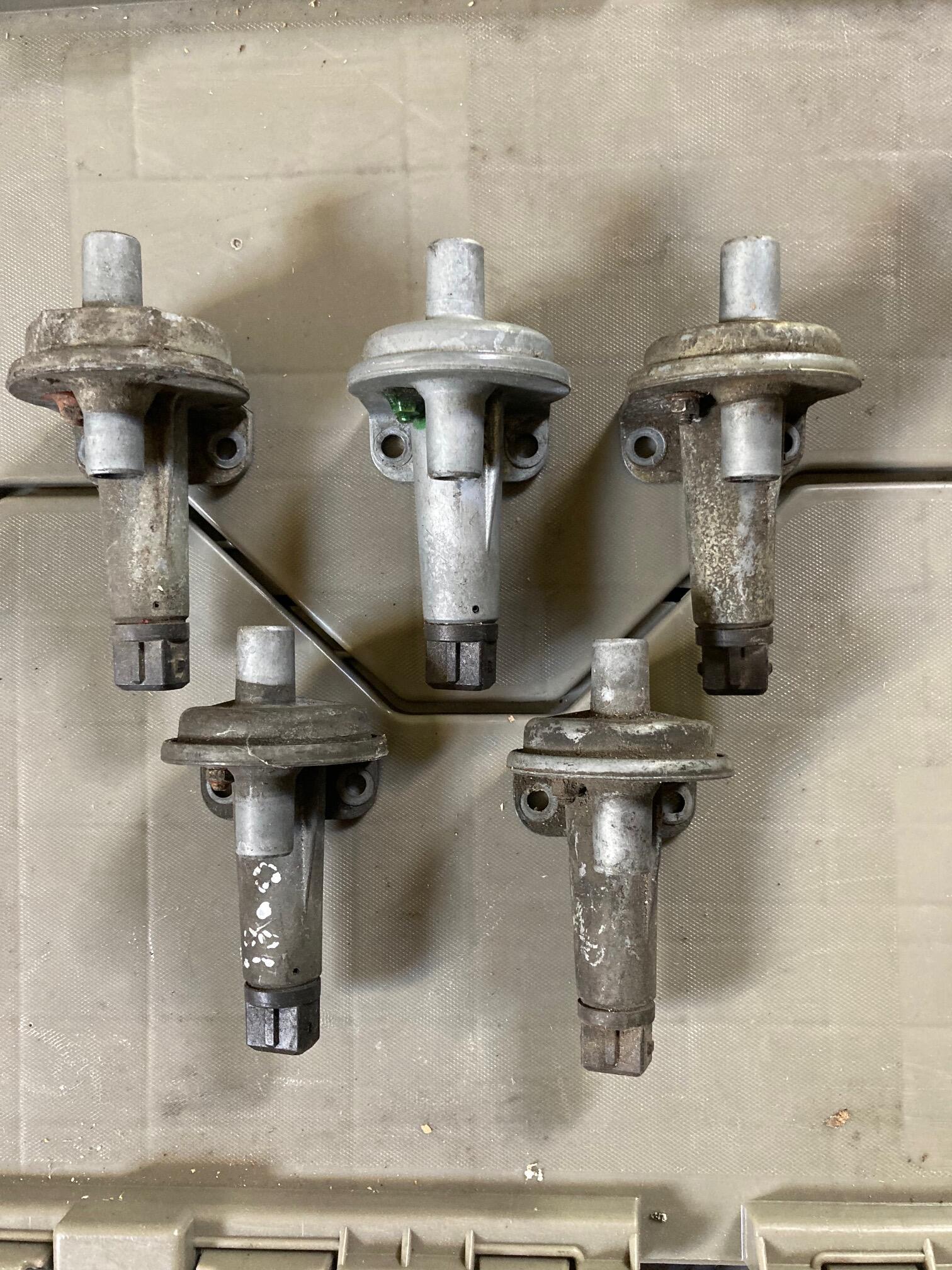

May 9, 20222 yr comment_640220 Some used options..... Link to comment https://www.classiczcars.com/forums/topic/67452-narrowing-down-my-faulty-cold-idle-problem-where-to-get-a-replacement/?&page=2#findComment-640220 Share on other sites More sharing options...

May 10, 20222 yr comment_640229 3 hours ago, Terrapin Z said: Some used options..... Have you tested these? I'd guess yes, since you're a Z aficionado, but confirmation is always good. That middle one is pretty shiny. Nice arrangement. Link to comment https://www.classiczcars.com/forums/topic/67452-narrowing-down-my-faulty-cold-idle-problem-where-to-get-a-replacement/?&page=2#findComment-640229 Share on other sites More sharing options...
May 10, 20222 yr comment_640234 9 hours ago, Zed Head said: Have you tested these? I'd guess yes, since you're a Z aficionado, but confirmation is always good. That middle one is pretty shiny. Nice arrangement. My test battery was low on charge so I plugged it in overnight. I will test a few of these this afternoon and see how well they move. I did notice there are different numbers on them but I am pretty sure they are all the same. The clean looking one is A32-000000 I did not think these were rebuildable like Killain is mentioning. I thought you just replied them with a new, or known working one via the 12v test. Link to comment https://www.classiczcars.com/forums/topic/67452-narrowing-down-my-faulty-cold-idle-problem-where-to-get-a-replacement/?&page=2#findComment-640234 Share on other sites More sharing options...
