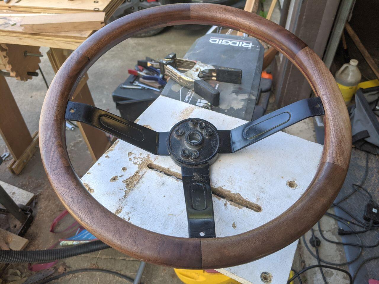

May 13, 20222 yr comment_640335 I put the "wood" steering wheel on my 260z but it was too thin for my tastes. I purchased an old Nissan wheel with heavily deteriorated foam covering and made a black walnut steering wheel out of it. Link to comment https://www.classiczcars.com/forums/topic/67474-280z-steering-wheel/#findComment-640335 Share on other sites More sharing options...

May 13, 20222 yr comment_640339 On 5/13/2022 at 1:50 AM, Jeff Berk said: I put the "wood" me too... I see that you made it exactly like me! ( in 2007) was i your inspiration or...? exactly same system, 6 on front parts and 6 on the rear, i made the front parts over the steel inner ring.. the rear parts are massive. (mahogany wood) I also did this because of my big hands.. i had no fun with the tiny orig. 240z wheel.. (iirc, i had this "making of a steeringwheel"explaned somewhere on this site i believe.. 🤔 Link to comment https://www.classiczcars.com/forums/topic/67474-280z-steering-wheel/#findComment-640339 Share on other sites More sharing options...

May 13, 20222 yr comment_640345 On 5/13/2022 at 1:50 AM, Jeff Berk said: I put the "wood" steering wheel on my 260z but it was too thin for my tastes. I purchased an old Nissan wheel with heavily deteriorated foam covering and made a black walnut steering wheel out of it. There is a guy on Ratsun, who lives in Texas, that has made a few wood rims for steering wheels. It is a fairly straightforward process. Make a circular jig for a router, select a nice cut of wood, rout the two halves, glue them onto the rim, and finish the wood. One he laminated several different types of wood stained different colors. It looks awesome. He even made a matching shift knob. Check it out here: https://ratsun.net/topic/78921-diy-steering-wheels/#comment-1700673 Edited May 13, 20222 yr by Racer X Link to comment https://www.classiczcars.com/forums/topic/67474-280z-steering-wheel/#findComment-640345 Share on other sites More sharing options...
May 14, 20222 yr comment_640375 On 5/13/2022 at 2:25 PM, Racer X said: glue them onto the rim, Use 2 component glue between the steel and the wood.. and .. use some professional wood glue between the wood. think that's the best way. On 5/13/2022 at 2:25 PM, Racer X said: He even made a matching shift knob. That's what i did TO!! (Also out of mahogany!) (They are in my 240z now for 15 years and working perfect.) Link to comment https://www.classiczcars.com/forums/topic/67474-280z-steering-wheel/#findComment-640375 Share on other sites More sharing options...
