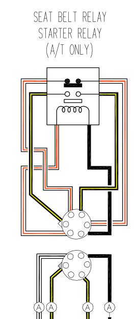

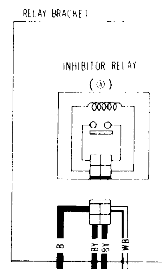

FSM wiring versus Revision N wiring.

The starter solenoid power wire does not pass through the ignition relay.  You bypassed the ignition switch and the inhibitor relay.
The cranking circuit is completely separate from the ignition circuit.  You have a cranking problem, not an ignition problem.

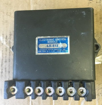

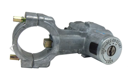

Just for fun and because the wrong words were used early on.  Here are the three parts with "ignition" in their name - ignition switch, ignition relay, and ignition module.
From ZCD -
Autopartone -
From Vintage z parts -

Also, why do u say the ignition relay is not in the starter circuit? The FSM page i posted clearly says there are 3 parts of the starter circuit Starter Relay, Ignition Relay (not Module - correction) and Inhibitor switch.

1 minute ago, MH77280Z said:
Also, why do u say the ignition relay is not in the starter circuit? The FSM page i posted clearly says there are 3 parts of the starter Starter Relay, Ignition Module and Inhibitor switch.
You have interchanged the words "ignition relay" and "ignition module" again.  Relay and module are two separate things.  Even so, cranking and running involve separate parts.

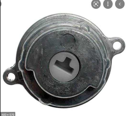

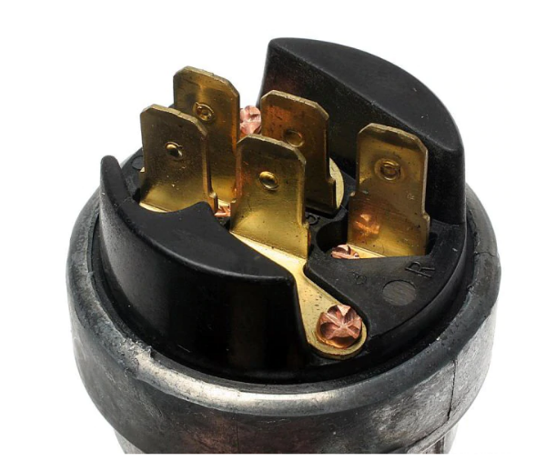

One possibility that might fit your problem is that the mechanical part of the ignition switch is not correct.  I had a situation where I had to twist the rod between the mechanical part and the electrical part to get the electrical switch to turn far enough.  That might explain why when you changed the switch it worked for a short while.
The rod that fits in to the plastic slot has to turn the switch to the correct position.  You can test it by disassembling the switch and turning it by screwdriver.  You might find that everything works fine -
49 minutes ago, Zed Head said:
Leave it plugged in use a screwdriver to turn it.
Just tried this procedure on the new ignition SWITCH (pic above) and same effect.
What is the best way to test the seat belt relay function here?

That is not an ignition module.  It's an ignition switch.
  https://www.carparts.com/details/Nissan/280Z/Beck_Arnley/Ignition_Switch/1977/201-1174.html
Find it, unplug it, test the proper wires for voltage with the key at Start.
