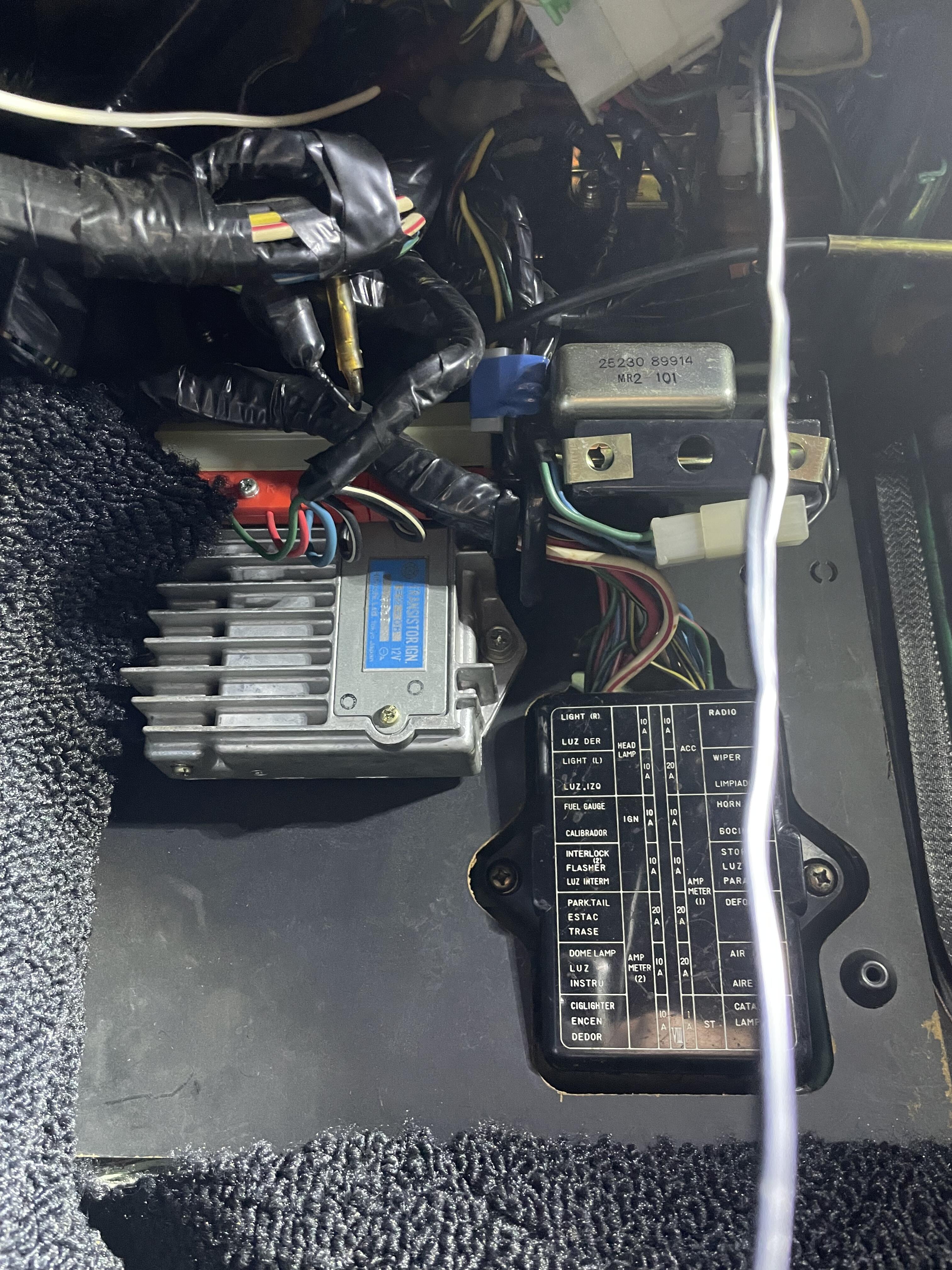

Thanks for prompt reply. I soldered in a 1/2W 10k resister off coil to tach. My car has been converted to carbs prior to me and a lot of wiring is from that conversion. Here is a pic of area of TIU.

So if you converted to a ZX distributor, why did you leave the TIU in place? It should go bye-bye.
Also why did you solder in a 10K ohm resistor? The value should be 2.2K ohm if I remember correctly, though on a Google search @Zed Head gave a value of 2.3k on another thread. Double check the FSM. I know it has the value.
Av8ferg solved his problem in this thread by swapping coils.  Not really clear why that worked but it did.
Like SteveJ says though, the old TIU should be completely disconnected.  The wire to the tachometer is a branch off of the blue wire from the engine bay.  It does not run through the old module.  And the 2.2 kohm resistor is in-line buried in the wiring on the way to the tachometer.  You should be able to just connect the blue wire in the engine bay to the coil negative, disconnect the old module, and have everything working correctly.
Just to complete the explanation, the TIU does the same thing as the "matchbox" module on the ZX distributor.
Several years ago, a friend did a ZX distributor conversion on a 260Z and brought the car to me because it wasn't running right. The first question I had was, "Did you disconnect the TIU?" After he unplugged it, the car ran like a scalded dog.
Verify that the stock resistor is still in place.  It should reside in the passenger footwell and plug into the wiring harness.

There's no need to get it out.  Just verify that the lump is there.  If the tape is unmolested you migth as well leave it.
Remove all of the existing wrongness and see where you're at.
