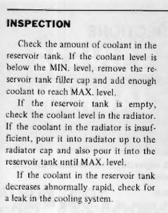

I'm actually more concerned that your bottle was ever completely dry. That should not be the case.

After I changed the radiator, I had enough coolant to fill the radiator to the top but not enough for the bottle.  I figured the radiator would fill the bottle if the engine got warm enough so I didn't get more coolant.  Is that not the case?
