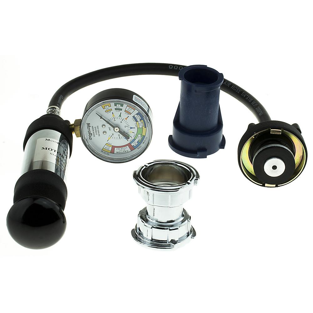

November 20, 20222 yr comment_647371 12 minutes ago, chaseincats said: The car has a new radiator and water pump and before I did that, I flushed out the rust (in theory) with the radiator flush chemical a few times and did the old 'hose in the thermostat housing' routine. I just went through the whole thread, and see all the stuff you have done. The only two things that I don’t see that haven’t been done, and should have been done first, is a system pressure test, and check the radiator cap for pressure. Use a cooling system pressure tester to pressurize the system and then watch to see if it holds pressure. It can also be used to check the radiator cap. Local parts stores rent them if you don’t wish to purchase one. I have found two at garage sales for a couple of bucks. If there is a loss of pressure, the cause needs to be found and corrected. Sometimes it is simply a loose hose clamp, but it could also be a failing head gasket. There has been discussion about the boiling point of water, and the boiling point of the coolant mixture, but no one has mentioned that the boiling point is raised buy increasing pressure in the cooling system. I forget the precise numbers, but that is the function of the radiator cap, to increase pressure and raise the boiling point. This helps the coolant to carry the heat to the radiator, which then dissipates the heat befor the coolant is returned to the engine to collect more heat. Also, are you using ordinary tap water, or distilled water. Tap water will have minerals, and even worse in your area, iron. This leads to excess scale and rust in the cooling passages, and contributes to electrolysis. Link to comment https://www.classiczcars.com/forums/topic/67498-not-quite-overheating/?&page=5#findComment-647371 Share on other sites More sharing options...
November 21, 20222 yr Author comment_647391 8 hours ago, Racer X said: I just went through the whole thread, and see all the stuff you have done. The only two things that I don’t see that haven’t been done, and should have been done first, is a system pressure test, and check the radiator cap for pressure. Use a cooling system pressure tester to pressurize the system and then watch to see if it holds pressure. It can also be used to check the radiator cap. Local parts stores rent them if you don’t wish to purchase one. I have found two at garage sales for a couple of bucks. If there is a loss of pressure, the cause needs to be found and corrected. Sometimes it is simply a loose hose clamp, but it could also be a failing head gasket. There has been discussion about the boiling point of water, and the boiling point of the coolant mixture, but no one has mentioned that the boiling point is raised buy increasing pressure in the cooling system. I forget the precise numbers, but that is the function of the radiator cap, to increase pressure and raise the boiling point. This helps the coolant to carry the heat to the radiator, which then dissipates the heat befor the coolant is returned to the engine to collect more heat. Also, are you using ordinary tap water, or distilled water. Tap water will have minerals, and even worse in your area, iron. This leads to excess scale and rust in the cooling passages, and contributes to electrolysis. Good catch, I should have added that I did pressure test the cooling system and radiator cap when I installed all of that new hardware a few months ago. I also did a leak-down test yesterday and besides finding out I have a few tired piston rings, I confirmed there isn't any combustion gas leaking into the coolant. Link to comment https://www.classiczcars.com/forums/topic/67498-not-quite-overheating/?&page=5#findComment-647391 Share on other sites More sharing options...

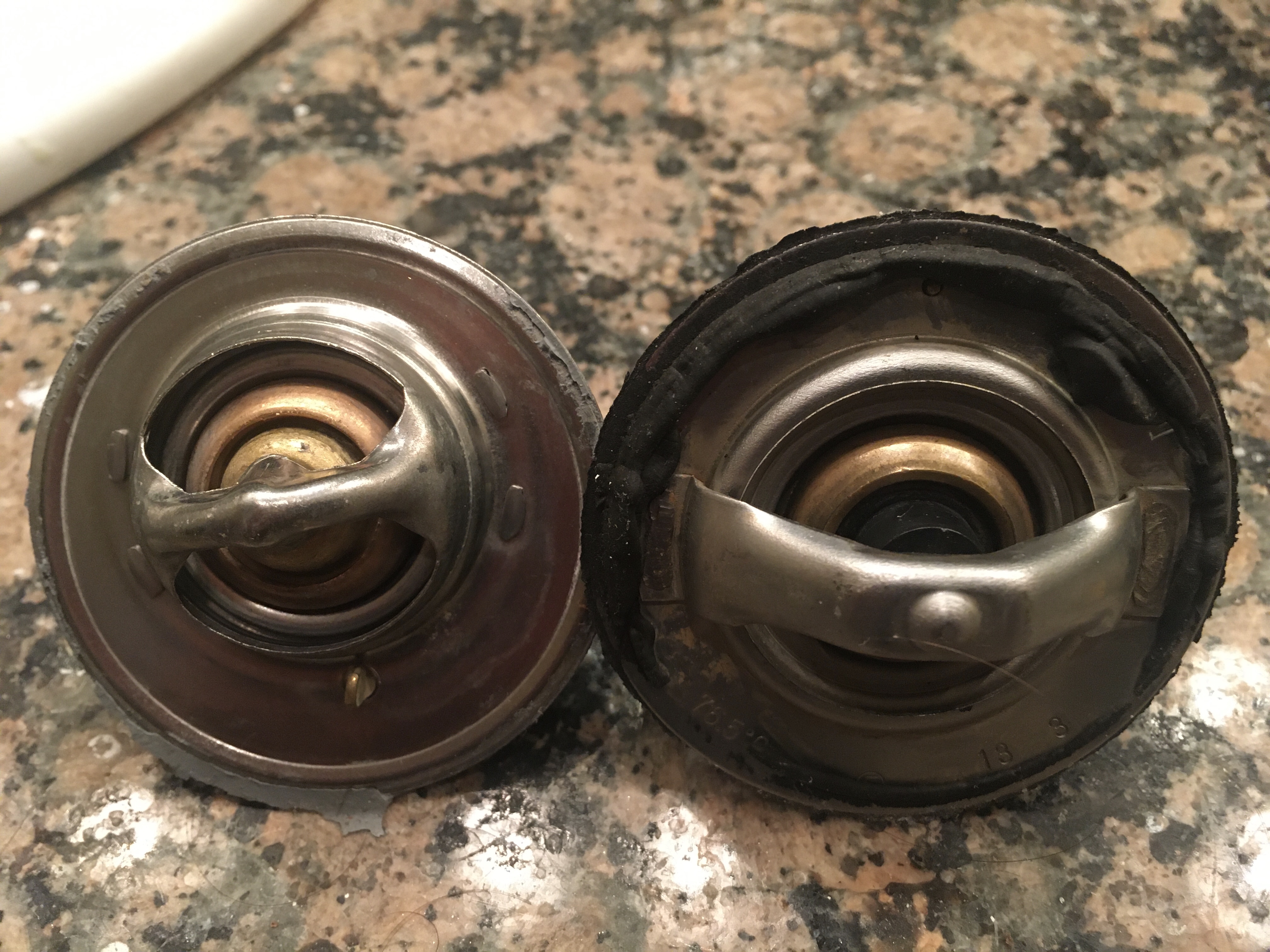

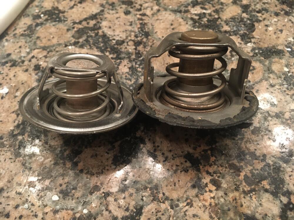

December 12, 20222 yr Author comment_648154 UPDATE: I spoke with my old Z mechanic to see where he got the OEM thermostat that was in the car before my changeover to the new aftermarket one earlier this year since OEM ones are supposedly NLA. It turns out Nissan still makes a thermostat that works but is not the original one designated for the car. This thermostat is a Nissan part (part number 21200-F3190) but works in a bunch of their engines (L-series included). This is the thermostat that held the car's temperature at 170 from 2015-2020 before I started having cooling issues. I threw the old and new OEM thermostats as well as the aftermarket one in a pot of water. The old OEM thermostat started opening at 185 (unlike the new OEM one which opened around 170) and after continuing to heat the pot, the old OEM thermostat only ended up opening about 2/3's as much as the new OEM thermostat so the old OEM thermostat was indeed bad. The aftermarket one opened and closed at the same temperatures as the new OEM thermostat but the opening indeed is about 30% smaller than the OEM thermostat and the amount of travel the plunger can physically move is again maybe 30% less due to it being physically shorter. I have not tried the new thermostat in the car because driving it around in this cold weather won't give me a definitive answer, but I am feeling confident that my old worn-out OEM thermostat not opening at the right temperature (and not to the right amount) started this issue, and installing an aftermarket thermostat that physically can't move as much coolant as an OEM one kept me heating up, but for for a different reason entirely. With the new OEM thermostat correcting both issues, we should be all set come spring time. Here are pictures of the OEM one (right side) next to the aftermarket one (left side). You can see the opening is considerably smaller and plunger's travel is considerably shorter on the aftermarket unit. I will update you guys in the spring. I don't understand how/why they sell this design... Edited December 12, 20222 yr by chaseincats Link to comment https://www.classiczcars.com/forums/topic/67498-not-quite-overheating/?&page=5#findComment-648154 Share on other sites More sharing options...
