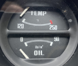

Hey gang, got an odd one for you.
My car used to sit rock solid at 170 (has a 170 degree thermostat) but within the past year that's become more variable depending on if I'm sitting idle or driving.  If sitting idle in 95 degree weather, it will go a little past half which I know isn't bad but the fact that it used to sit rock-solid at 170 regardless of weather tells me there's something wrong and even though its not severe it's annoying lol.
I've changed the fan clutch, thermostat, water pump, checked fanbelt tightness, changed coolant, used a flushing chemical, and even got a brand new radiator but while the temperature isn't moving as much, the needle still moves depending on if idling or driving.  There is definitely rust in the system because the PO used tap water and ever since I got it years ago, its been a game of 'how much rust will come out with this flush' (its always less but there nevertheless).
I've also cleaned the temp gauge harness connector/sensor outlet and nothing has changed.  I'd have thought it was the temp gauge if the car didn't go back to 170 like it used to while driving - but since it does, it tells me the temp gauge hasn't lost calibration and the coolant temperature really is changing.
Any ideas?

I had issues reading temperatures when I first started working on my Z. Sometimes the gauge would work (but give bad readings) and other times it wouldn't move at all. My issue was that my connection to ground wasn't good (due to a cracked thermostat housing). You could run through 50 different temp sensors but if the grounding is bad the readings will never be reliable.

Alright, I'll give that a shot.  Again, it's not about being precise or 'that's a fine temperature.'  The car is running differently than it was before which is indicating there is an issue.  The fact that it is not bad yet doesn't mean the issue should be ignored.
The difference isn't only the temperature it's getting to - the main difference is the temperature flux between idling at a stop light and driving with air through the radiator.  Before this issue started in 2020, the needle got to 170 and never moved regardless of idling at a stoplight or not.

With all respect friend, these gauges are far from precise. New gauges are of course NLA. It would be interesting if you could try another gauge or better yet install a temporary or just take readings from the radiator itself. You might be just chasing a ghost. From what I’ve read in this thread you’re relying on a reading from a 40 plus year old gauge. My 2 cents

Definitely a fair point but I grabbed an IR temp gun and verified that the engine temp was fluctuating and not a goofy gauge 😞
