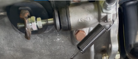

Posted May 29, 20222 yr comment_640993 New day, new saga. I put in a new flywheel, clutch, pressure plate, and throw out bearing. The master cylinder and slave cylinder are also new. When I put the car into gear, with engine not running, and depress the clutch, I cannot roll the car. Apparently, the clutch is not disengaging. I adjusted the slave cylinder quite a bit also. What am I missing? Attached is a video of the slave cylinder in action. IMG_1719.mov Link to comment https://www.classiczcars.com/forums/topic/67529-clutch-wont-disengage/ Share on other sites More sharing options...

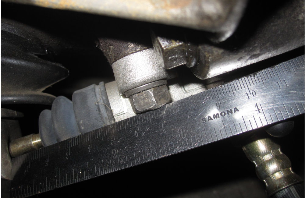

May 29, 20222 yr Author comment_640996 33 minutes ago, Zed Head said: More? What brand of flywheel? The Fidanza sticks sometimes. p.s. did you measure the stack height of the flywheel and throwout bearing? 92 mm. A very common error, mismatching the parts. Funny you ask that. It is a Fidanza and Southbend clutch. I did attempt to take some measurements, not really knowing what I was measuring. I have a pic, I don't know if it's useful or not. Also this is a 72 240Z. Link to comment https://www.classiczcars.com/forums/topic/67529-clutch-wont-disengage/#findComment-640996 Share on other sites More sharing options...

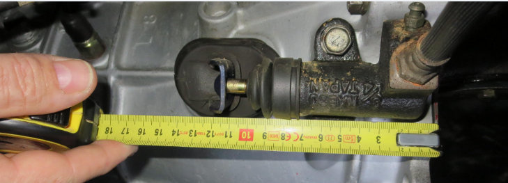

May 29, 20222 yr comment_641000 Here it is. About 6 cm from the flat part of the fork to the edge of the bolt head. Link to comment https://www.classiczcars.com/forums/topic/67529-clutch-wont-disengage/#findComment-641000 Share on other sites More sharing options...
May 29, 20222 yr Author comment_641002 Ok, here is my measurement. EuroDat's spec is 115mm. My measurement seems to be 120mm. This somewhat coincides with my stack height of aprox 88mm. I'm about 5mm away from both methods of measurement. The bigger color is 12mm taller I believe. This is frustrating for sure. Link to comment https://www.classiczcars.com/forums/topic/67529-clutch-wont-disengage/#findComment-641002 Share on other sites More sharing options...
May 29, 20222 yr comment_641005 Extend the rod. Link to comment https://www.classiczcars.com/forums/topic/67529-clutch-wont-disengage/#findComment-641005 Share on other sites More sharing options...
May 30, 20222 yr Author comment_641014 4 hours ago, Zed Head said: Extend the rod. By extend the rod, do you mean adjust the nut out on the slave? On my video, I had the nut adjusted to about 3/4 of the rod length. What do think about my measurements? Link to comment https://www.classiczcars.com/forums/topic/67529-clutch-wont-disengage/#findComment-641014 Share on other sites More sharing options...
