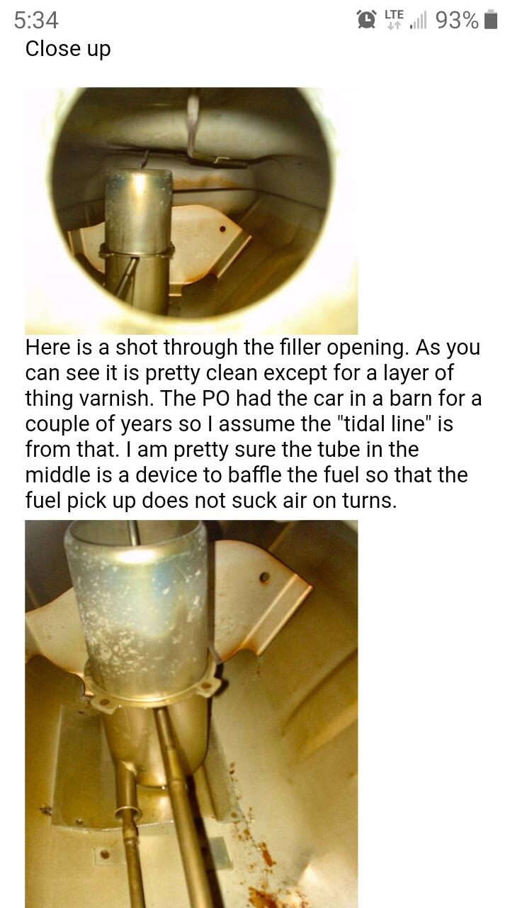

Hi all, would anyone have a picture of the inside of a 280Z fuel tank ? I am in the need to drain my fuel tank, and once drained I planned on removing both the gas cap and the drain plug and leave them both out till the inside of the tank is dry. I have a borescope and once dry I can get a better look inside the tank to see what kind of condition the inside of my 47 year old fuel tank is, is this a good or bad idea ? I never had to deal with a either dirty or contaminated fuel tank, and besides getting the 17 gallons of fuel out, then I need to come up with a strategy on how to remove it while preserving the hoses, nothing on this Z is easily located or priced. I'm changing the fuel pump and the previous owner put a fuel filter inline just before the pump, ( which I reinstalling or a new one) to keep from sucking up dirt into the pump. I haven't found any signs or contamination yet, but . . . .
A little past halfway down of the link I posted earlier.
https://atlanticz.ca/zclub/techtips/fuel/gastank/index.htm
Yes, these are great pictures, I just spoke to the shop doing some of the work, and they said they wouldn't put the rockauto fuel pump on it, it has the original or maybe a factory replacement, but my problem was the hoses ( and they weren't FI hoses, had burst and the pump shut off. So they put new fuel injection hoses on it and put the new filter before the pump, ( and when I told about my fears of a dirty tank, and that the car sat for 13-14 years not used, he said well look, maybe it was stored with real gasoline and if that is the case, the build up of junk on the bottom of the tank might not exist, or at least not to the point of clogging lines or anything, ( the in-line filter they took off did not have any dirt or junk in it? ) Howie also said about my plan to drain the tank and let it dry out, He said don't do that. If you want to see what is on the bottom of the tank, wait till fuel is low, drain the tank, get the borescope and take a look in the tank from the drain plug location, if you don't see any build up of dirt of other junk, put the plug in with some Pematex thread sealant and then refill the tank. You stand to great of a chance of rust if you leave the tank open to the atmosphere which could cause more problems than just a little dirt ? I said to him, the problem with this classic car is you can't have it towed and left sitting at his shop for too long as it can and will get vandalized. Other than the fuel system, I'm trying to get the A/C converted to R-134, something of a formable task here as I live in a Service Desert around here ?????

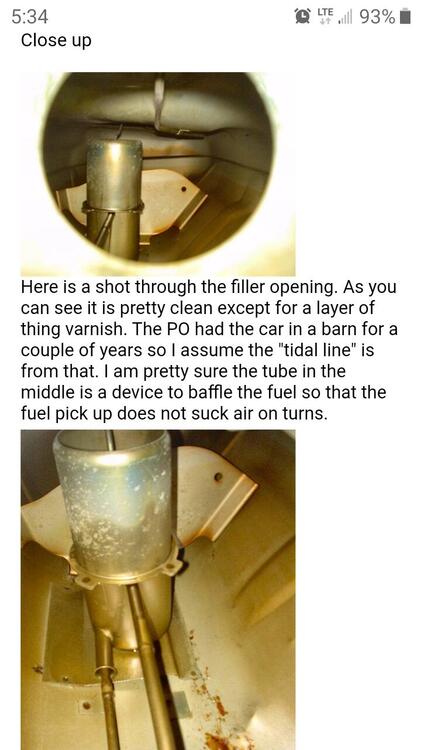

In addition to Clint's reply, ETI4K posted his:
On 6/7/2022 at 5:24 PM, ETI4K said:
Tank is from early production '76 280
In the fuel injected Zs the tanks had screens to reduce debris from getting pumped to the injectors. The holes in the injectors that the fuel sprays from are very small, and clog easily. Clean fuel is very important.
