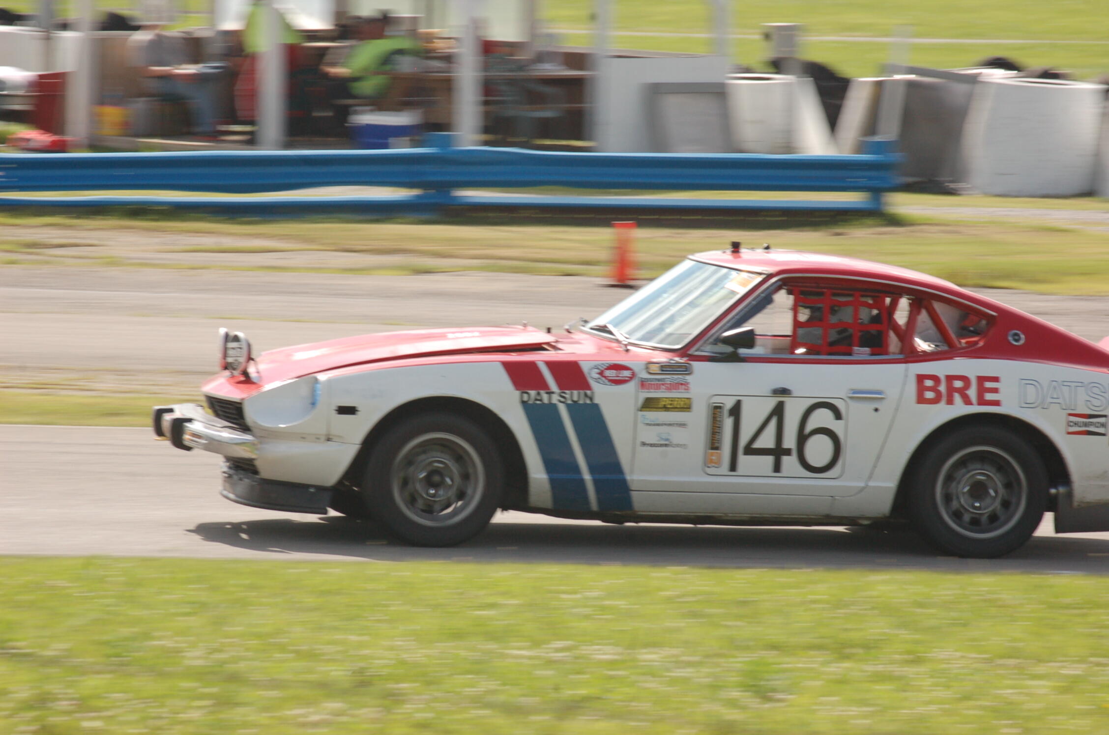

Try this simple test.  Buy about 4 feet of fuel hose and a T fitting to bypass the fuel rail entirely.  Run a hose from the fuel pump output to a T fitting at the front carb and then run hoses from the T to the two carb inlets.  Finally, clamp off the return line with needle nose vice grips so it doesn't drip what's left in the rail.
I had terrible vapor lock issues with my race car and this mod solved the problem after I tried every other possible fix.  Prior to ditching the rail, I also ran an electric fuel pump at the tank mounted on a drop bracket so it was gravity fed from the tank.  Ethanol fuel doesn't like being "pulled".  By being gravity fed, the pump could "push" the fuel to the front of the car.  This helped get the car started hot, but did nothing to fix the vapor lock while on the track.
Different carbs did nothing, shielding the heck out of the exhaust did nothing, eliminating the return line helped a bit, but not enough.
