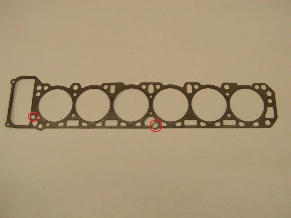

July 6, 20222 yr comment_642083 Melted chocolate ice cream=bad head gasket oil leaking into coolant. There are 2 pressurized oil ports from the block to the head and they have restriction orifice in each. I have circled them in red. Whenever I do a head gasket I use Locktite 515 light coating on the metal reinforced holes I have circled. 515 is Anaerobic (only dried when no oxygen is present). https://www.grainger.com/product/5E226?ef_id=CjwKCAjwwo-WBhAMEiwAV4dybTZyPbY-H5icKkwUzaiPmBp0NjntWAzyiw674kgkAxdh8noJCgWmJBoCWD4QAvD_BwE:G:s&s_kwcid=AL!2966!3!496359974779!!!g!1635640739665!&gucid=N:N:PS:Paid:GGL:CSM-2295:4P7A1P:20501231&gclid=CjwKCAjwwo-WBhAMEiwAV4dybTZyPbY-H5icKkwUzaiPmBp0NjntWAzyiw674kgkAxdh8noJCgWmJBoCWD4QAvD_BwE&gclsrc=aw.ds There are lots of arguments about using gasket sealant on head gaskets for the L28 engine. That's a decision that is up to you. I grew up using aircraft sealant (Permatex Aviation Form-A-Gasket on my head gaskets but most of the engines I did in my early years were cast iron blocks and cast iron heads. https://www.westmarine.com/permatex-aviation-form-a-gasket-sealant-4oz-13630512.html ) I chose not use sealant (except the red circles) on my 81 N/A and my 83 N/A in the last 2 years. That was my choice. I did go back and re-torque the head bolts when the engine was warm after taking the car on a couple of break-in runs. Link to comment https://www.classiczcars.com/forums/topic/67561-1983-280zx-turbo-engine/?&page=2#findComment-642083 Share on other sites More sharing options...

July 6, 20222 yr Author comment_642093 9 hours ago, kickstand80 said: Melted chocolate ice cream=bad head gasket oil leaking into coolant. There are 2 pressurized oil ports from the block to the head and they have restriction orifice in each. I have circled them in red. Whenever I do a head gasket I use Locktite 515 light coating on the metal reinforced holes I have circled. 515 is Anaerobic (only dried when no oxygen is present). https://www.grainger.com/product/5E226?ef_id=CjwKCAjwwo-WBhAMEiwAV4dybTZyPbY-H5icKkwUzaiPmBp0NjntWAzyiw674kgkAxdh8noJCgWmJBoCWD4QAvD_BwE:G:s&s_kwcid=AL!2966!3!496359974779!!!g!1635640739665!&gucid=N:N:PS:Paid:GGL:CSM-2295:4P7A1P:20501231&gclid=CjwKCAjwwo-WBhAMEiwAV4dybTZyPbY-H5icKkwUzaiPmBp0NjntWAzyiw674kgkAxdh8noJCgWmJBoCWD4QAvD_BwE&gclsrc=aw.ds There are lots of arguments about using gasket sealant on head gaskets for the L28 engine. That's a decision that is up to you. I grew up using aircraft sealant (Permatex Aviation Form-A-Gasket on my head gaskets but most of the engines I did in my early years were cast iron blocks and cast iron heads. https://www.westmarine.com/permatex-aviation-form-a-gasket-sealant-4oz-13630512.html ) I chose not use sealant (except the red circles) on my 81 N/A and my 83 N/A in the last 2 years. That was my choice. I did go back and re-torque the head bolts when the engine was warm after taking the car on a couple of break-in runs. thanks for the tip!! I like the idea of the anaerobic on the copper gasket to head and block junction. Link to comment https://www.classiczcars.com/forums/topic/67561-1983-280zx-turbo-engine/?&page=2#findComment-642093 Share on other sites More sharing options...
