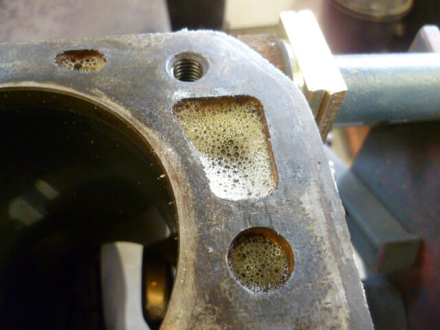

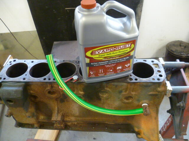

July 16, 20222 yr comment_642439 And about your block rust: I've got the nipple on the side turned slightly downward to facilitate draining after the evap-o-rust had time to work. And you can see the piece of wire fashioned into a hook to hold the hose up until I'm ready to drain. Don't shake the shop!! Filled to the brim: I didn't take any pics of the water pump hole cover at the front, but it's bolted to the block to cover that hole that leads to the front cover. Doesn't have to be fancy. Just something to keep the liquid from leaking out that hole. Link to comment https://www.classiczcars.com/forums/topic/67561-1983-280zx-turbo-engine/?&page=3#findComment-642439 Share on other sites More sharing options...
July 16, 20222 yr comment_642448 CO, how were the results using that in the block? Link to comment https://www.classiczcars.com/forums/topic/67561-1983-280zx-turbo-engine/?&page=3#findComment-642448 Share on other sites More sharing options...
July 16, 20222 yr comment_642451 It turned out "just OK", for a number of reasons... First of all, evap-o-rust works better at warmer temperatures and I was doing this at the end of December in a wood stove heated shop. Because of that, the temperature of the block was cold. Like Pennsylvania December night cold. I had the wood stove cranking and had the air temperature in the shop up to a comfortable working temp, but that big chunk of cast iron was still pretty cold. Second, I would have liked to have left the evap-o-rust in there longer. Like overnight. But I was afraid that once the stove burned down, it would lose all effectiveness, and/or even freeze. So I had to limit the process to just a couple warm-ish hours. Third, we did two blocks and the first one we treated with phosphoric acid after the evap-o-rust and it turned out well, but boy did it stink. So I couldn't bring myself to do that a second time in a closed December shop, so the second block (mine) didn't get the phospho treatment. Bottom line.... I give mine a "5". I think if it were warmer and I left the evap-o-rust in there longer (24 hours) and then also treated it with phospho after, it would be an "8". Still not as good a hot tanking, but for a block that's not that bad to start with, I think it would suffice. Link to comment https://www.classiczcars.com/forums/topic/67561-1983-280zx-turbo-engine/?&page=3#findComment-642451 Share on other sites More sharing options...
July 16, 20222 yr comment_642453 From a chemistry perspective you'd want the solution moving in the block to keep fresh chemicals on the surfaces. It might be effective to rig up a hose loop from the thermostat outlet to the pump inlet and spin the pump with a drill or even rig up an electric motor and a belt. That would keep any sediment suspended also as it breaks free. Of course, the head needs to be on and sealed. Link to comment https://www.classiczcars.com/forums/topic/67561-1983-280zx-turbo-engine/?&page=3#findComment-642453 Share on other sites More sharing options...
July 16, 20222 yr comment_642455 Or use a little harbor freight aquarium pump with tubes to either end of the block Link to comment https://www.classiczcars.com/forums/topic/67561-1983-280zx-turbo-engine/?&page=3#findComment-642455 Share on other sites More sharing options...
July 16, 20222 yr comment_642461 You could probably pull from the top of the open block with a pump like that. Link to comment https://www.classiczcars.com/forums/topic/67561-1983-280zx-turbo-engine/?&page=3#findComment-642461 Share on other sites More sharing options...
