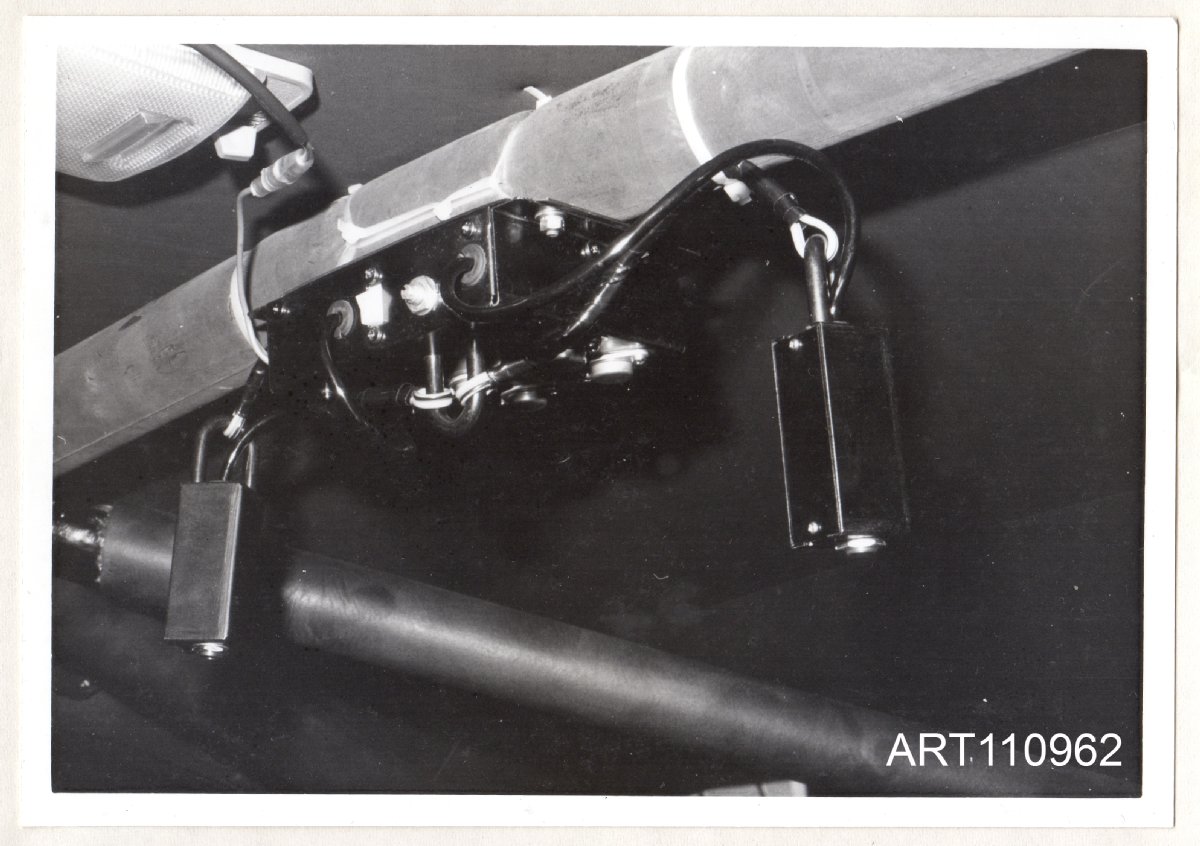

March 26, 20232 yr comment_651766 On 3/23/2023 at 1:20 AM, xs10shl said: I believe mine to be original hardware, as I have a detailed picture of it installed in the car from the 71 Monte Carlo (last picture below), and another from October 1971. It is a very compact 12V device, made by Teikoku Dempa Co. LTD, using 1/4" headphone jacks to a pair of mono headsets with microphones. Teikoku Dempa has been in business since the 1940s, making radios under the Clarion brand name. It's not clear to me whether this device was stock, a special order by the Works team, or potentially even a modified over-the-counter item. I've dug out some photos of 'TKS 33 SA 7924', an LHD car originally built as part of a batch for the 1972 RAC Rally (driven by Rauno Aaltonen and navigated by Paul Easter, running number 6, finishing 11th overall and 3rd in the Group 4 class) which went on to win the 1973 East African Safari Rally, driven by Shekhar Mehta and navigated by 'Lofty' Drews running number 1. It has a later evolution of the 'Teikoku Dempa' intercom with external headphone jack units (which would appear to give more freedom of movement and less stress on the jack plugs) but it still gives a Model No. of 'Y-4009' and with a Serial No. of '066'. Volume control appears to be conventional 'pot' type dial knob rather than the rotary (I don't know what to call it?!) dial on your Serial No. '014' unit. Interesting that there is a 52 unit difference between serial numbers for a roughly two year production gap. It was powered by a battery pack mounted behind the RH rollover bar mounting bracket, carrying two batteries (one connected, one spare) and press-on old battery radio style blue vinyl-covered connectors: Link to comment https://www.classiczcars.com/forums/topic/67572-1970-240z-works-rally-the-road-to-restoration/?&page=14#findComment-651766 Share on other sites More sharing options...
March 29, 20232 yr comment_651869 Hopefully not too much of a digression, but here's a photo of another iteration of the Teikoku Dempa/Clarion intercom/interphone box. This is an original period photo from a small hand-made booklet of data and advice put together by Nissan's Works competitions department at Oppama, and sent to the de-facto competitions department here in the UK in May 1974 (by then based at Nissan UK's Worthing HQ) with the intention of informing the UK competitions staff about details of the new P710 'Violet' Works rally cars which were - at that point - being shipped to them. The intercom/interphone unit is very similar to the one seen on '7924', which was built in mid 1972. It has the same volume control (interestingly, for a 'new' and supposedly unused car, the control knob appears to be missing as it is on '7924', which makes me wonder if they were prone to falling off, or just not fitted...?) and it also has the external 'floating' jack boxes, but with some extra belt-and-braces suspension for them. So, an indication that the Works team carried on with the same basic design well into 1974. I guess that Teikoku Dempa must have made a fair few of them? Link to comment https://www.classiczcars.com/forums/topic/67572-1970-240z-works-rally-the-road-to-restoration/?&page=14#findComment-651869 Share on other sites More sharing options...
March 29, 20232 yr Author comment_651889 Great info, @HS30-H. Entirely plausible these units contained the same internals, even if the exterior differed slightly. All the mods I can see make sense. Moving the power-transistors aids in cooling, and for assembly. Part of me wants to think that the possible market for the intercom was also small plane use, but the caveat is that most plane intercoms that I've seen use a 2-plug system - one for mic, and one for speakers. Just looking at the evolution of these models is interesting: The original systems had too much stress on the jacks, so they added extensions and jack boxes. Then the wires of the boxes got stressed from dangling, so they added cables as stress-relief for the wires - that all feels a bit like the evolution of a custom modification, rather than from Teikoku Dempa. It would be something to find this box in another application, which would answer some questions. Link to comment https://www.classiczcars.com/forums/topic/67572-1970-240z-works-rally-the-road-to-restoration/?&page=14#findComment-651889 Share on other sites More sharing options...
